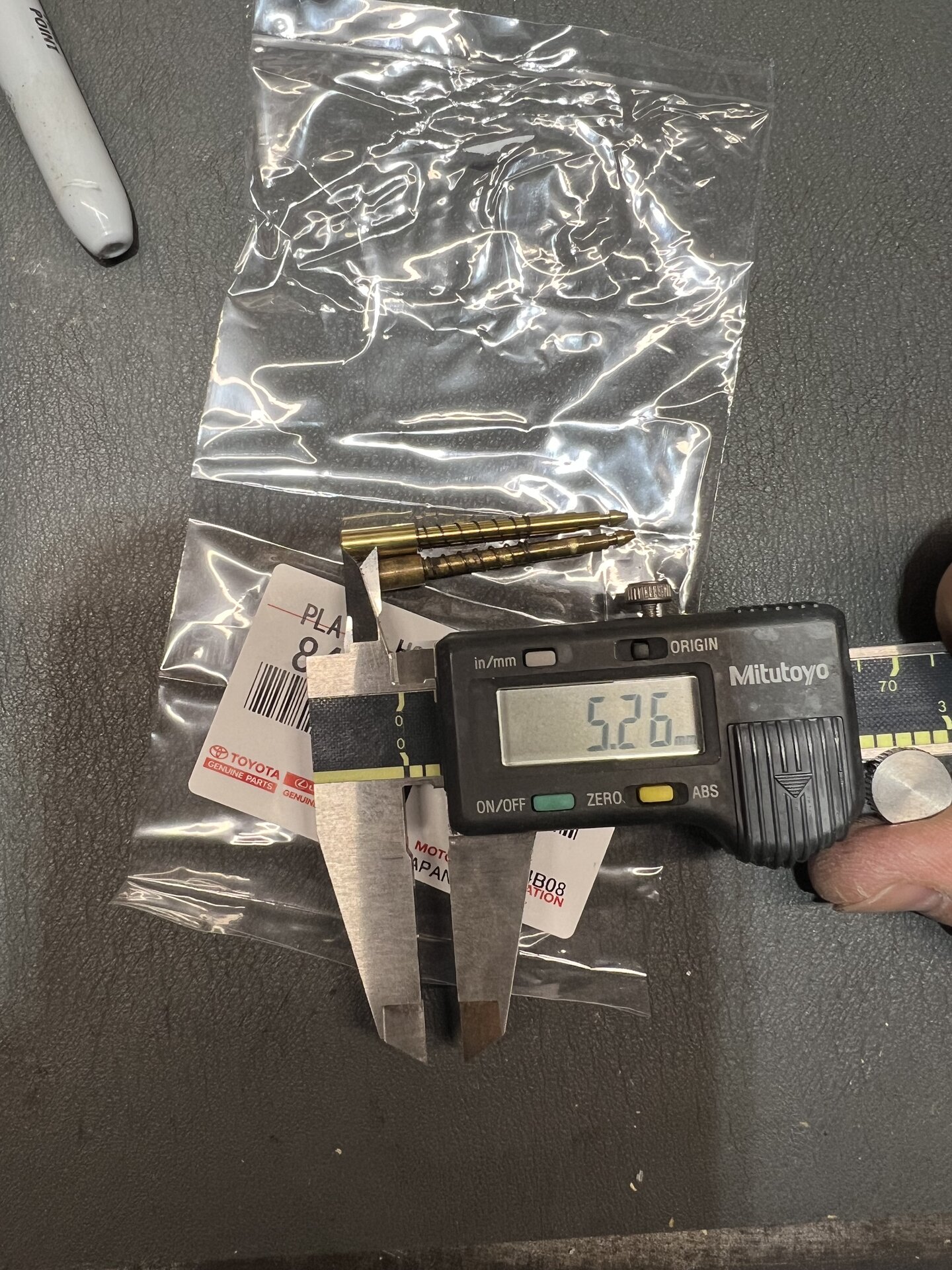

Nothing new here, same old sqeuaky steering wheel fixed by replacing the horn pin and spring. I just thought it was interesting comparing the length of old and new pins and springs. Assuming the new and old started life at the same dimensions, this is what 300k miles and 30 years does. Brass on brass wear under mild spring pressure...
