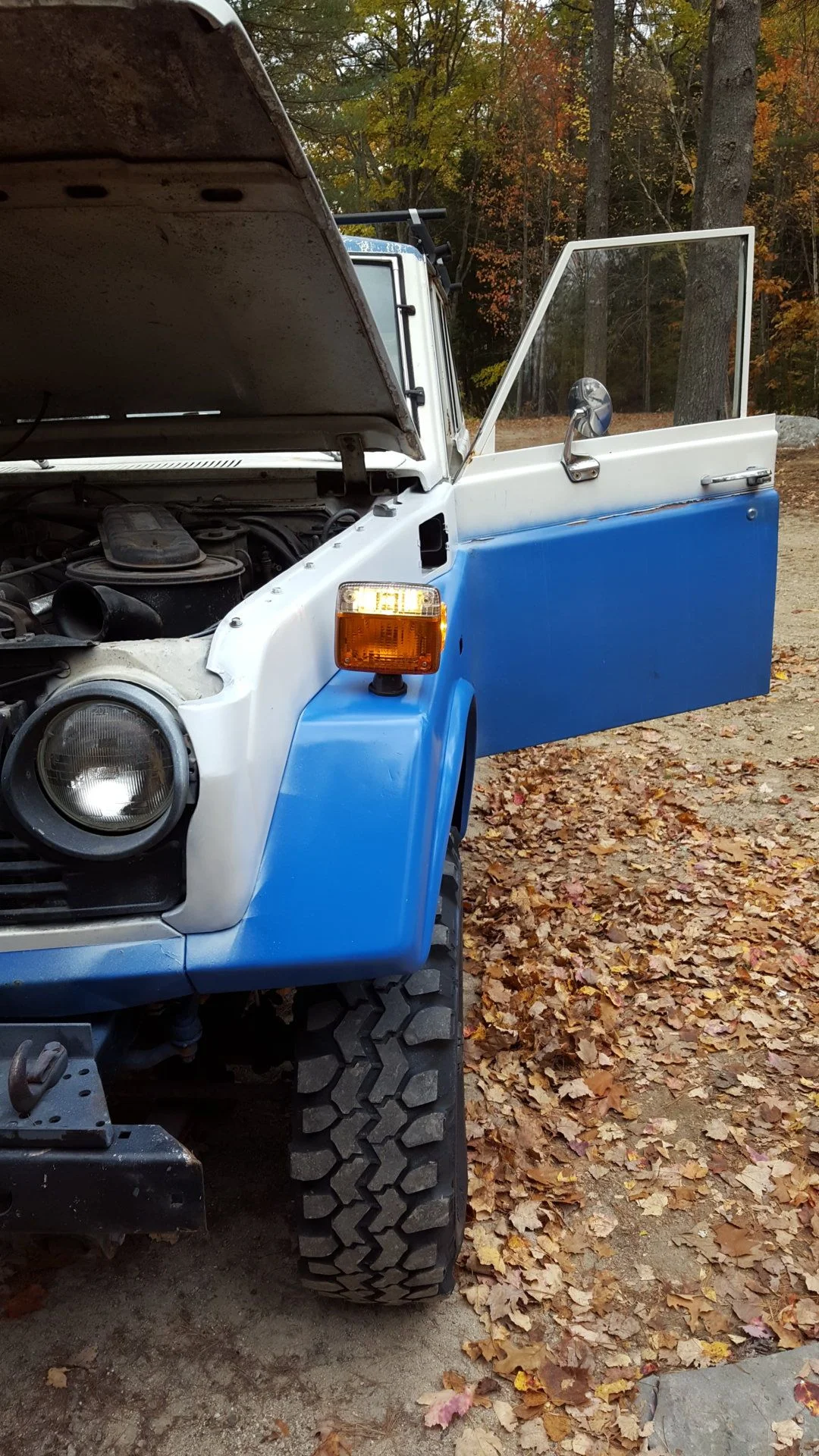

What do you mean Tub! Round 1 mounted toward front and side of engine?
Thanks for the photos. That's the air cleaner I meant. Bob, it looks like your vehicle has bulged hood correct. Liljohn, your hood must be flat on a 72 correct?
Vehicle I purchased has 2F motor, intake, and holley carb with headers. I do have a separate 1F manifold set and the round style air cleaner. I just don't know if 1) there was anything on that side of the 2F that is not on the 1F and would interfere and 2) if they would go under the flat hood.
