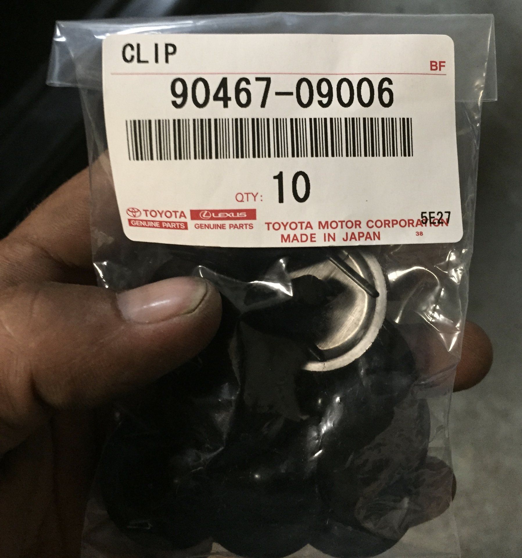

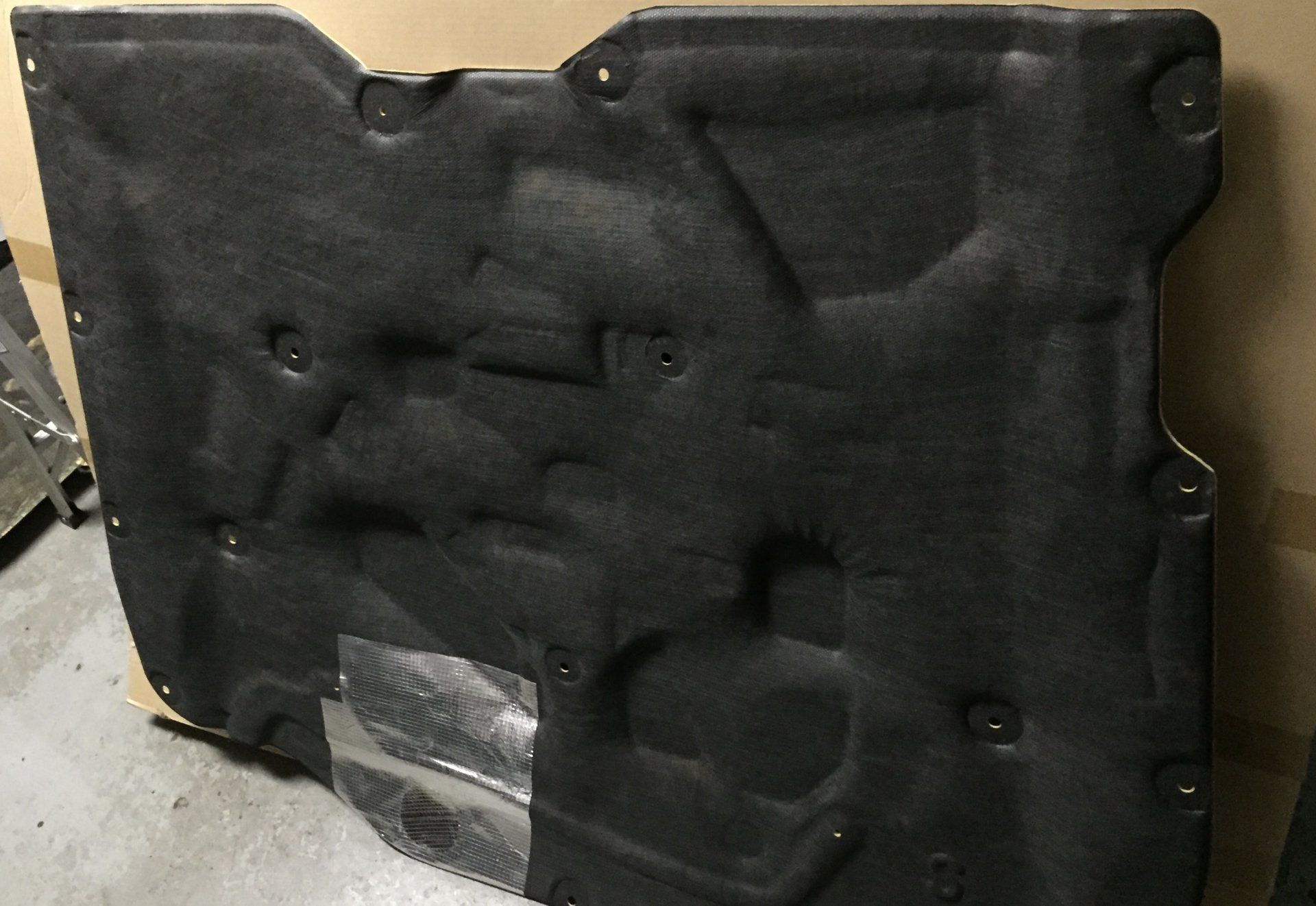

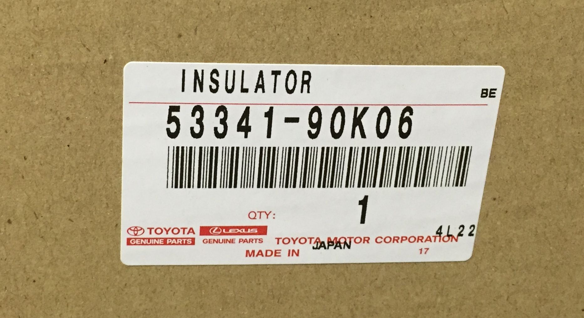

If you do end up going the direction of the hood liner, the OEM iteration is still available from Toyota: 53341-90K06. Get it locally. You need the clips as well: 90467-09006. You'll need a dozen or so.

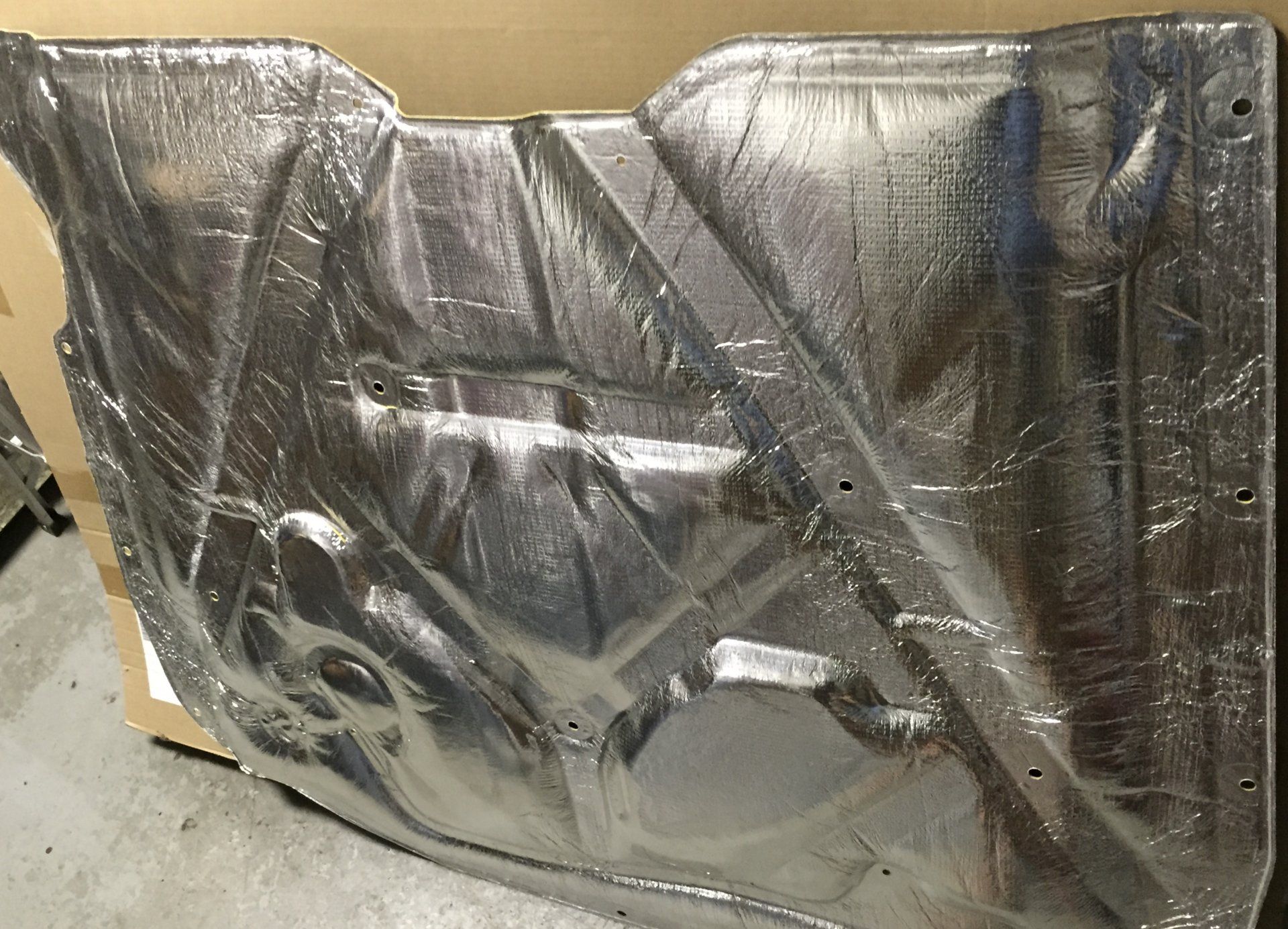

View attachment 1610495 View attachment 1610496 View attachment 1610497 View attachment 1610498

Actually it takes 22 clips to hold the lining/insulator in place. Two 10-piece packs and some more...

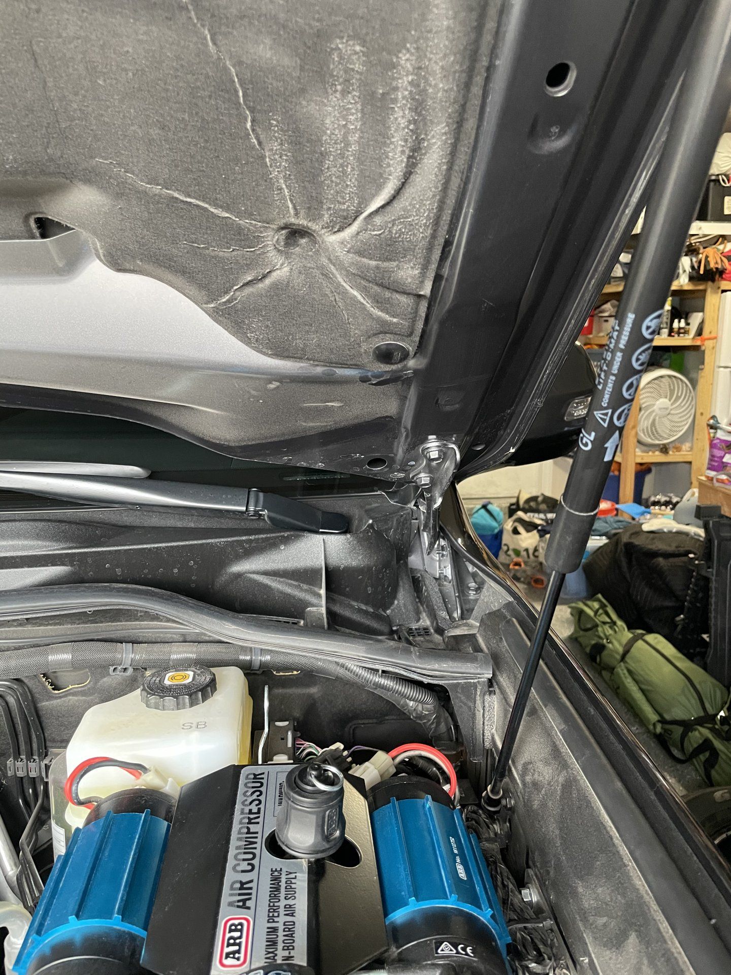

Any luck patching a hole (9-10” dia) in middle of the Insulation? 3M tape or something? The majority of the insulator is in okay shape.
Mine came with that sliver insulator tape in place but it came off after a few months. Not sure how easy these would be to patch with tape with the heat they put out under the hood.
I would recommend butyl adhesive tape.
(Also used to seal off roofs, rain gutters and stuff - builders market)
Sticks like hell, also when becoming warm.
