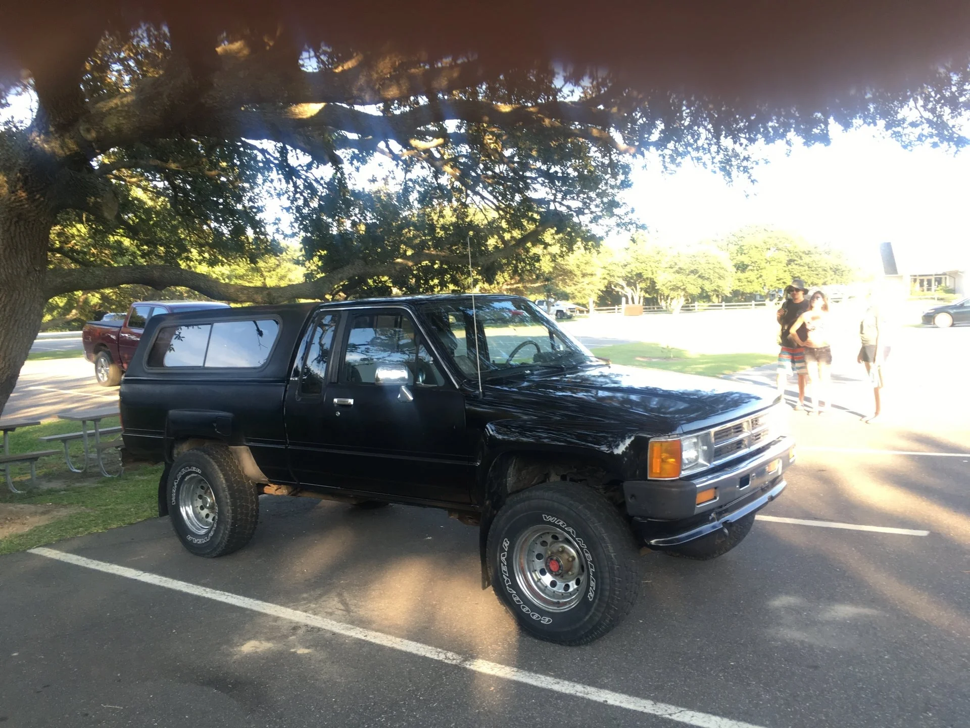

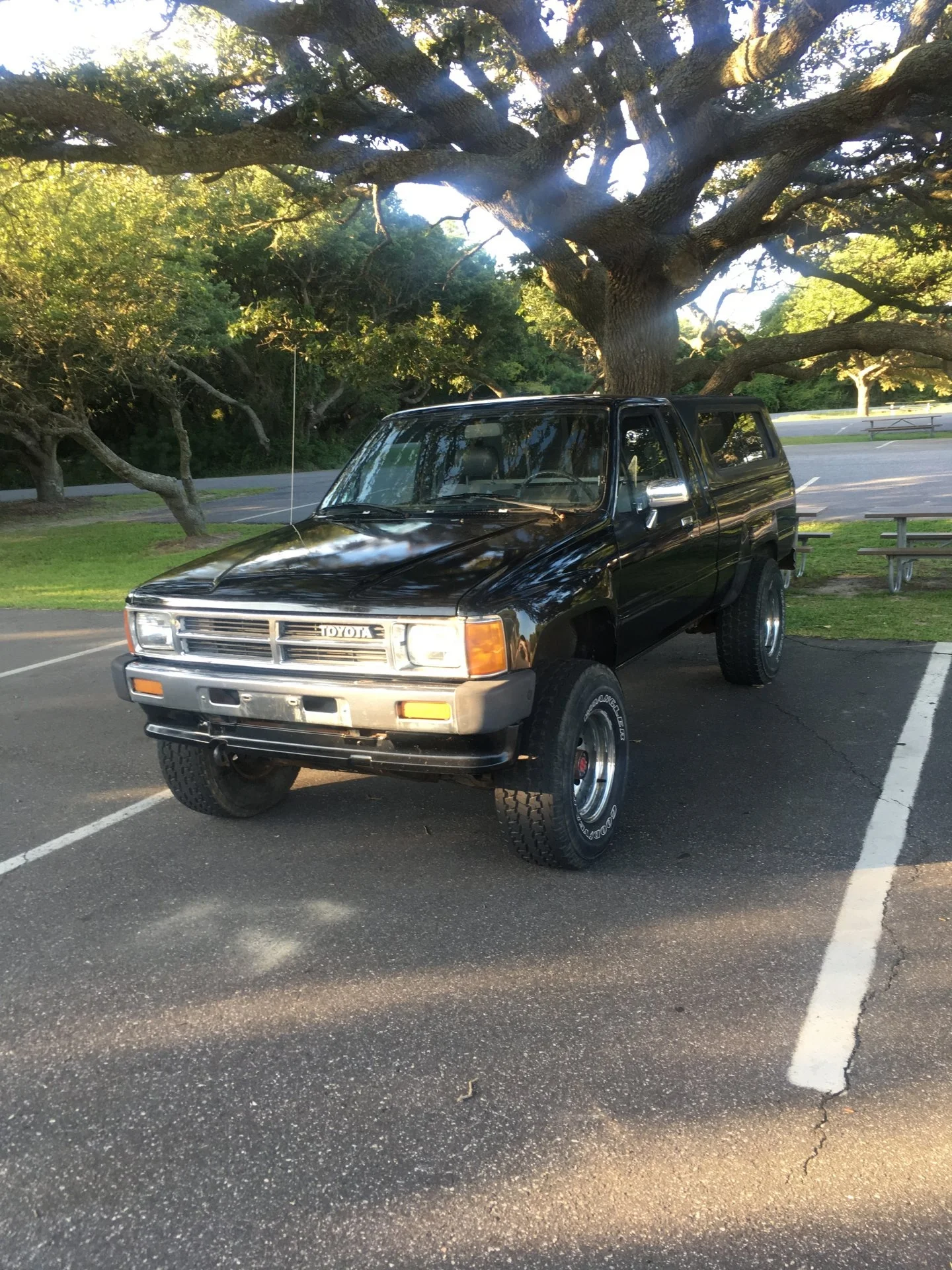

I’m sure this is on Mud somewhere I just can’t seem to find it. The hood of my pickup has separated completely from all the adhesive spots that adheres the structure to the hood sheet metal. Whats the process look like to reattach this?
