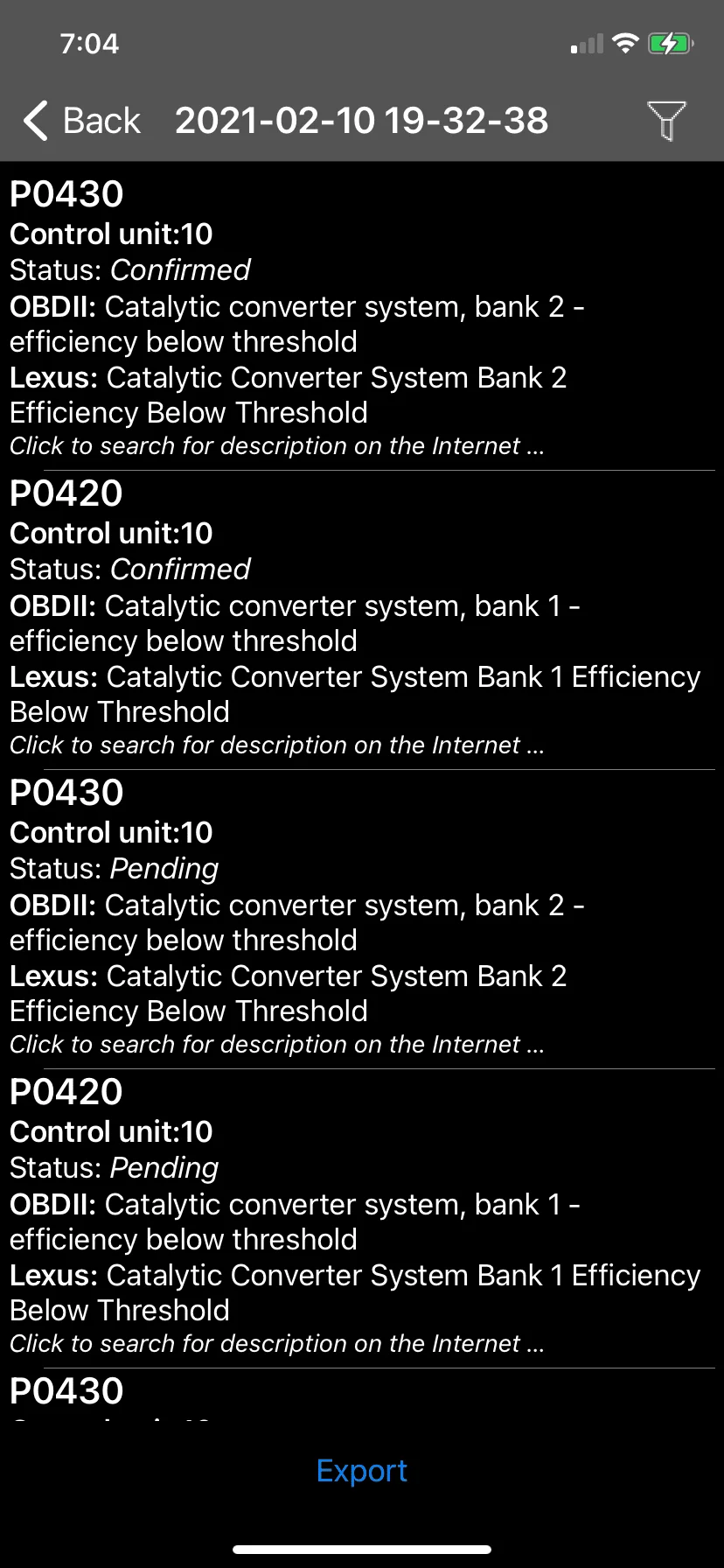

Cleared the codes and went to the gas station to fill up. P0420 and P0430 Codes came back when I pulled into my driveway after 6 mile ride. Arghhh.
The downstream Denso O2 sensors are 3 years old and 35k miles. I’m close to 164k miles.
Smog check due in April 2021 at a STAR facility nonetheless.
i don’t want to do the anti-foulers. I might have to cry when I order the cats.
0420 and 0430 are downsteam sensors. I know they're fairly young sensors but could be suspect or possibly the wiring junction back to the bigger harness. If you're feeling froggy enough you can unbolt the header leading to one of the cats and have a look inside to see what it looks like.
My Bluetooth ODB2 scanner doesn’t tell me which sensor. It just says P0420 Bank 1 and P0430 Bank 2.
Sensor 1 is upstream and sensor 2 is downstream.
I need to find a scanner that tells me which sensor to be sure, but replacing the sensors is a good idea for me if I’m going to go with new cats at some point. I’ll look into replacing the downstream sensors again.
I’m using two apps on my iPhone called Car Scanner and Auto Doctor. Neither says which sensor.

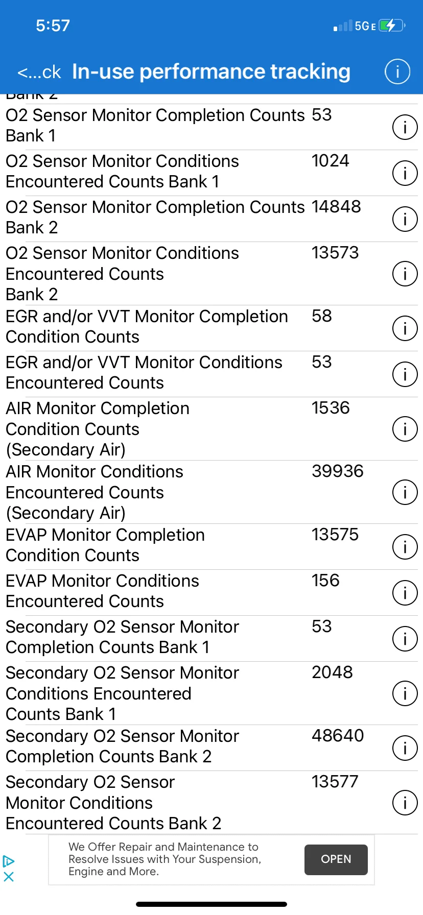

The Car Scanner app seems pretty good for being free. I might buy their app for $7 to upgrade to all the other premium features.

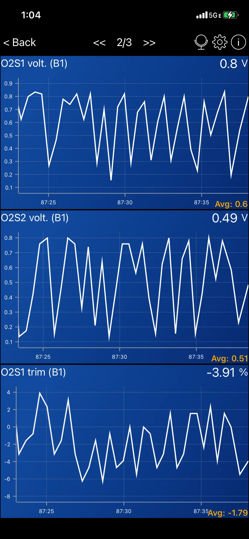

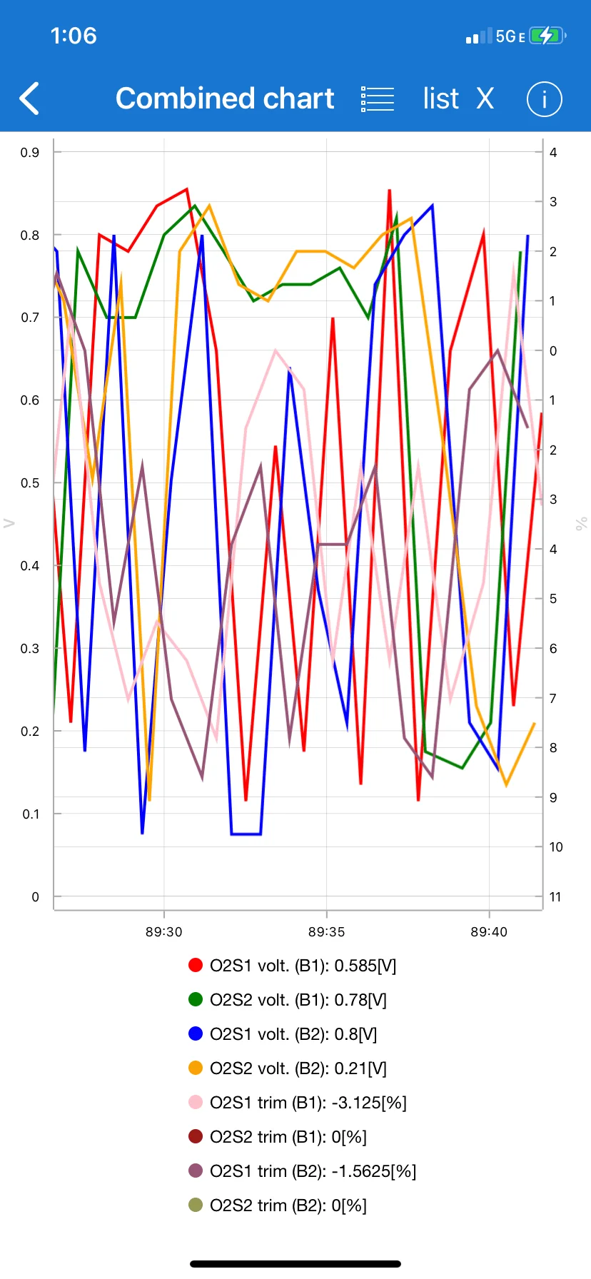

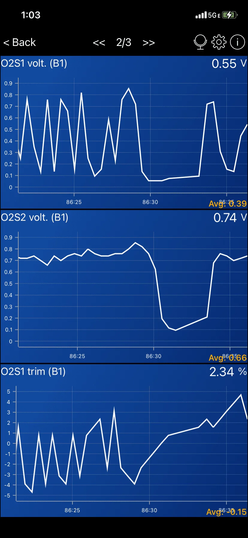

the app is reporting good voltages on all O2 sensors.
Problem is I don’t really know how to read the o2 sensor scanner readings.
You'll probably need to spend some time combing the internet to interpret the data. Here is a video on it:
It might also be better to export the data to a spreadsheet, then pull it into Excel and plot it that way. I spent a couple of hours yesterday doing that while trying to diagnose a MAF code (and ruled out a few things).
Thanks fir that video. I’ve watched it several times and I was able to graph the rear 02 sensors as the video describes.
it looks like one cat is worse than the other but both cats don’t seem to hold the o2 voltage. They move up and down too fast.

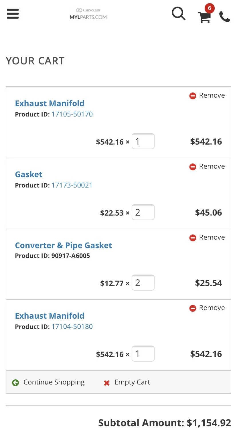

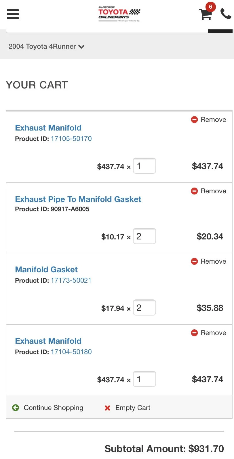

So, I ordered two new oem integrated cats.

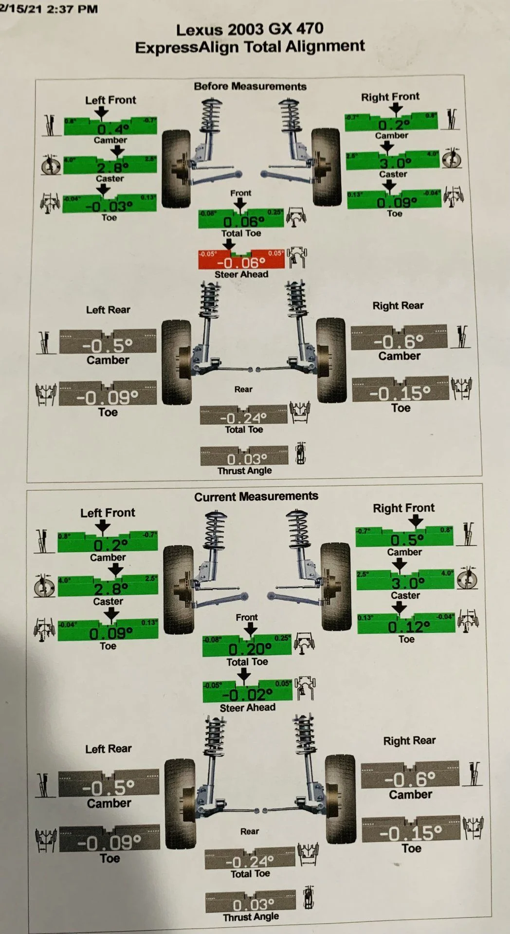

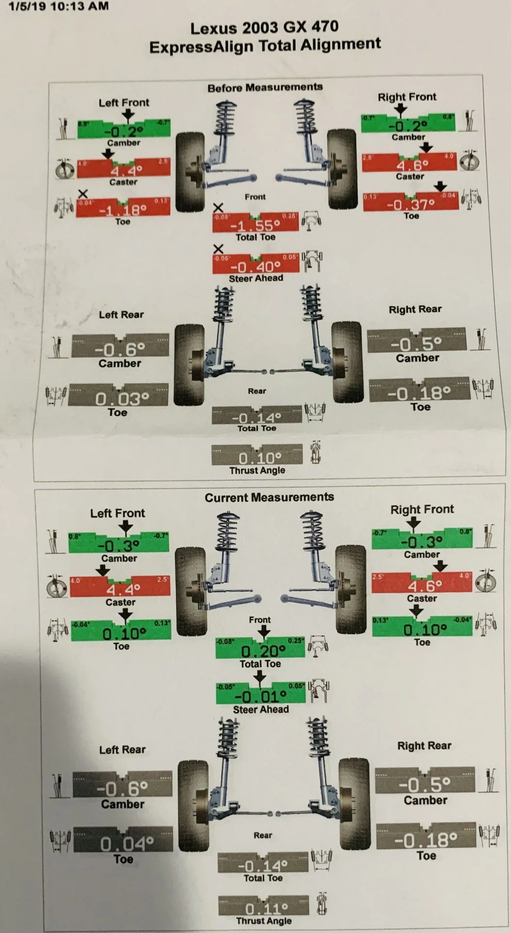

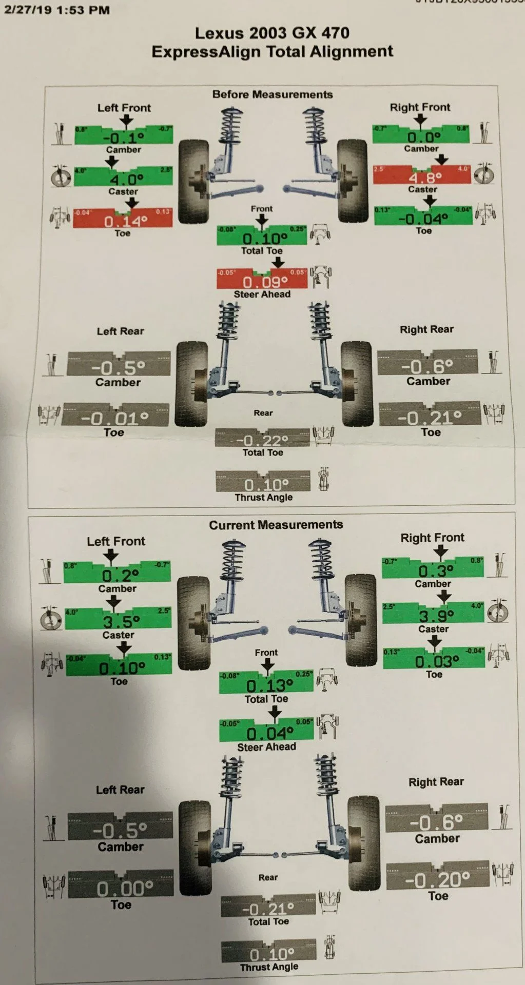

And here are my last 4 wheel alignments with the Nitto ridge grappler tires. American Discount Tires keeps straightening my caster.

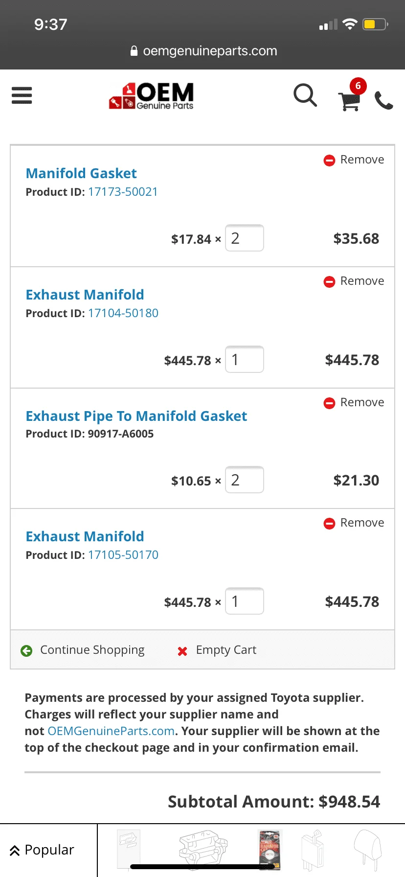

Gx470 is at my Indy mechanic getting new oem upper left and right cats. Got them at McGregor Toyota at a good price and no upfront taxes.
Also, got OEM manifold gaskets just to be sure there no leaks.

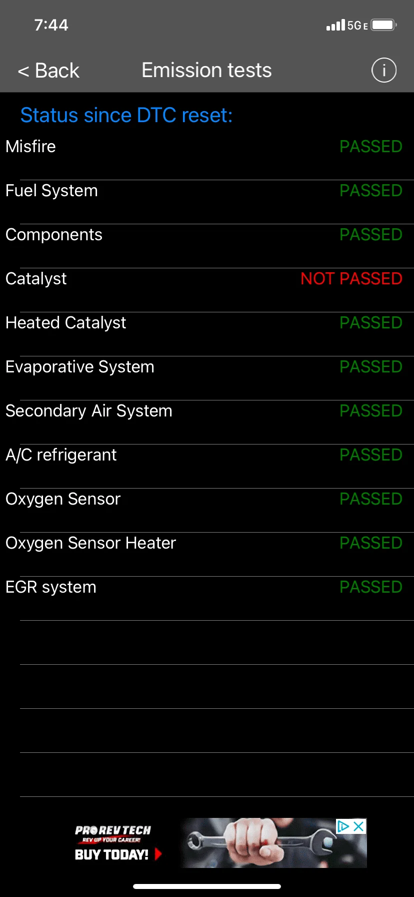

After 70 miles of driving, my emissions was ready and no more codes. I went to get smog check and everything passed California style.
So far, a hundred miles and no lights. It looks the cats were the root cause of my P0420 and P0430.
Total cost was $1200 including oem manifold gaskets, oem upper cats (left and right), and labor.
