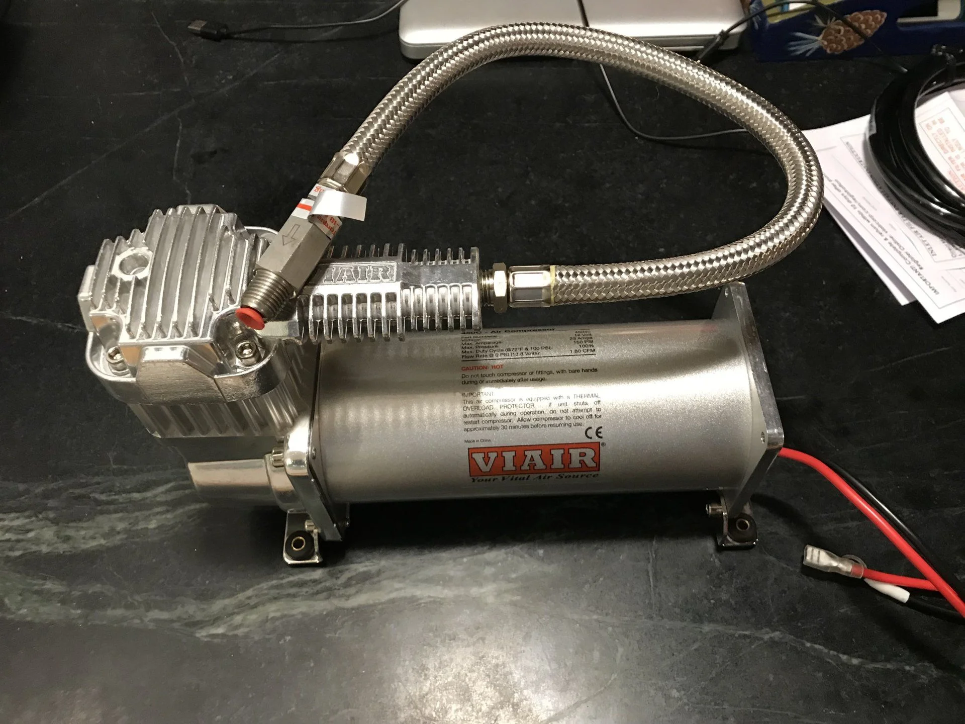

I really like my power box, but it's too heavy to just whip out and air up bicycle tires, wheelbarrow tire, and whatnot. It's like 70 lbs. I wanted something I could tote more easily. So I'm going to make another box that's smaller and lighter, more like what you'd buy at the box stores or HF. I started out with a really good Viair compressor. Its duty cycle is 100%.

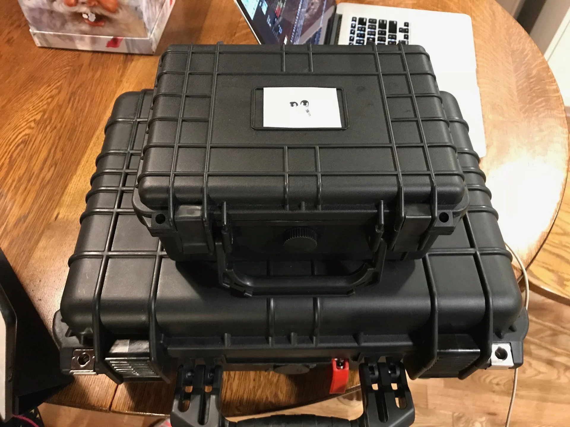

Then I discovered that Harbor Freight sells knock-off Pelican boxes that are significantly cheaper and seemingly just as good (it was just a matter of time). They call it an "Apache." Because of "rugged mobility." Are Native Americans known for water-tight plastic cases? Why not "Commanche?" Or "Navajo?" Why not "Bedouin Arab?" Just kidding. :)
Anyway, I won't feel as bad drilling into these cheaper cases for the various switches and hose outlets needed for this project. I've also decided to use a pair of lithium motorcycle batteries for weight-savings. Just ordered those. I'll start assembling and wiring things together when they get here. Never mind the gingerbread house in the background.

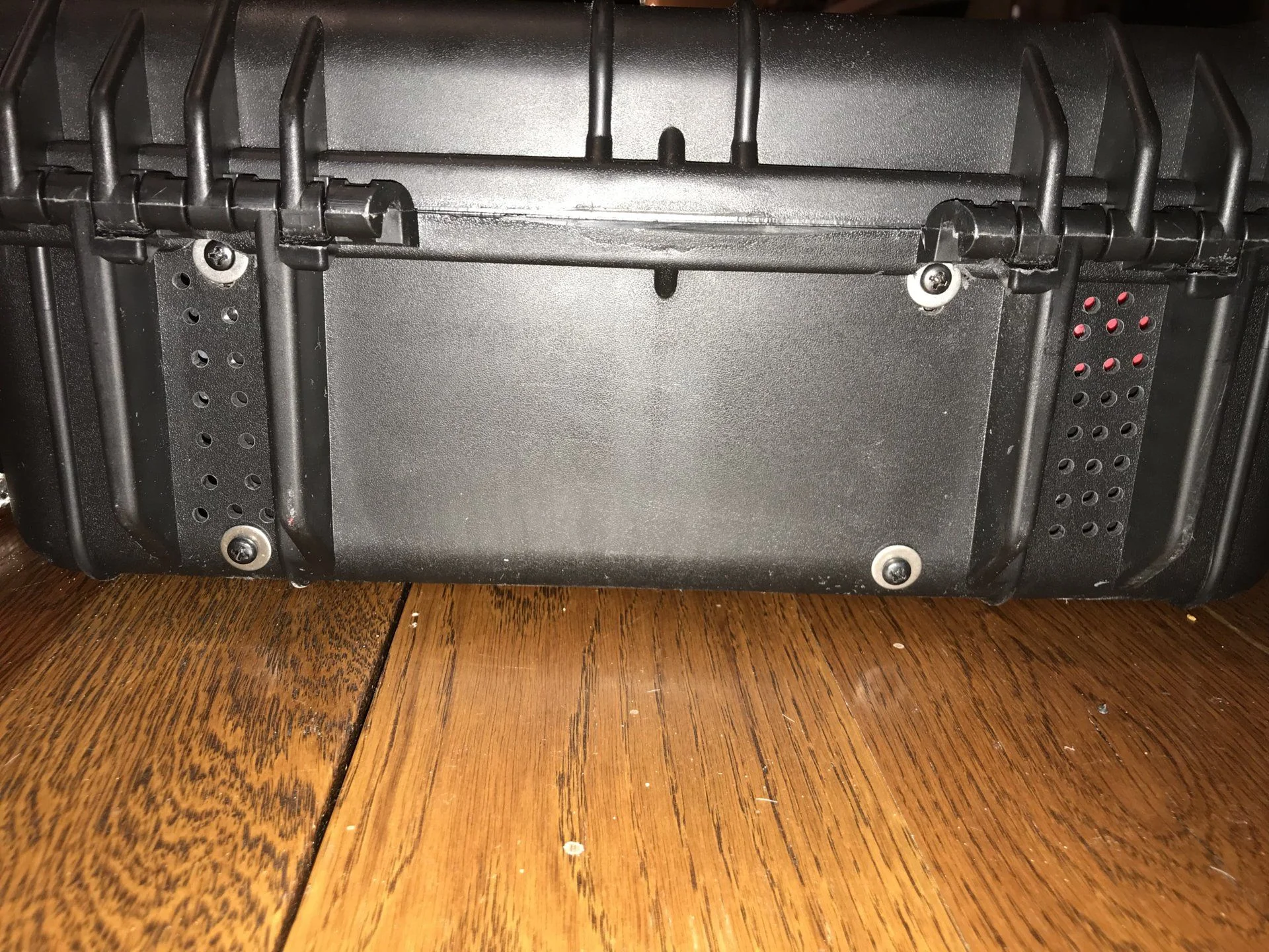

Maybe leave a little space between the compressor head and the plastic box.... the head will get pretty hot if you run it for any length of time at higher pressures. (AGAIN I'm worried about heat!)
Roger that. This Viair compressor doesn't have the built in cooling fan like the ARB Twinair does in my other box. If there's enough room, I might even install a computer fan like you suggested earlier. I don't mind hacking up a cheap Harbor Freight box for experimentation.

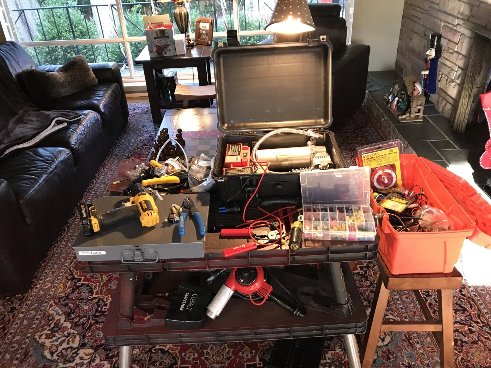

Getting serious about the assembly of the box, I set up shop in the living room. I get away with this, because my wife is the best.

Thanks! It's fun to do. When I bought this smaller box, I also had one of my kids with me at Harbor Freight, and we bought an even smaller case for toys and nick-nacks. Only $15. I'm looking at it now, it's about a quarter the volume of this latest box, like half a loaf of bread, and I'm thinking I can squeeze in a single Li-ion motorcycle battery and a small compressor in it, and the same strip lights on the outside. This is becoming an obsession...

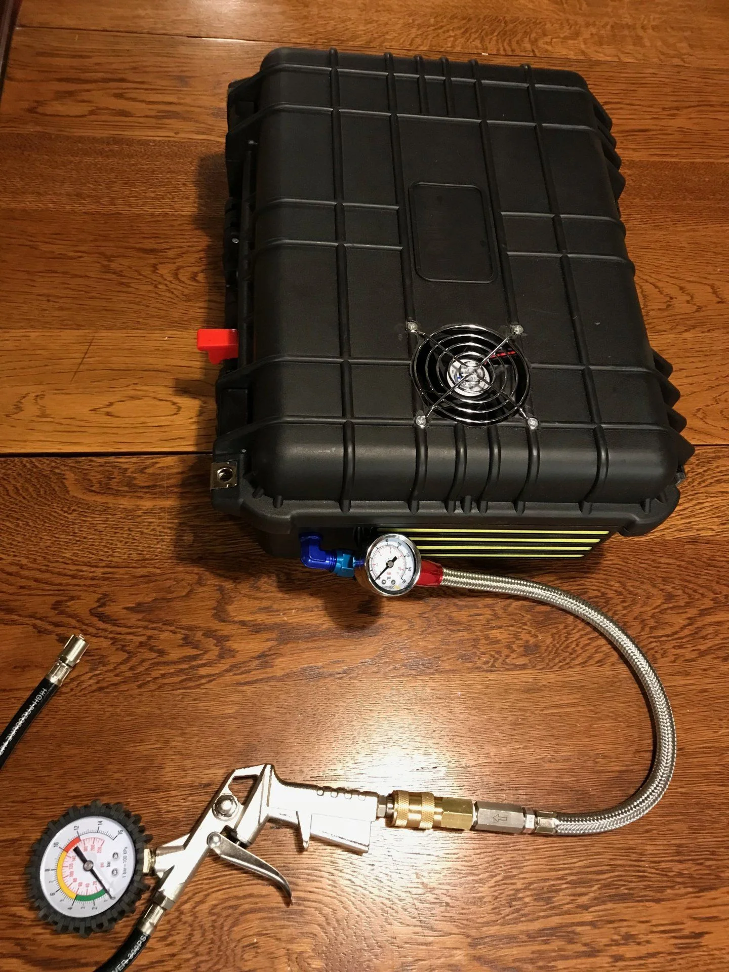

Okay, James, since you mentioned it, I've been calling this project the nuclear football, so that's its official name. It's pretty much done. Used AN fittings for the air lines, added a pressure switch, air pressure gauge, and a cooling fan.
"cooling fan".... :)
