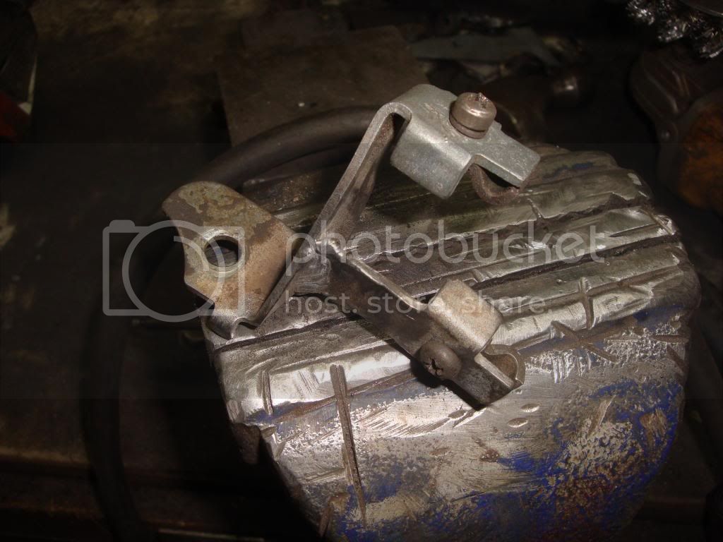

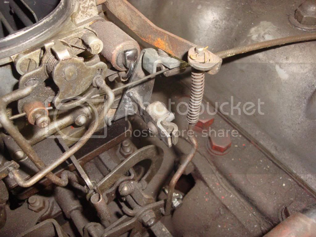

Well I finally got around to jiggering up my cable contraption. Heres what I came up with.
Carb end. Welded a piece of an extra choke cable bracket to my choke bracket.

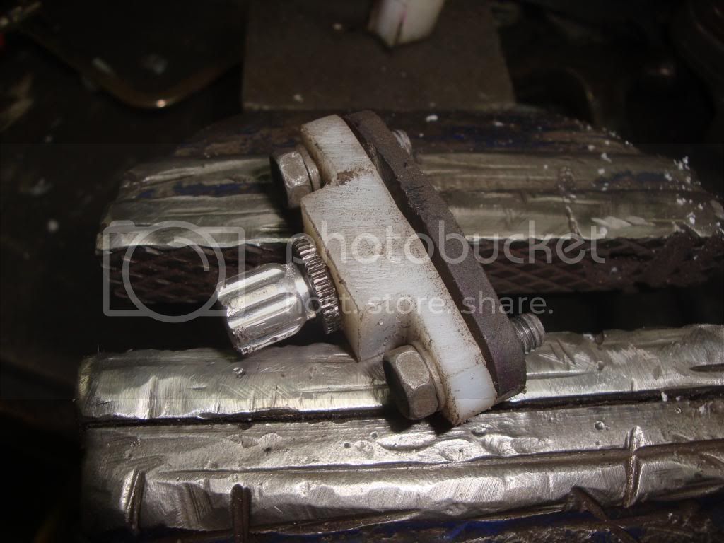

Fire wall end. Stock plastic bracket was broken so I used it and a piece of uhmw with a barrel adjuster threaded in.
Seems to work pretty mint....

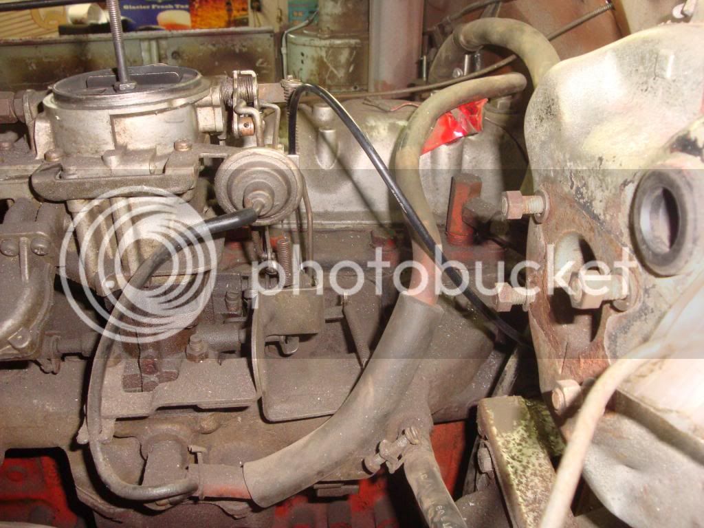

better shot of the piece that the trollhole conversion uses to hook to carb
Thanks Sarge... Always good to hear about options. :D
Oh , forgot to add - firewall end of that Suzuki cable is a snap-in type , so some type of filler plate will need to be made . There are a couple of older Toyota cables that are similar to the Suzuki but can't remember the actual application , maybe first gen mini-trucks ? I got all this from years of adapting Weber carbs to different vehicles . Worst one to deal with is the Cruiser and it's crazy tight firewall clearance .
