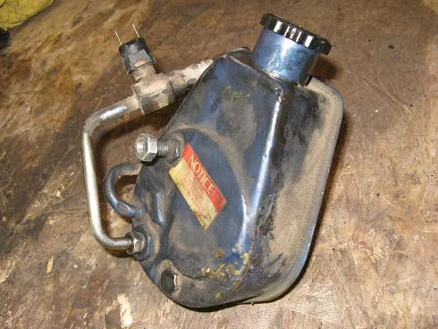

Well, I finally got tired of the leaky, noisy Toyota PS pump. I've put two Napa pumps in and both lasted less than six months, killing two air pumps in the process. I really wanted to fit a Saginaw pump in my rig but I also needed to keep my air pump since my county requires me to pass emissions. So, I took the plunge and spent a day making this work. Fortunately I have a brother who works as a machinist at a hydraulic shop!
Here's the donor pump, pulled from a Jeep Cherokee in a wrecking yard for $30.

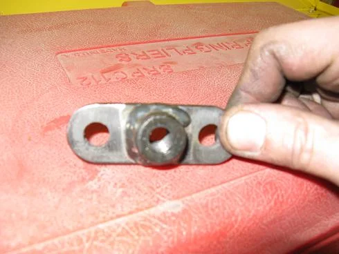

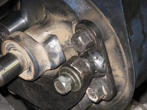

We wanted to use the OEM bracket if we could but obviously the holes wouldn't line up. The first thing we did was create an adapter bracket to try to bridge two of the mounting holes on the pump to one of the holes on the Toyota bracket. We came up with this. The hole in the middle is threaded.

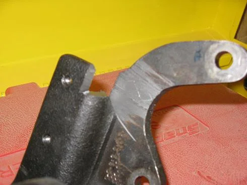

As we were mounting the pump we noticed that we had to take a notch out of the Toyota bracket to allow clearance for the Sagniaw.
continued....
Here's the pump with our adapter attached to the OEM bracket:

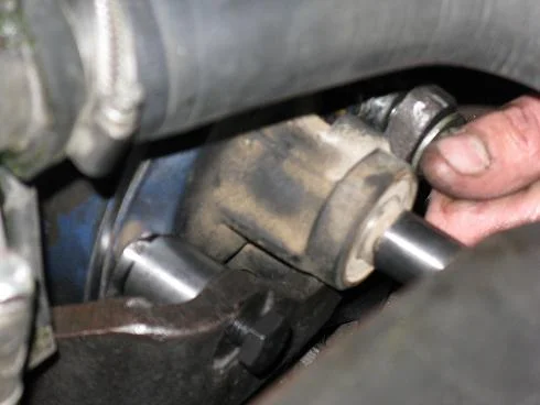

With this adapter the second holes lined up, we just had to add a 1 inch spacer.

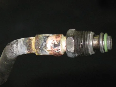

The pressures lines were .020" off from each other so we had to cut and do some silver soldering.
(Not too much later I just had a new pressure line made, the old one was cracked and leaky)

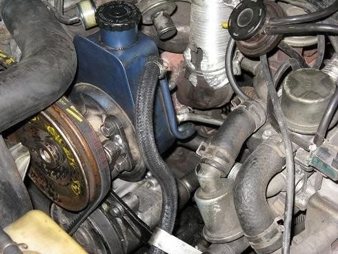

Installed!
Added a new return hose:
All buttoned up:
And, I was able to keep the air pump:

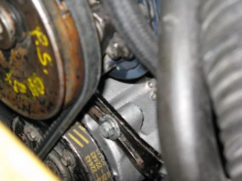

The forward most belt is a Gates TR22495 that runs from the crank, over the water pump and to the alternator. All critical items run from this one belt and if I carried only one spare belt, it would be this one.
The rear belt is a Gates 25-9540 (13mm x 1380mm). This belt runs from the crank, over the water pump and to the Saginaw pump.
I found the belt size I needed by making an adjustable fan belt by cutting an old fan belt and attaching a sectioned hose clamp to it with screws.
I put the pump in the orientation that I wanted it, tightened it down, installed the adjustable belt, tightened the hose clamp until the belt was tight, marked its tightened position on the hose clamp and then took the belt down to NAPA and told them that I wanted a belt that matched my adjustable one.
