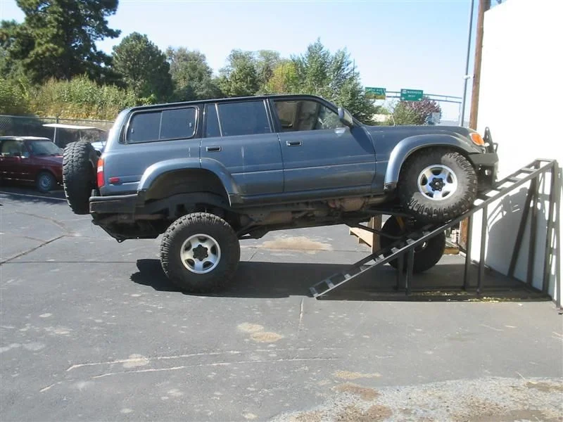

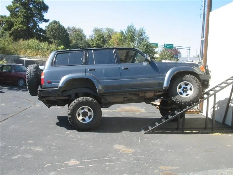

Pic #3 1st flex pic, 30 degree ramp, standard 80 setup, 14" rear shocks, the front tire was 29" off the ground at the bottom/center

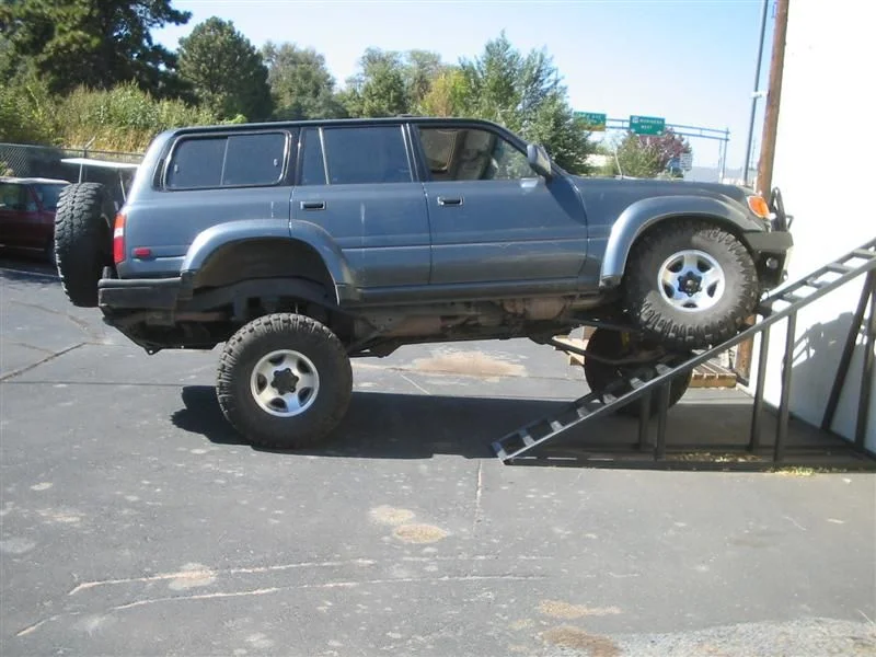

Pic#1 Same setup except for the "hitch pin pulled", tire was 33" above ground

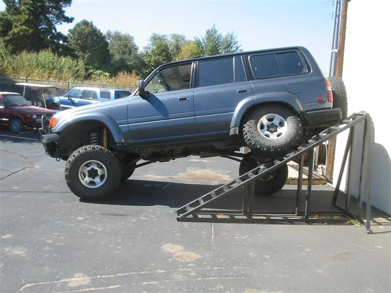

Pic#2 Same setup except for hitch pin pulled, and front shock disconnected to simulate better spaced travel/extensions up front tire 37" above ground.

You can tell there are some pretty serious gains from my last RTI thread outing, I will be adding this to that RTI thread as well. With the front in the standard setup (L shocks/pin in) she was leaning pretty good as you could tell the rear was doing all the work, with the front shocks in a better travel range/pin pulled it wasn't leaning *that* bad for how high she went up.
Definintely beyond satified with the flex, bilsteins are on order, next to get the front shocks replaced/spaced correctly.

You didn't really gain a heck of a lot more flex by pulling the front radius arm bolt, did you? I expected more of a gain.
yeah I know...sliders, in process!!! :grinpimp:
actually, it's somewhat decieving. By pulling that front bolt I only gained 4" over stock because I maxed out my front shock. I don't have enough droop with that shock and too much compression available. I need ~3" more of droop which is what I'm tacking next. So when I pulled the top shock nut to loosen that shock, she flexed another 4" with that pin out.
So if I had a long enough shock to start with, pulling that pin would have netted me 8 more inches of flex...;) which is a pretty good amount.

It was around 25~26" with that hitch pin in, L shocks all the way around and no swaybars. There is just too much bind up front to max that L shock out with the pin in.
So from the base start of stock 4" lift setup with L's, no sway bars, I have gained 11" ~12" of flex/height of tire by EXTREMLY cheap mods. Throw the sway bars on and you'll prolly be around 23~24" range....

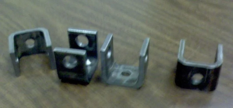

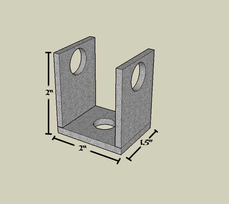

Well, I went ahead and made some for the front. Here are the front mount/conversions...They have these adapters for sale from various places for about $35~$45 a pair...So for the front you'd be in close to $100. Being that I'm a CB, I decided to try my own for the front and upcoming bilsteins.
I used a scrap chunk of 2" X 3" X 1/4" square tubing, because thats what i had Cut it down to the measurement in the picture. 2" X 1.5" X 2" Popped the hole in the bottom for mounting, and holes through the side to mount the shock in.
Now the problem I *may* have is the ID might be a bit to large for the shock bushing. Worst case, I'll have to shim with washers, kinda :hillbilly: but for the moment they will work. I'll get them installed tonight and see how they all fit. but for now, the pics...pic is crappy cameraphone...
