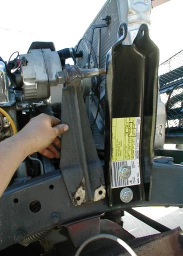

you get this for $20!! yep, i'm doing it again.
Yep, I would do it again. Only con is cutting the inside of the fender splash gaurd to make them fit. Pro, they bolt up to stock holes in the frame ;p
part number is E5TZ-18183-A I got a quote today of 13.50 each.

The install with bolts only and no added way to mount the Ford tower over the top of the frame looks weak to me. Has anyone broke theirs? Seems like the side loads would make short work of a two bolt one plane mounting. Or does the shock rubber have the ability to flex enough to keep things from coming loose?

I am running two grade 8 bolts 1/2 inch shank. They will rip through the mount before the bolt will ever fail. Neither has happened so far.
I did the same as treeroot 2 1/2 grade 8 bolts. I used 3.5"long and went through the frame to add strength. I then also used large grade 8 washers on both sides. They are solid I don't see them going anywhere.
The truck they were off of is an 88 F250 - if a 3/4ton truck used two bolts I am sure you are ok in the cruiser.
