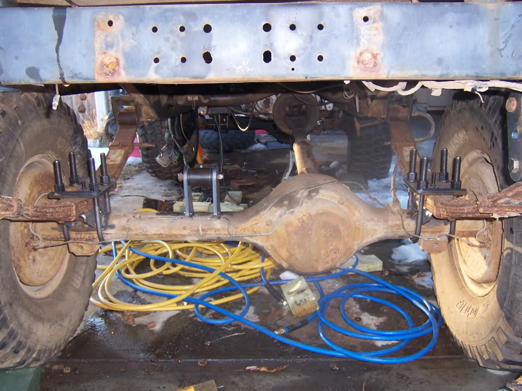

I got the rear almost mocked up. The Toyota mounts are pain to remove. I think that I will end up with 8 inches of lift. I found some rusted out frame in the rear and had to box the ends and make some new plates for the shackle hanger in the rear. I should get away with using the stock rear driveshaft the front will need to be longer now.

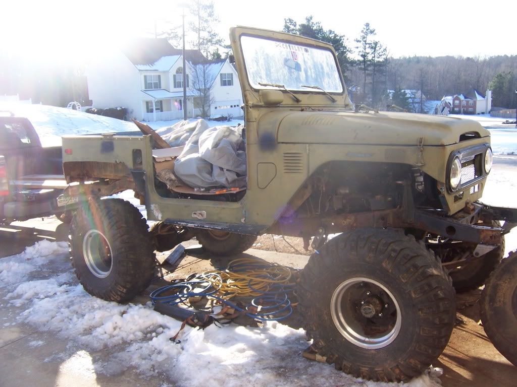

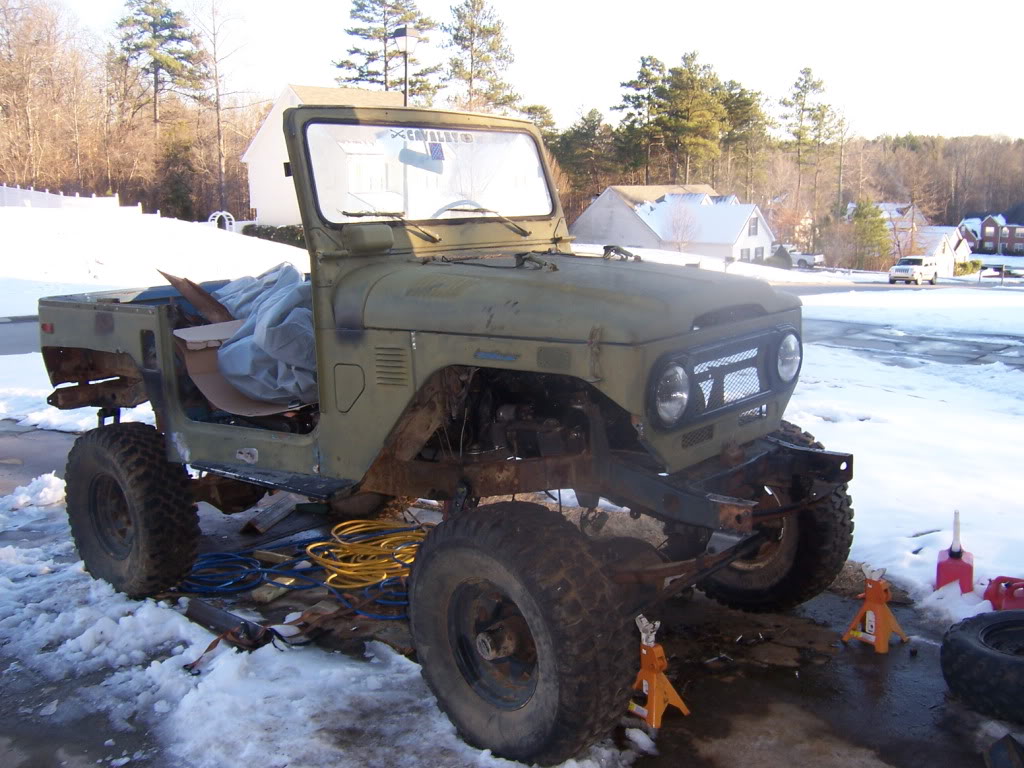

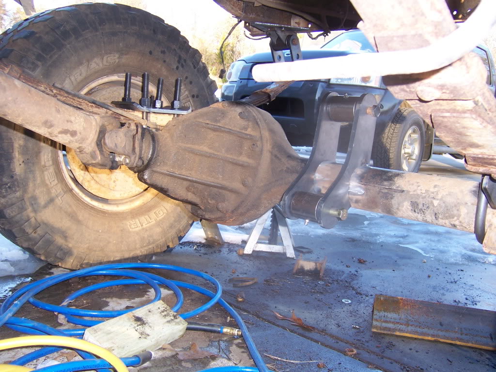

I tough I would post up some pictures of the SOA. I did not get to put the 37 tires on so these are with the 33 tires. I will post up pictures with the 37s later. I will be moving the fj on sunday so any cruisers would like to help or come by and pay dues for the club:) call me 404 five one two 2989. I got 8 inches of lift and some good flex.

The front
The Back
the start of the anti-wrap setup.
