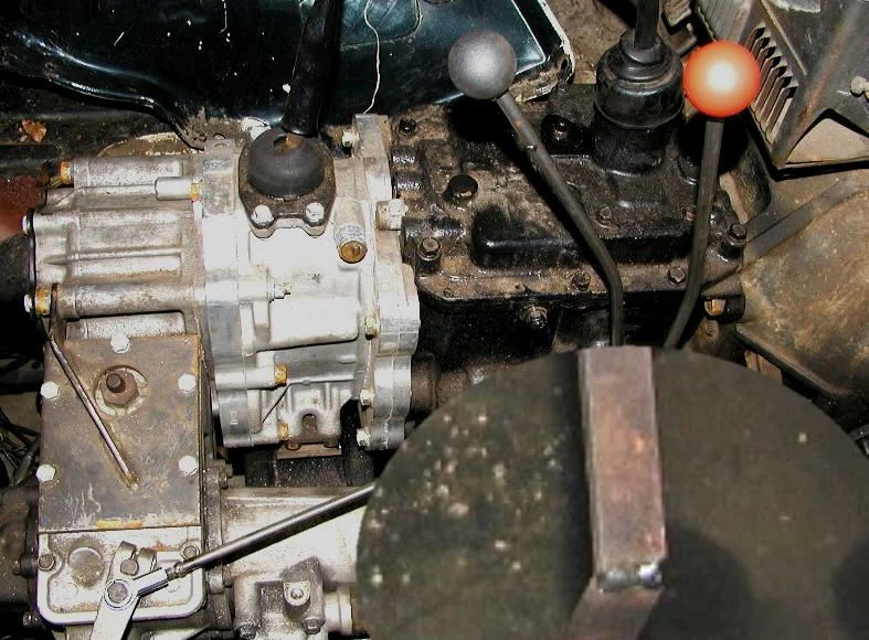

I bought the 5/16 rod ends and threaded rod for the linkage, but im using 5/8 round stock for the levers, i thought his levers looked a little thin.

I have a bit of concern about one of your components however and some thoughts. In the picture below I have highlighted an area that looks like it needs a bit more support. The welds are fine and pretty enough for an area that won't be seen, but it looks like a weak spot to me. I think you would be wise to fabricate a gusset for the backside of that strapping that spans the two pieces. You could also bend a piece of your left over round stock and weld it across that welded area. Does that make sense?
Of course your remaining option is to tell me to go fry ice. Cheers
