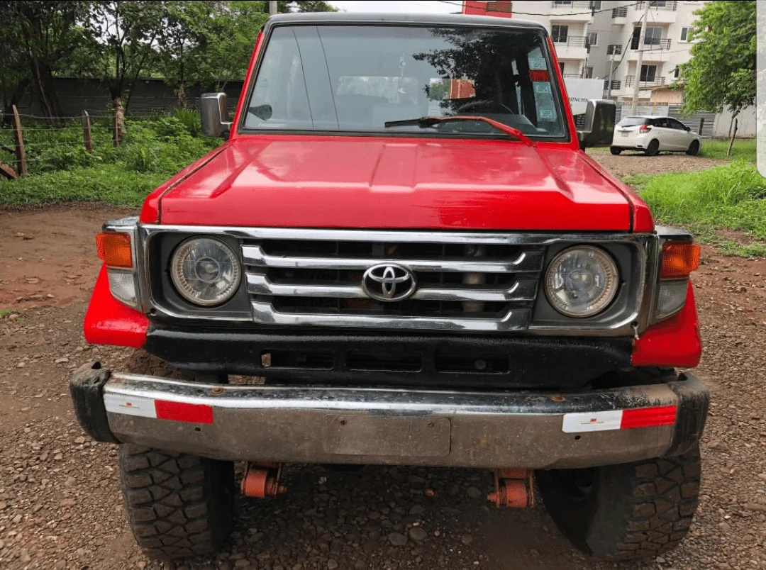

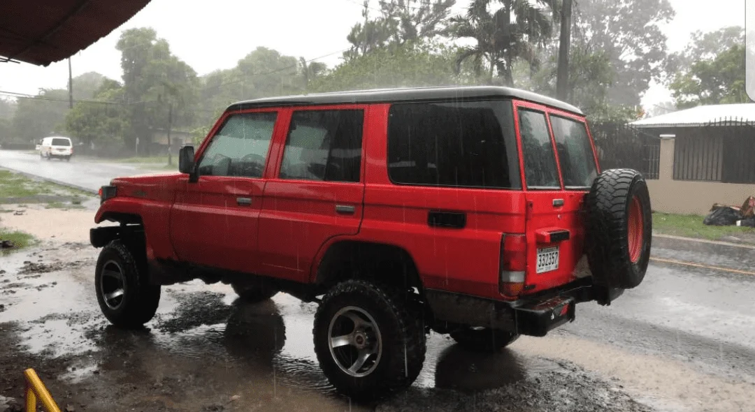

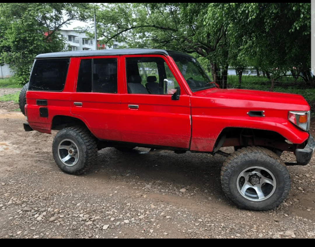

Hi, everyone i want to get my first land cruiser. So a guy is selling a hj75 (at least i think its that one) for 6500 the car is from '92 has a 2h engine and some other mods. Has 200k km. Dont knoe anything else about the car but am planning to see it today. What are you opinions and suggestions. Please help im kind of a noob here. Forgot to mention A/c works
It looks like a 77 series, maybe a HZJ77 if its diesel, which would mean it has a 1HZ diesel, not a 2H.(unless its had a retro engine swap)
The roof is probably the original colour. The body looks like it has a had a few patch ups, especially the front RH fender.
Have a close look around the windscreen, looks like a patch up on the left hand bottom , they often rust there.
It has a few parts which don't correspond with the year. Like the grill and those tail lights dont normally come with that bumper, but that could be market specific.
The front RH spring pack looks likes its over to one side.
Spring pack looks like it has had a leaf or 2 removed.
Missing a windscreen wiper arm.
Exhaust pipe looks a bit smaller diameter than normal
I would ask to see a cold start, meaning the engine has not been started at all over night. It should start almost immediately with only a flash of grey exhaust smoke.
The gearbox should be a little stiff when cold and loosen up and shift smoothly after a few shifts.
I get the impression its had a hard life, so I would spend a fair bit of time looking at it and asking questions. $6500 is not over the top, but it will almost certainly come with a few hefty repair bills.
Get some engine pics and pics of the aluminum plate on the firewall and then we can decode the info.
Well, you sure know what your talking about... well i cant afford some hefty repairs so im kinda questioning it now hopefuly i can get some more info today check ot out in person and respond back with some pic's that's btw forgot to ask what is the aluminun plate? Sorryif i don't know :/

Whatever the case, the truck looks battered. It appears to have had a snorkel sometime. Shackles and leaf springs look tampered. The front bumper is from a Light Duty 70 Series. The front clip looks misaligned with the rest of the body.
I knew there was something odd about the way it was bent at the edges

Either someone somehow matched an LJ78 body into an HJ/HZJ75,
Thats not bad idea, it would be the only way I could get a HZJ77:hmm:
It is an LJ77 with a 1HZ swapped in it and a 70-series front clip and it looks like converted to leaves in front as well.
I posted about it a year ago. A friend of mine down there checked it out for me a few months after I posted about it, it is a real pile.
