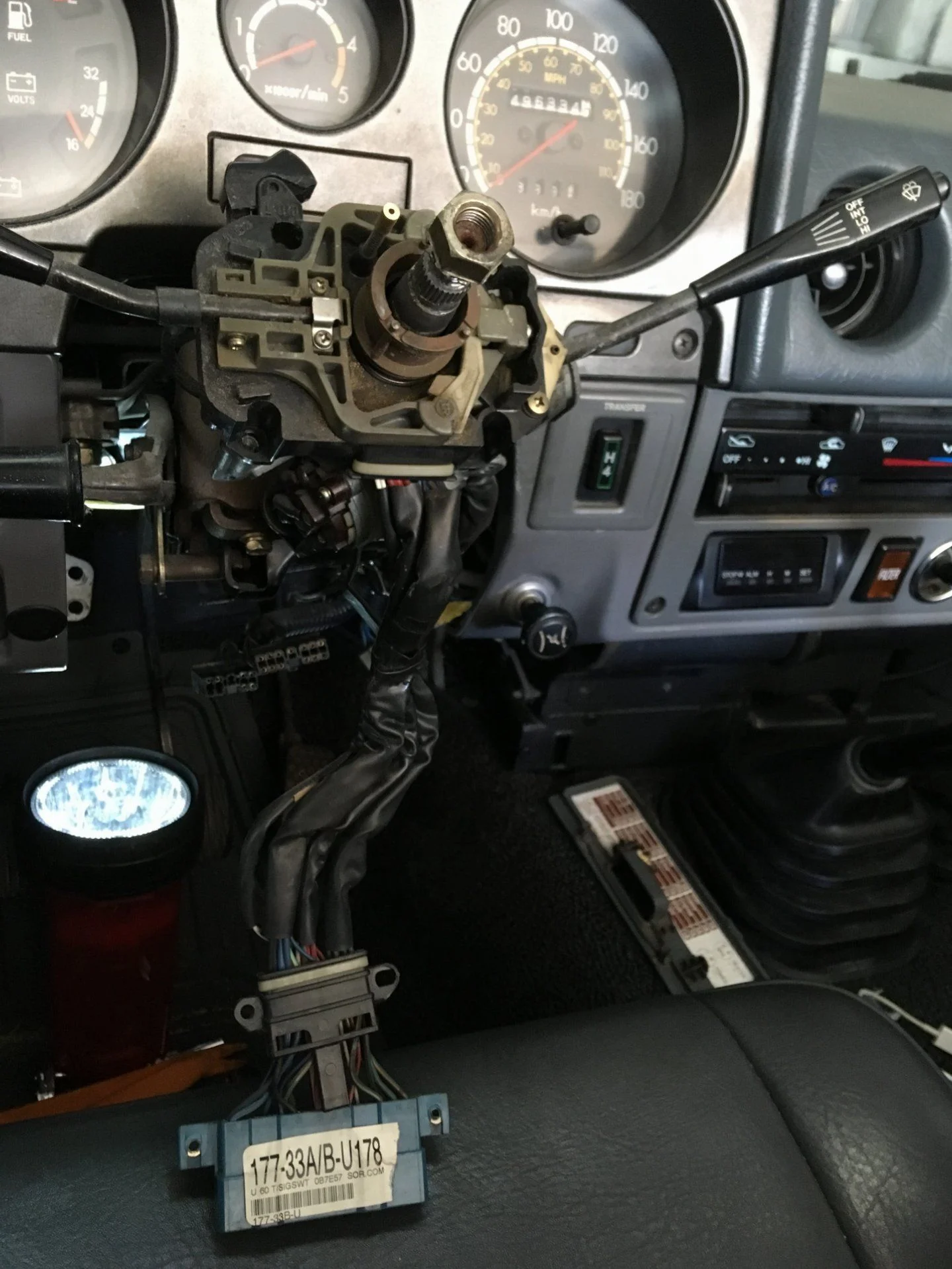

Hope you don’t mind me crashing your clubhouse section, but I really need some help finding a 24v steering column switch assembly (wipers/light switch) for my Nov ‘85 Canadian HJ60. I figured you guys would have the best idea of who might have one that they wouldn’t mind parting with. I need it to get back full functionality of my front windshield wipers. Anyways, if you guys know of one somewhere please let me know. Thanks!
In case I’m calling it the wrong part name (very likely) this is what I am looking for and is currently in my HJ60:
I believe it is a SOR replacement for a 12v FJ60 according to the tag. The wiper functions do not work on it.

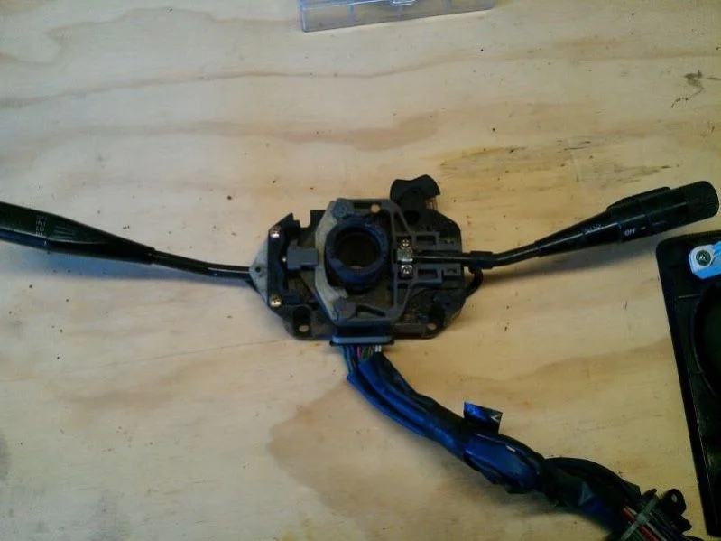

I was able to get a 24v one from a RHD Japanese HJ60. When plugged in all the wiper functions worked, but the orientation of the switch assembly is backwards and doesn’t fit the steering column mounts.
So I’m sure the actual wiper motor and relays all work, just need the right version steering column switch for my 85 HJ60.

I’m pretty sure it does. I was told there was a different part number for the steering column assemblies on the 24v trucks. The 12v one I currently have in there seems to be wired different for the wipers speeds and all that works is the intermittent wiper function....which doesn’t cut it during our rainy season.

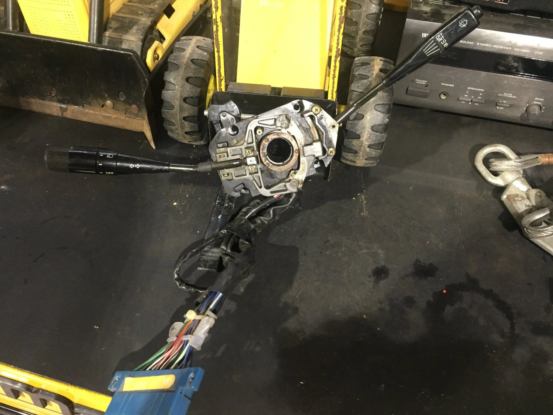

Here's one of the switches that i found. I know i have another couple kicking around somewhere, I'll keep looking. Can't see why it would matter wether it was 12v or 24v, the switches don't recognize voltage and they're isn't any sort of resistive load... the motors they're controlling would do that. Someone else that's had them apart would possibly know why.

You are correct, there shouldn’t be any voltage stamp on it. The way it was explained to me was the way the wiring for the Int, Low and Hi were configured on the wiper switch. But now that I think of it, that may be more year specific then 12/24v specific. All I really know is that my wipers only work on Intermittent setting and it was pouring rain the other day while driving. It was kinda dangerous, so I really need to figure this out before driving my 60 again.

I wish I would have taken some pictures of the inside of the switch, but it looks to be a bit more complicated then switching the pins around, which was definitely attempted. I will see if I can get it off the wheel tonight and get some pictures to show the difference between the spare JDM RH drive one I have (that works the wipers, but doesn’t fit a LH drive steering column) and the 12v Fj60 one that’s on there.
