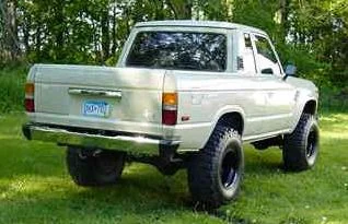

That is exactly how I want to chop my mates white 60, but he is a little aprehensive about the amount of work. I think it will look great, retains the 60 series feel, while reducing the roofline.
Paul
yeah!,, it's really cool. It looks to me as the small window on the rear doors and part of the rear-door window-frame has been used. If one wanted to one could cut the top 4" of any hilux-bed and get a nice edge on the bed..
Just make him do it.. I'm sure you'll have most of it done in a weekend, atleast the major components..(lots of fiddeling afterwards i guess:wrench:)
If one has a good plan on how to cut/join pieces it should be all fun!
