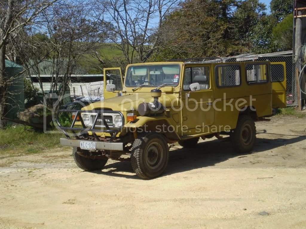

Pics of my cruiser for any of you that are interested.

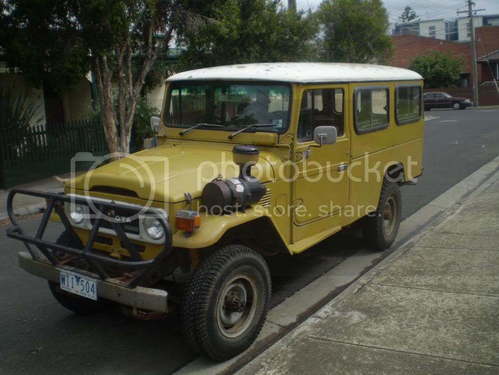

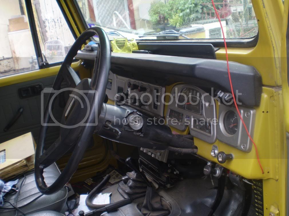

It's an 1983 HJ47 Troopcarrier. Making it Disc Brake Front, Tacho, SuperGlow Vintage

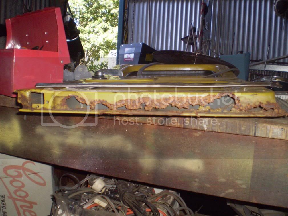

Bought it as a bit of a rust bucket (but looking at some you have in USA it was pretty good quality). Never done body work before so it was a slow learning curve.

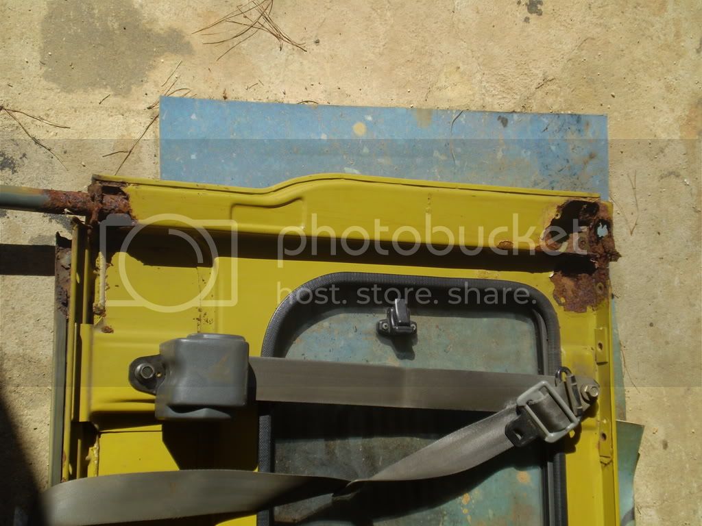

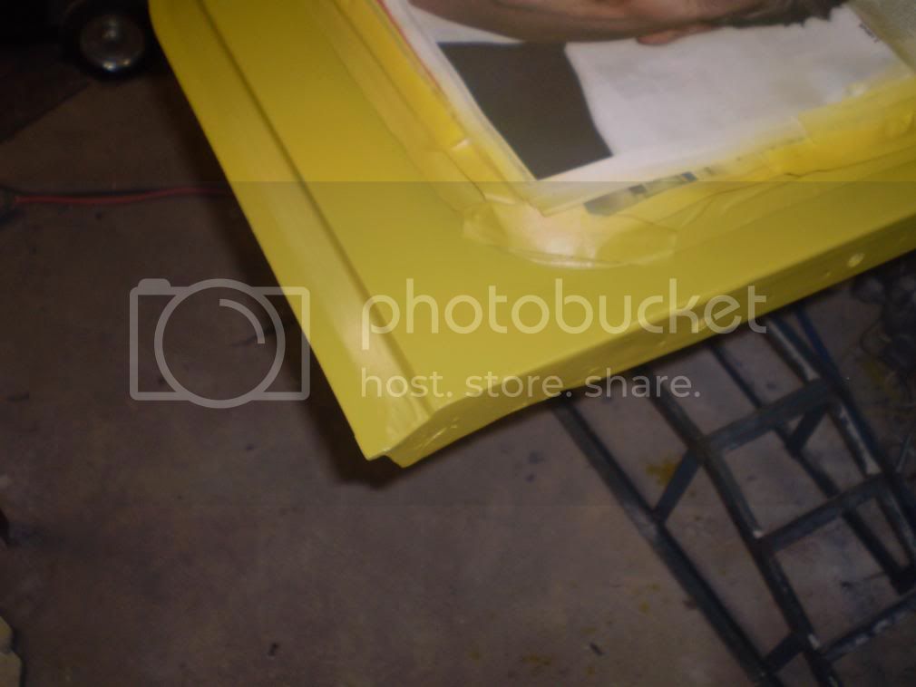

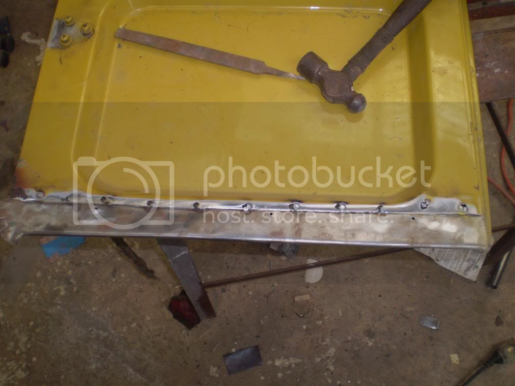

This was the rear passenger door (left side over here). I ended up buying a BRAND NEW one of these from central Australia but haven't fitted it yet so I repaired this one instead

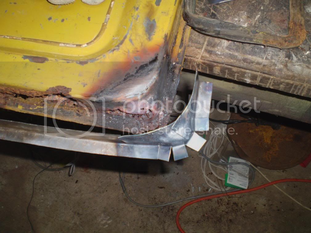

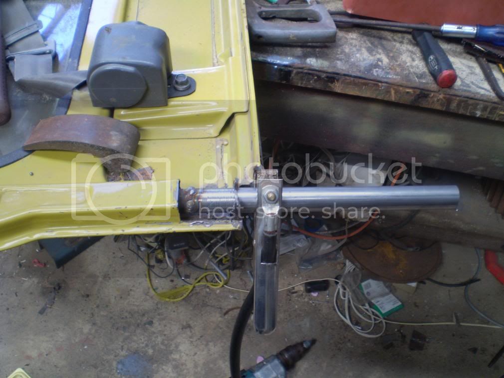

Side panel had some structural rust too. Replaced that 1inch OD pipe with some a 3mm version. Should be nice and strong.

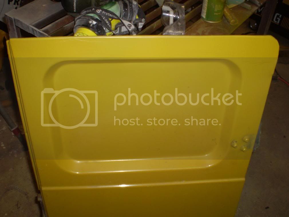

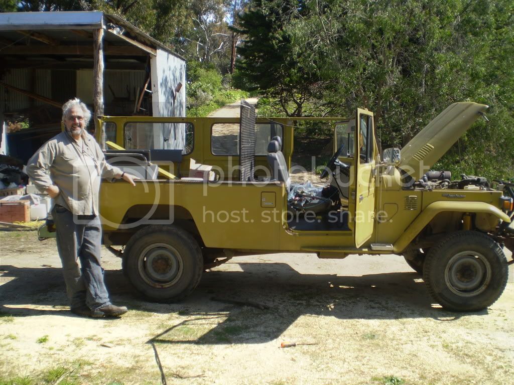

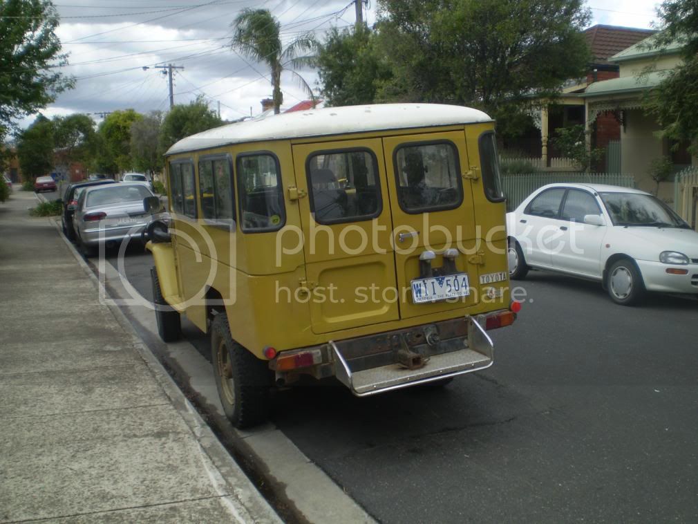

Finished Product looks like this

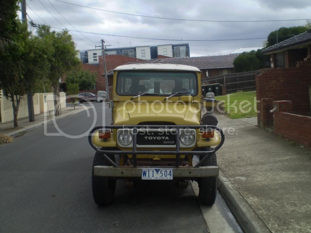

Notice how someone has already tried to pinch it in the 2 weeks ive had it on the road. Lucky the dumb theif couldn't start it.

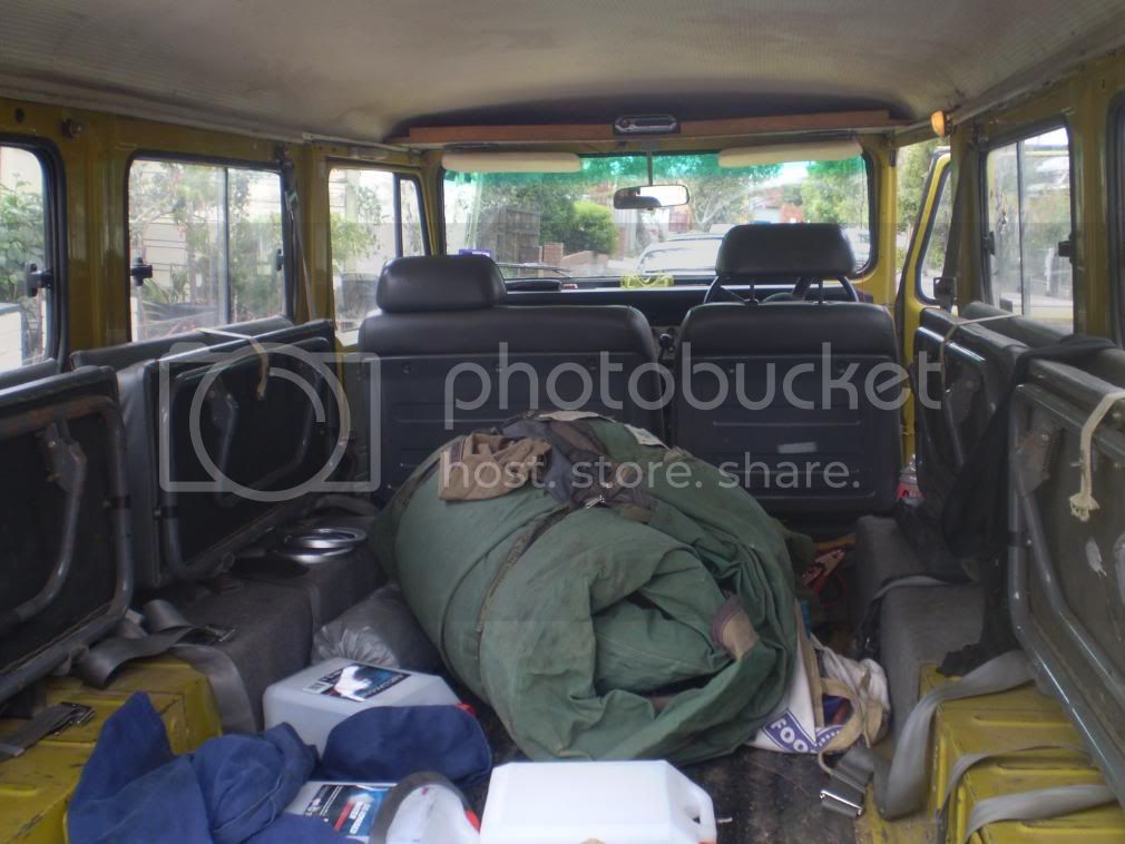

Had original troopy seats too. Registered as an 11 seater (allready full of junk)
probably a slap on the wrist. He missed a $120 ticket and $300 calculator in the glove box. But if theives were intelligent they probably wouldn't be stealing things for a living.
