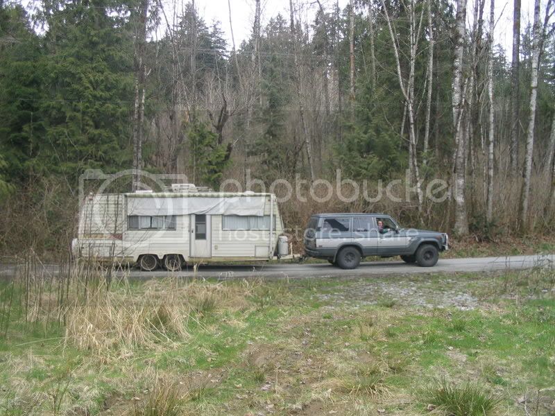

Well, I have to say it again myself...I towed a 23 foot trailer, approximately 6000lbs with an 87 HJ60 across Canada and back, 15000 km's in total. It was slow but it wasn't unsafe, IMO.
This photo has it attached to my FJ60 but you get the idea.
