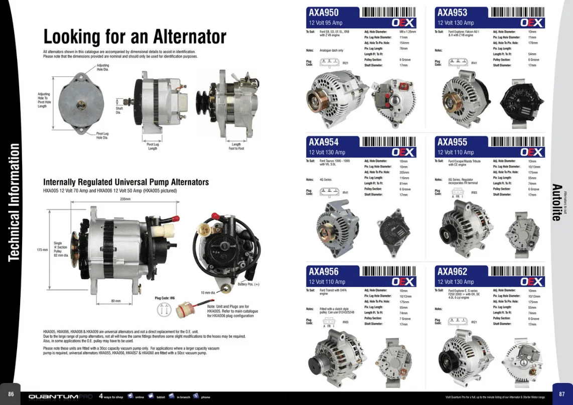

I dont think anyone has found an alternator that is a direct replacement. There are some Isuzu trucks that have alternators close to what you have in shape but they still need some kind of bracket modification from memory.
No idea. Have you tried searching? Its one of those thing where you buy the alt then make your own braket.
Ashdown Ingrams site in australia gives you the dimensions for the mounting in 3 ways
