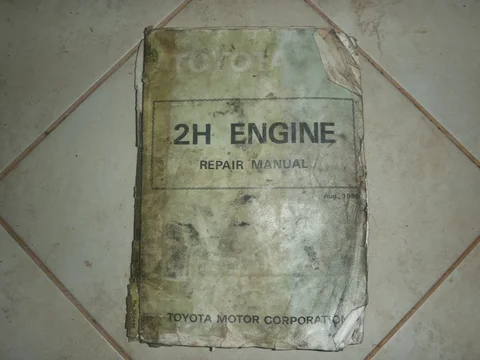

yes dont forget your bible. my copy was handed down to me from my late father. it has been very well read!
