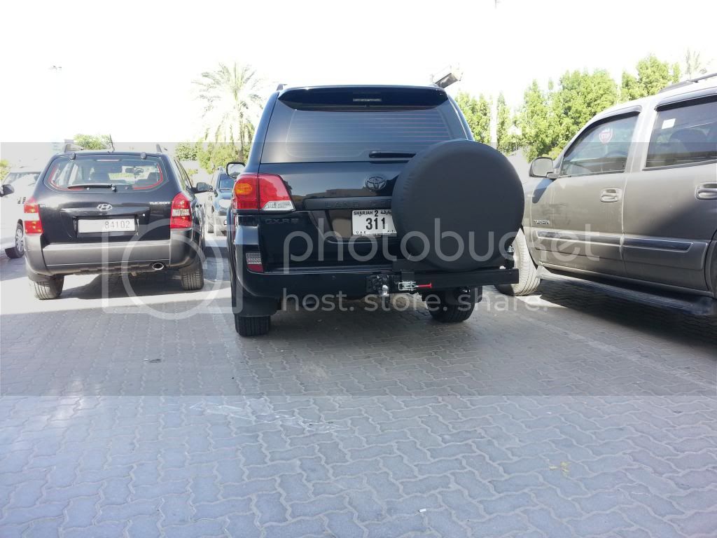

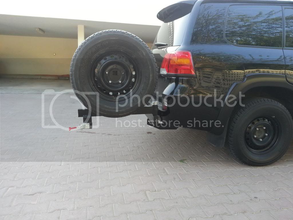

I had a spare wheel carrier fabricated, and today had it installed :D

Thanks. I have the stopper but didn't have time to install it. Good idea about the grease nipple I'll have that put on with the stopper this coming week.

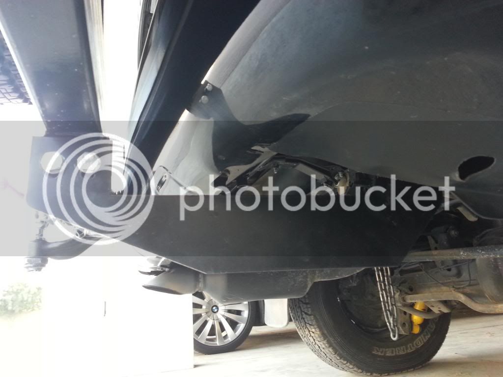

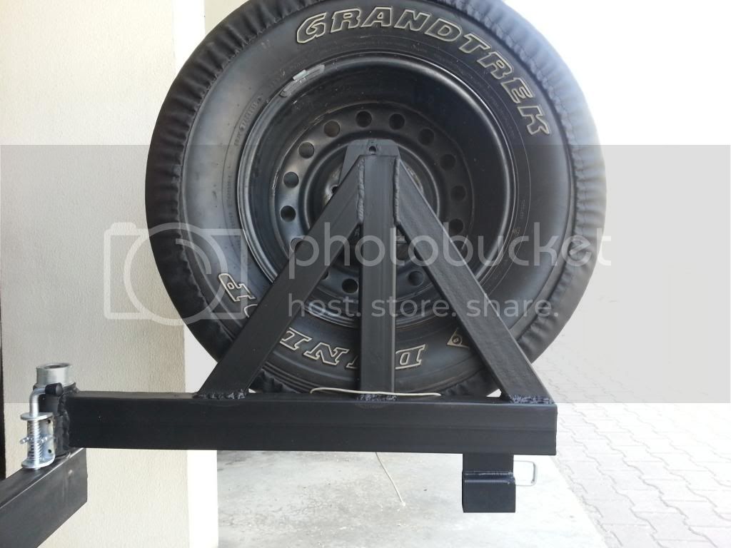

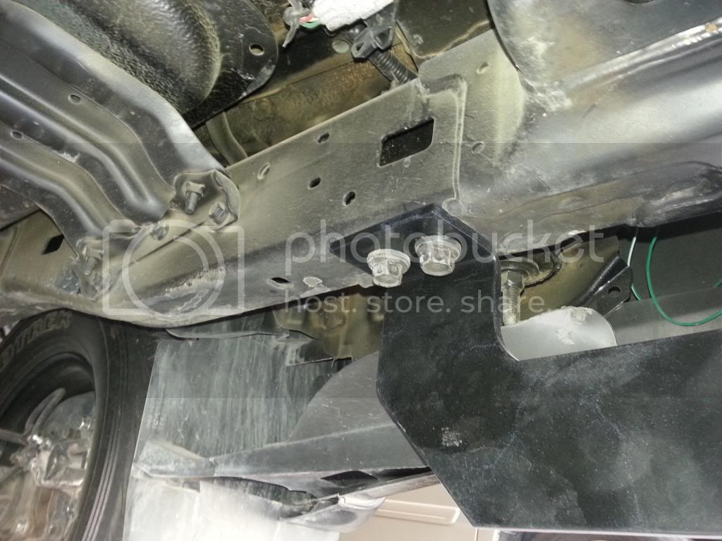

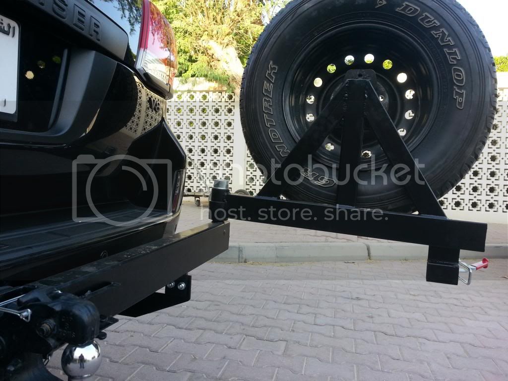

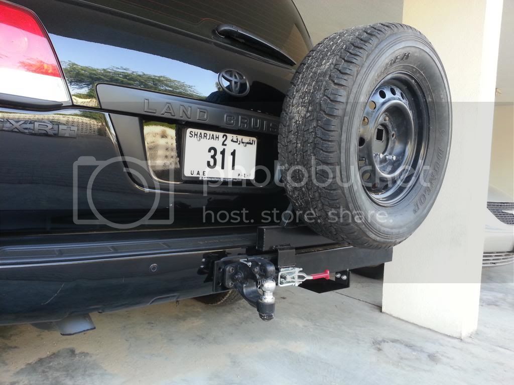

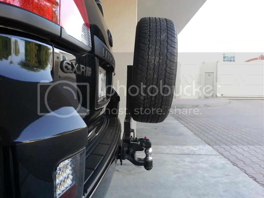

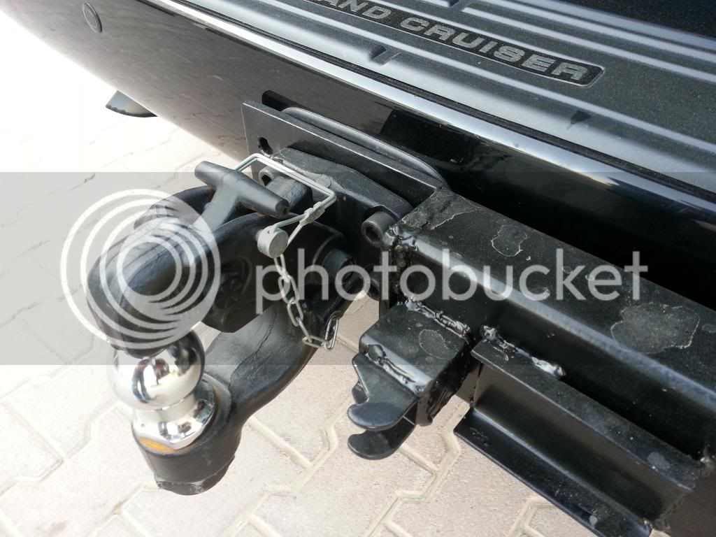

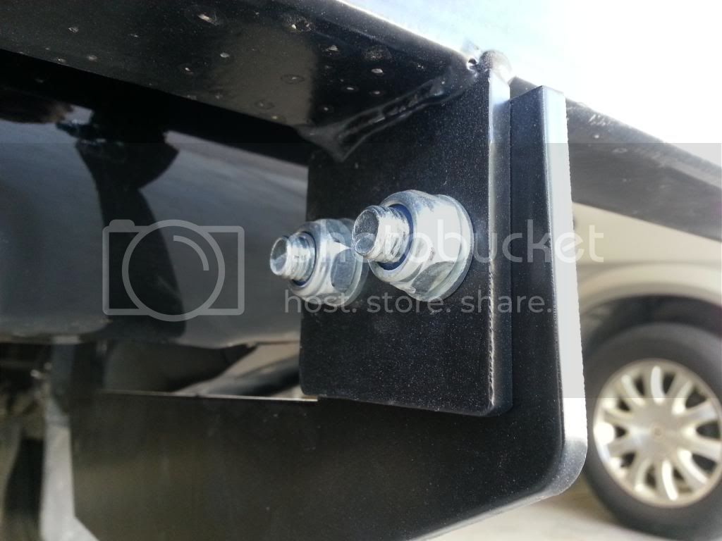

Here are some close up pics of the carrier :doh: and I forgot to get pictures of how the bracket is installed under will get that tomorrow.
Bar is mounted with tow ball bolts going through it as I needed to keep it for towing the horsebox. right recovery point under the vehicle was removed and a bracket bolted there connecting to the carrier for extra stability and recovery point moved over to the left side.

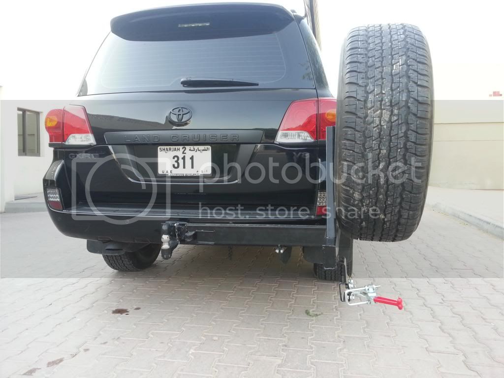

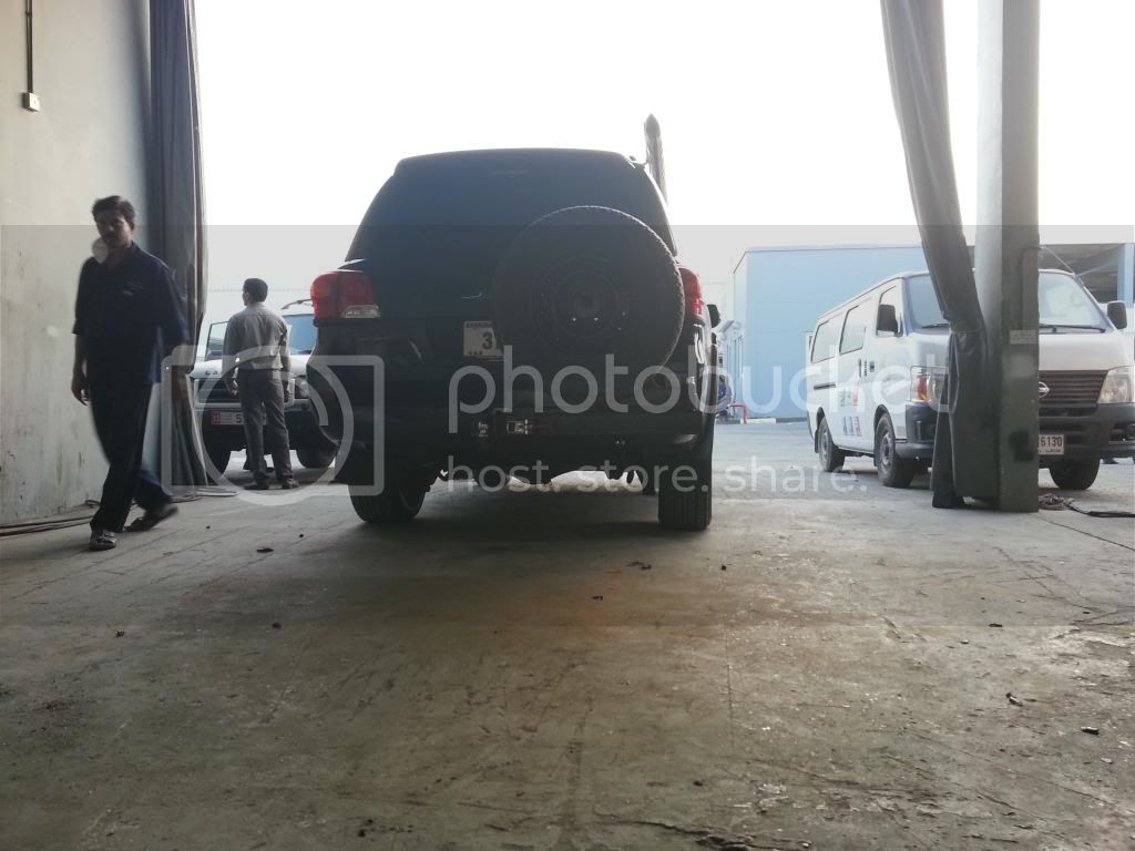

No rear left light ,no left indicator
Edit : From the angle of the last picture the light is not visible but the other picture it is visible could it be adjusted so it does not be an excuse not to cover a claim god forbid
The whole carrier was fabricated it's easy to change where the wheel mounts to adjust left/right or move it higher/lower. Either have to make an L shaped bracket or change the whole piece to have it more on one side

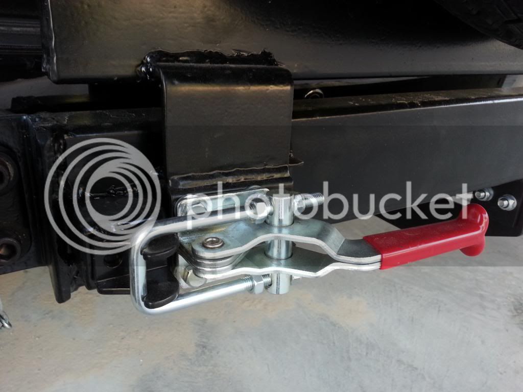

Modified the tire carrier a few days ago,
Installed the locking pin
Moved tire carrier section 9.5cm to the center to clear right brake/signal light
Shortened the bracket by approx 1inch to have the carrier sit closer to the bumper.
