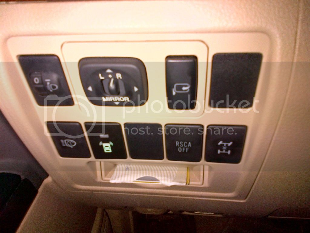

yes please - if you can share the pic - also which kind of difflock it is ? LSD or rear? thanks.. maybe your manual says something...
A center diff-lock only locks the output shafts that come out of the gearbox, this only means that the front and rear axles turn at the same speed (50/50 drive split between front & rear), the actual front and rear diffs are still open, its helpful if you get one wheel up in the air, but get cross axles and your just as helpless as everyone else. Thats when you need full diff lock on your front and rear axles.
An LSD (limited slip diff) works in a different way and isn't quite useful as a locker.
I only have a center diff lock on my lc.
Thanks nomad - ill check this out on 2012 winch model !

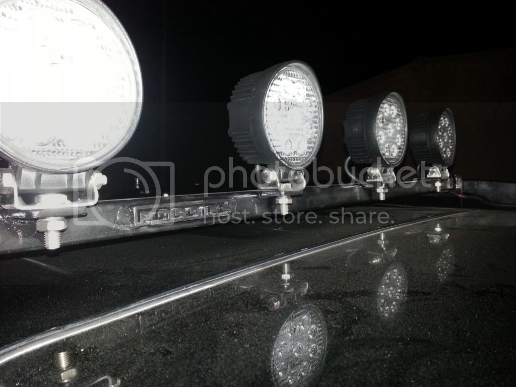

Did you get a dual battery setup for these spots?

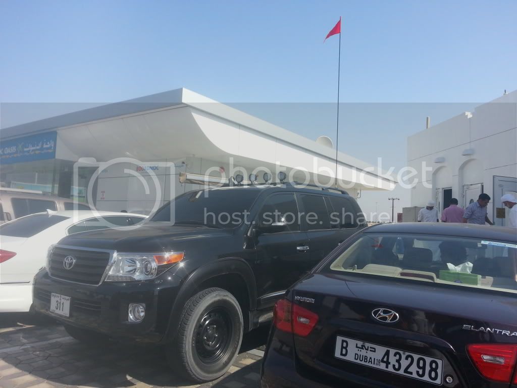

No dual setup, each spot takes 27watts and I don't have most electronic additions ssh sets heaters traction or crawl control. The fuse box had a lot of empty areas where the relays go so guessing it won't be too much load on the battery, or at least I'm hopping it won't.

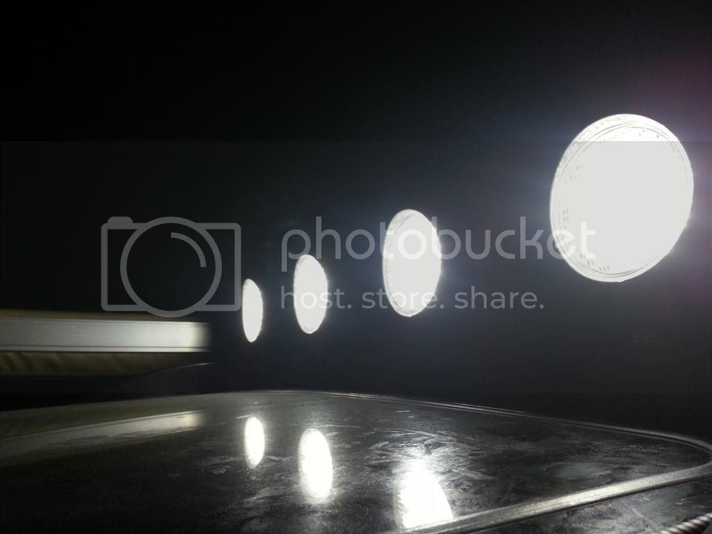

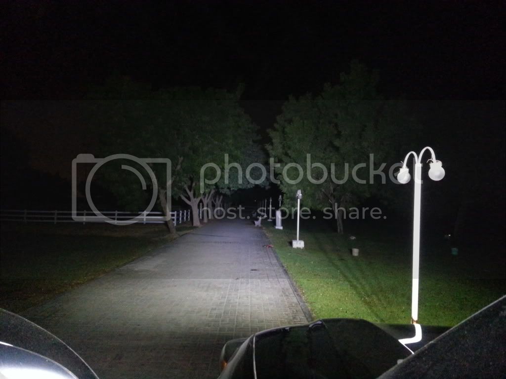

Could you get a shot of the forward illumination range of these lights? it looks like they wont show whats directly in front of you but rather whats further out at a distance.
Light range is a bit further and this is with just the spots on. I'll get better pics in a wider area first with the headlights then headlights and spots.
These are from yesterday's trip out
That is fantastic performance, i can even see the back fence!!! That 200 just keeps gettin better and better!! Subscribed to this thread and cant wait to see more!!
I kept looking at the pic trying to figure out which park in SHJ has trees and a fence like that.
