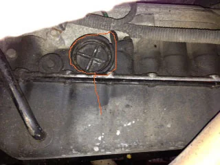

I have a 1991 surf and was working perfect till last night i topped up transmission fluid, today after 15 miles it would not go into top gear(auto transmission), i pulled over and tried reverse but to no avail,
I am baffled, have it on the lift now,
If it is any relevence i took out the round plug in attached picture but put straight in again ( thought it was a fluid level guage by looking into it)
would like any guidance as i am lost

What was behind the plug? I'm not big on autos, but if there was a spring or valve or something like that back there you may have upset the "adjustment" of something if the plug was screwed in more or less further than where it started at.
