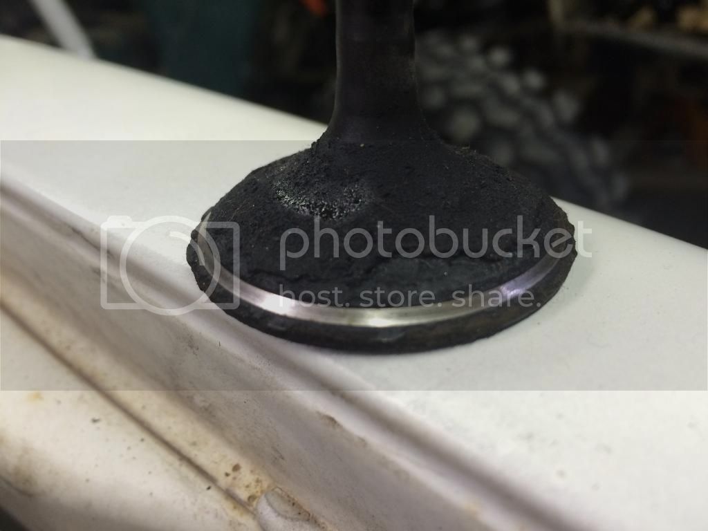

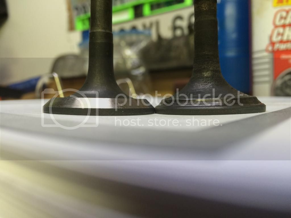

My intake valves were visually/dimensionally fine so they were reused. The exhaust valves on the other hand were obviously in need of replacement, both on my ~400k mile head and the unknown mileage replacement head, although worse on my original head. I used Clevite valves - paid about $70 for the set, they were US made, but by the looks of the boxes they were NOS.
That's awesome news. I actually have found an NOS set of Sealed power that look to be over 20 years old for sale at $90...maybe that's the way to go!
Here's what one of my exhaust valves looked like next to a new one...
And one of the intake valves (not the best picture) They all cleaned up fine and were reground.
When my head was rebuilt two years ago I wanted the Chevy valves, but the machine shop looked at me like I had five heads when I asked about it! They insisted that it must be OEM. They are touted as one of the best machine shops in the area. I gues they did a good job, since it is still going strong two years later.
