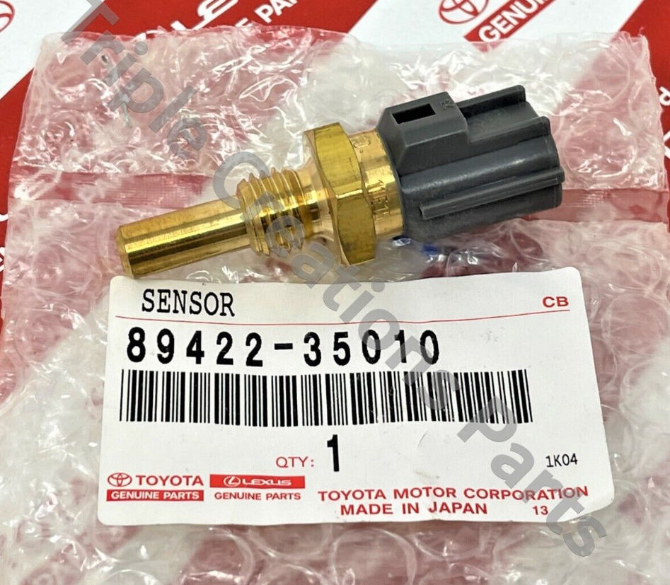

I went through a high idle issue at one time on my 94 and eventually figured out it was the engine temp sensor. Not the one that reports to the gauge, the one for the ECU. It was faulty and the ECU thought the engine was stone cold intermittently.... Raising the idle.
Eventually it wasn't intermittent and the idle was around 1800 at all times.

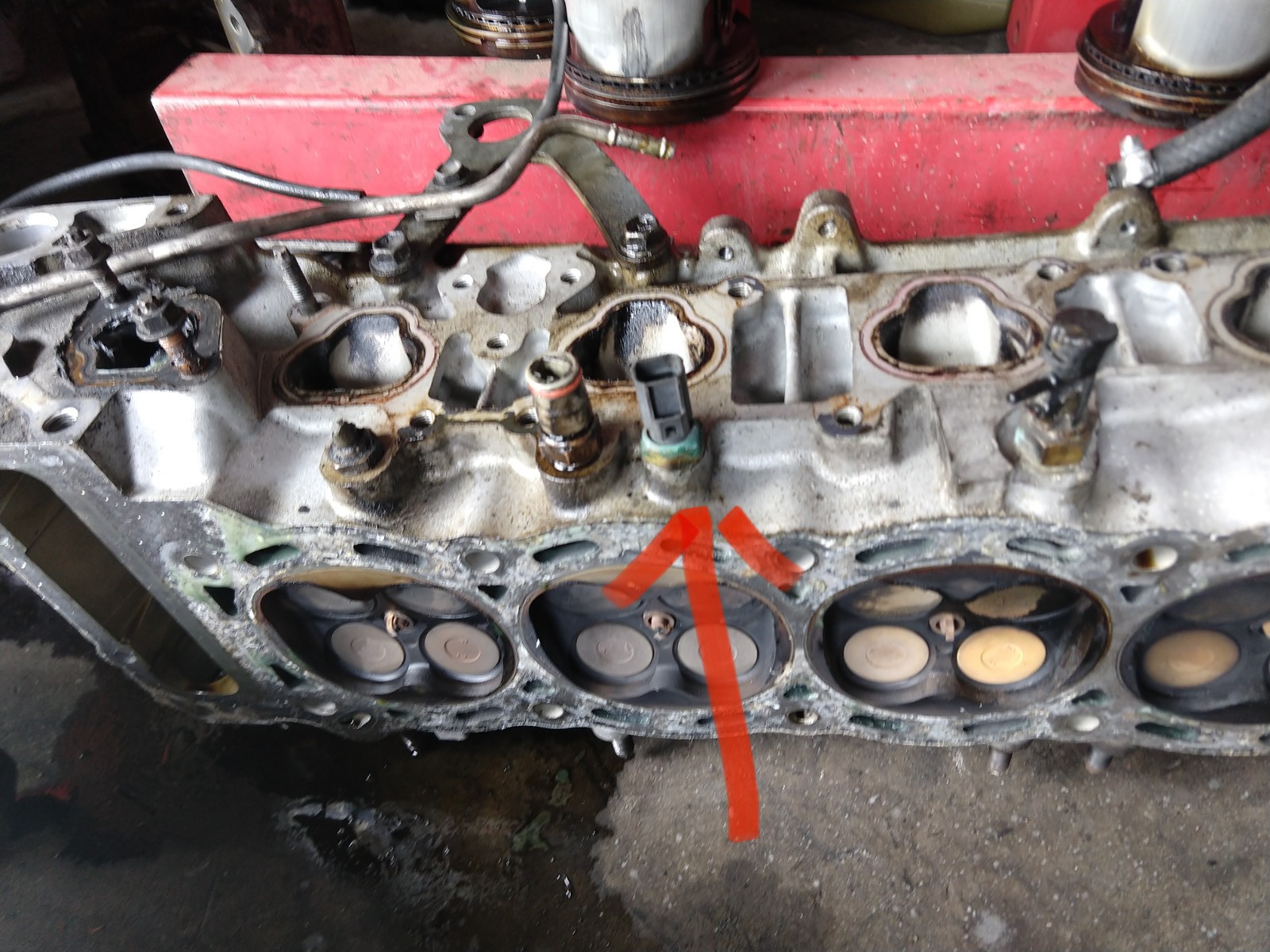

Just following up on this, I had the same issue. Is this the sensor below the upper intake? If not, where is this located? I want to try to replace mine.
Yes. You can swap it out without removing the intake.
Will it spill oil if I remove it?
Thank you
No, it’s screwed into a coolant passage. Not much coolant will be lost.
Keep in mind there is two temp sensors in the head. One is for the ECM to read from, and the other is for the temperature gauge in the dash. IIRC, the ECM’s sensor is the third one from the end of the head closer to the front of the truck. Let me see if I can find a diagram.
