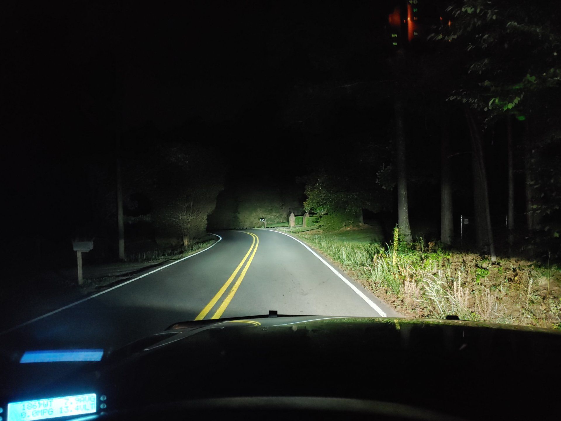

You gotta get those 2-strokes, man. Keep up!
*Note: adjustment is low in these pictures. The 2-stroke LED high-beam upgrade that Lou sells is awesome. You'll never be stuck behind a left-lane camper ever again. Especially at night.
