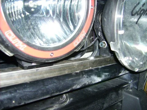

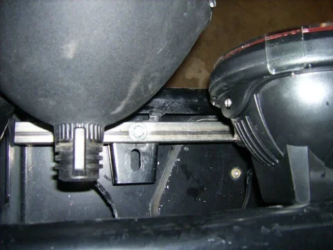

So I picked up a set of those $100 HIDs from Checkers and finally got around to putting them on. It was a pain to come up with a way to fit these on my ARB along with the Lightforce 240s. The best thing I could come up with was to use a piece of square tubing (Grey), drill new holes in the existing mounting tabs (red), then drill new mounting holes in the square tube for the lights (blue). Now that I know everything fits I have to take it all back off to paint the square tube, but for now some pics:

My lightforce are not HID, the other ones are. The ballasts are built into the back of the housing:

I will work on that. The beauty of these is at only 35W, you can use the trucks existing fog light wiring and factory switch. In addition to removing the bar and painting it, I also need to rewire the factory switch. Right now I can only turn them on with the headlights, which makes it hard to get a good picture of light/beam pattern.
It will be hard to compare the Lightforce to these, as the Lightforce are a true spot light and these are more of a spot/flood combo.
