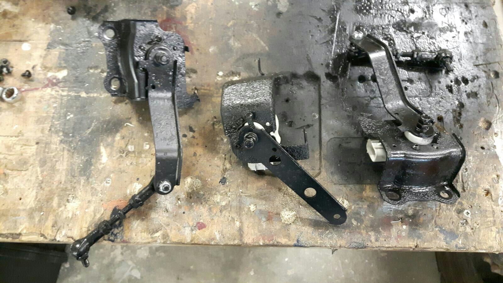

I received three new heigth sensors, just the sensors not the linkages.
Will be replacing these in the following days aswell.

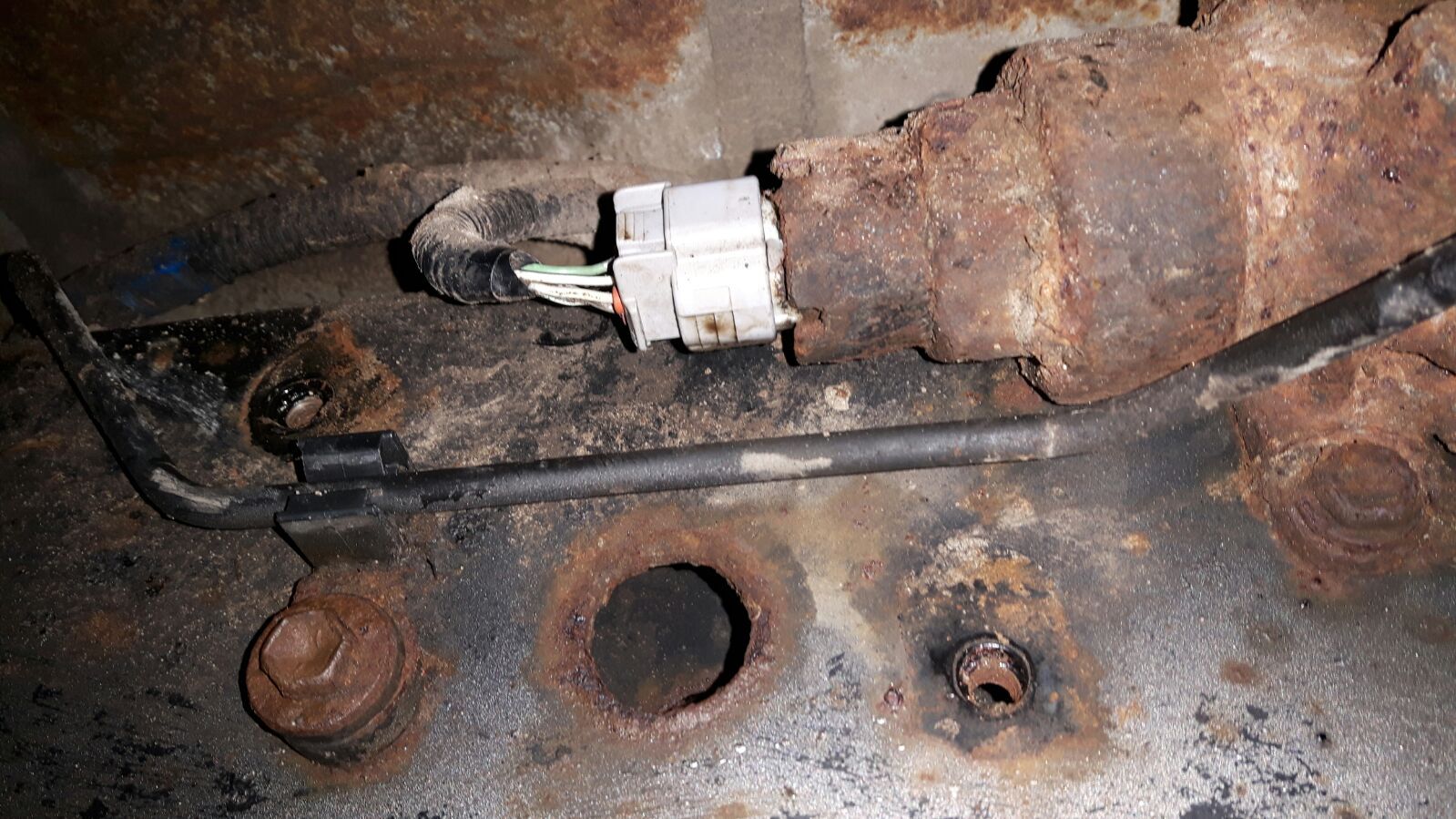

Today I checked all connector on the damping units. The connectors were under a load of mud.
Suprisingly clean on the inside though. Cleaned everything and reconnected.
I also coupled my new height sensors onto the connectors. I didn't installed the linkages yet as I derusted & painted (still wet) these.
Step values still 0 in techstream, car on lift, wheels off, car off ground.
Will put it on the ground tomorrow and test the functionality.
Yesterday I fitted the new sensors to the linkages.
FIrst I removed the rust, then painted a layer of rust protection, then two layers of matte black paint:
Fitted the sensors to the car, got it on the ground, has not solved the problem as expected. But at least I'll have new sensors so we know those parts are ok.

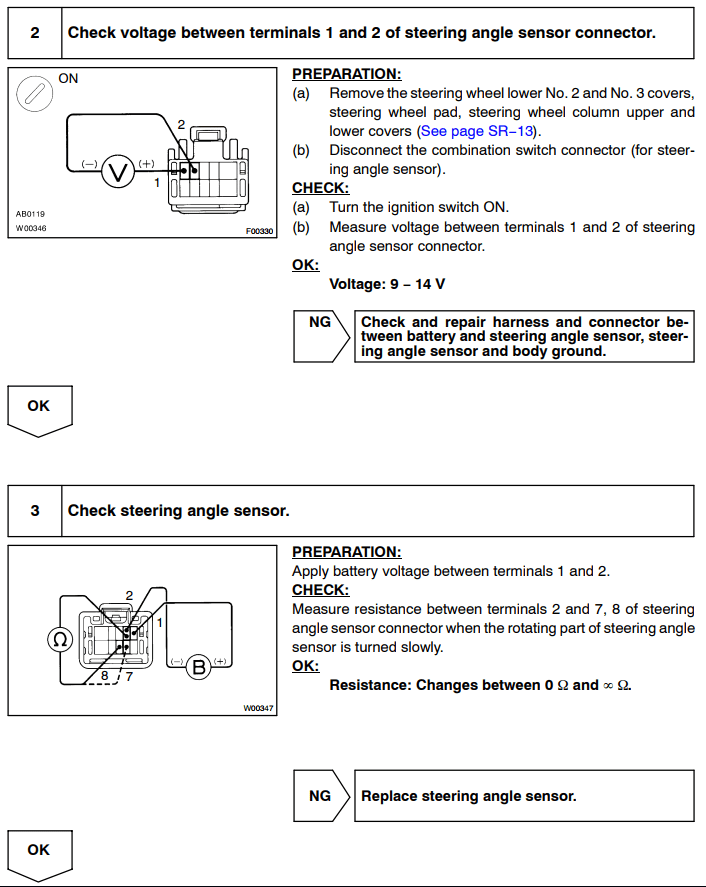

When my wheels were straight the steering angle sensor in techstream does not give 0.0 degrees but -492.75. Also when I turned to the right techstream stated 153 degrees, fully to the left was -1145.40 degrees.
I do not have or had a trouble code that included the steering sensor. But I decided to look at the DTC 1781/81 page in the FSM (on page DI-265).
There the steering angle sensor is described as a incremental encoder
Then I checked the inspection procedure on page DI-267:
When I use techstream the value changes. But when I measures SS1 and SS2 with my multimeter I got different values. On both terminals I got values of 0.33v or 10.54v, obviously not good.
So we move on to page DI-268:
There was a voltage of 12.18v on pin 1 & 2, so this is a pass and we move on to step 3.
I did not apply separate power to the connector as described, but used the plug where the power of 12.18v was present. The resistance I measured was 3.7 to 3.9MOhms and was not changing from 0 to infinite. So according to the FSM I’ll have to replace the steering angle sensor.
Is there a way that this error would cause my AHC problems and prevent the system from being active?
