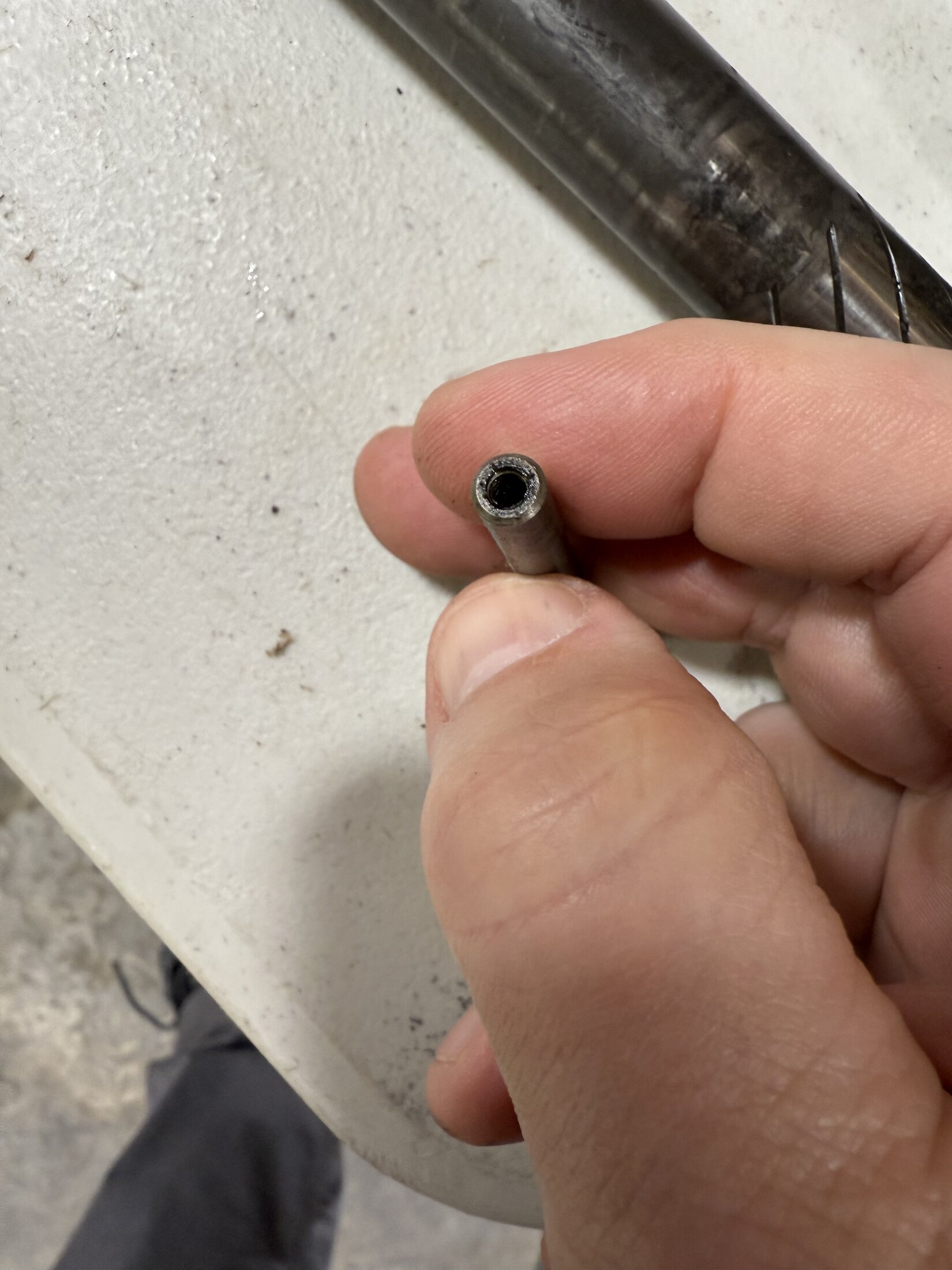

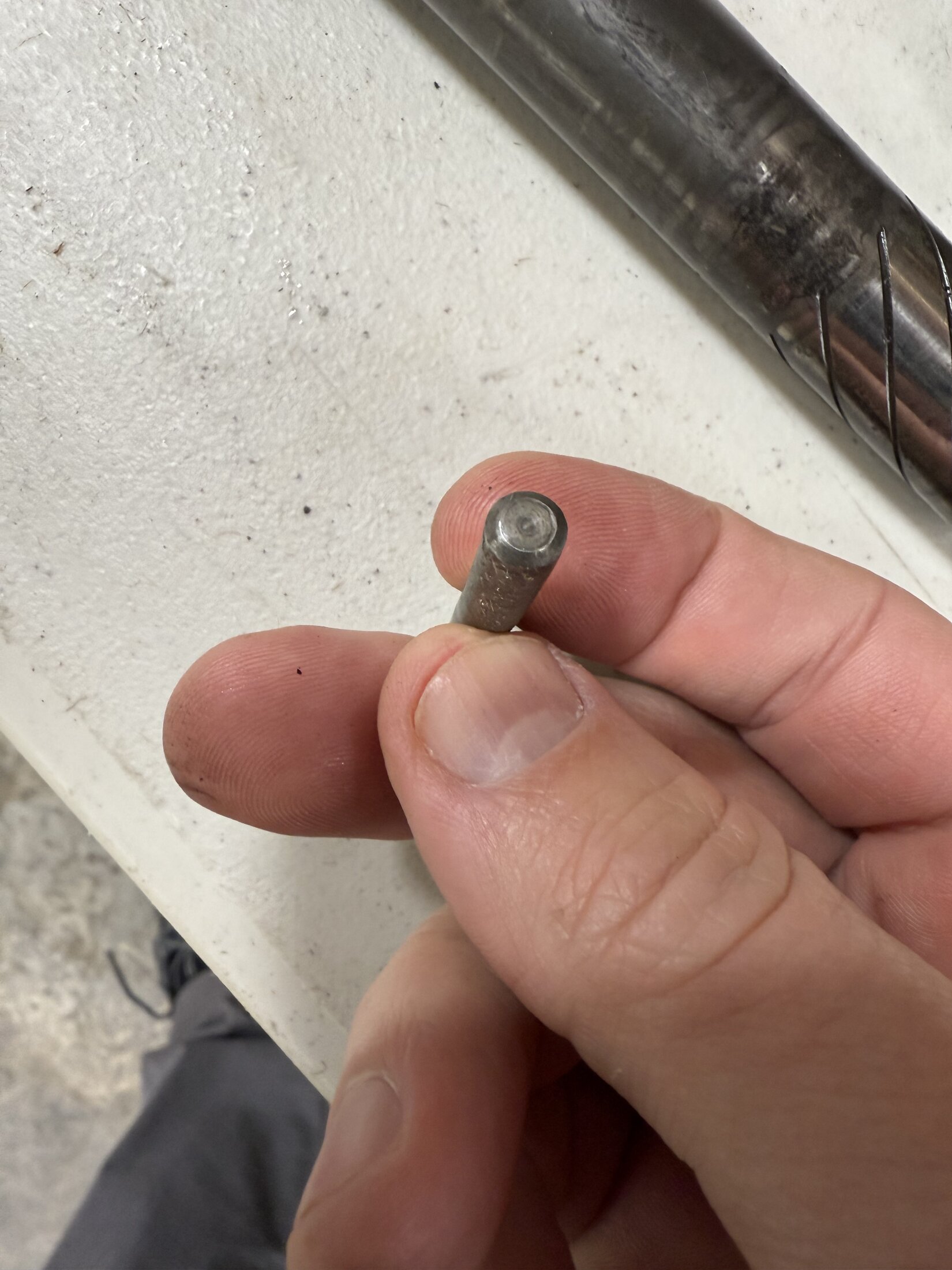

question that’s somewhat in the neighborhood of your problem. I have that same locker, a RD80. Trying to get my axles out but having trouble getting the retaining pin out. The schematic shows one pin but the item list says there’s 2. Guessing one for the long pin, one for the short pin.
Problem is, I can’t get the retaining pin out for the long pin and have no idea where the retaining pin is for the small pin. Forums say there’s supposed to be some threads on the end of the retaining pin in order to pull it out, mine appears to be a flat ended pin and I don’t know how to get it out. It was already installed when I bought the FJ so a little clueless.

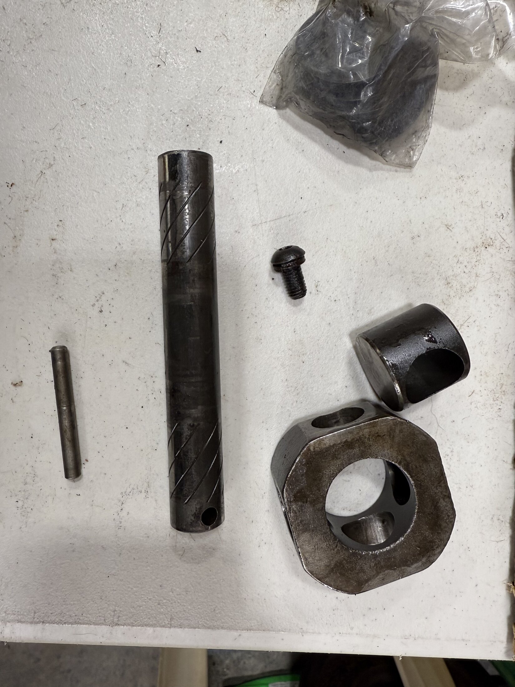

There was only one cross shaft retaining pin in mine, which was holding in the long cross shaft. The short cross shaft is held in by the long cross shaft. The retaining pin for my long cross shaft did have threads into it. Supposedly there's a special tool to thread in to remove it (which of course I didn't have), but I tried a few different small screws from my parts bin and found one that would screw in far enough that I could pull out the retaining pin, but it still took some careful fiddling to get it to come out. I don't know why the parts list has 2 retaining pins listed but I only had to remove 1 to get my axles out and didn't see where a 2nd one would have gone.
I checked the little screw I used to get out the retaining pin, and it was 6-32 size. Here are some pics of the parts so you can see what they really look like.
Note that the pin in mine is only threaded on one end.
Thanks for the reply, I think your pictures show my problem. I can see in the hole that my pin was probably installed threads first.
Going to have to get creative in this one. Thanks again
I suspect you are right, backwards install.
The removal tool ( ARB 1201T as I recall ) is NLA but can be replaced by a screw as others have found. I still pack a 1201T in my tools as I’ve installed and run across enough of them :D
