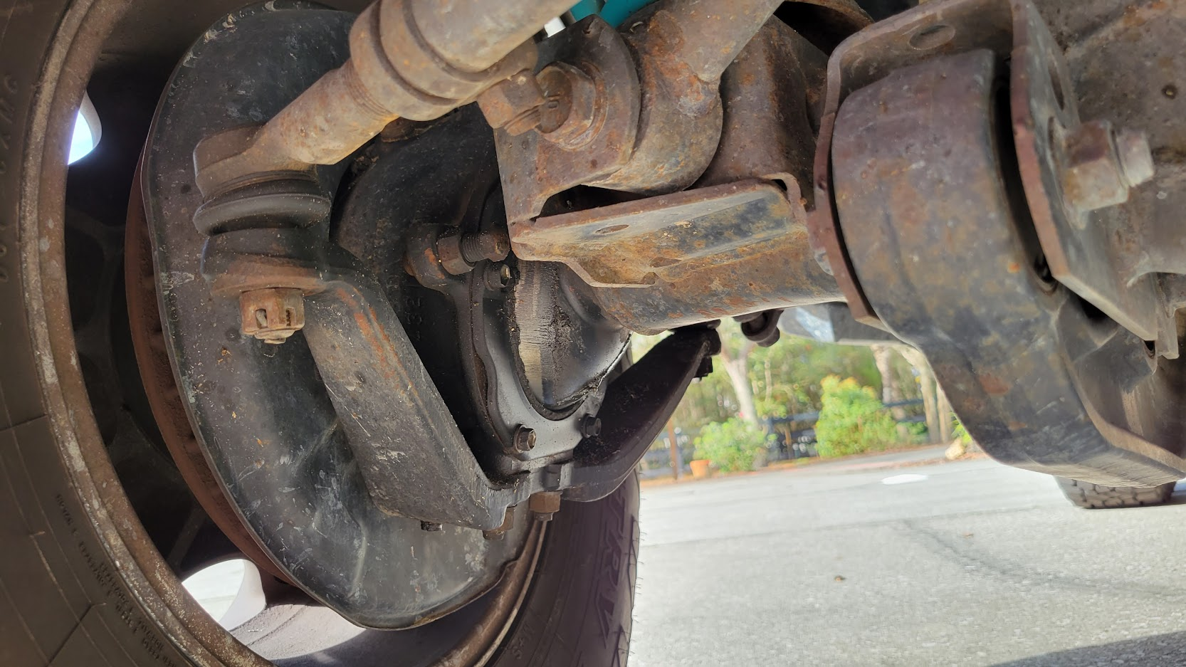

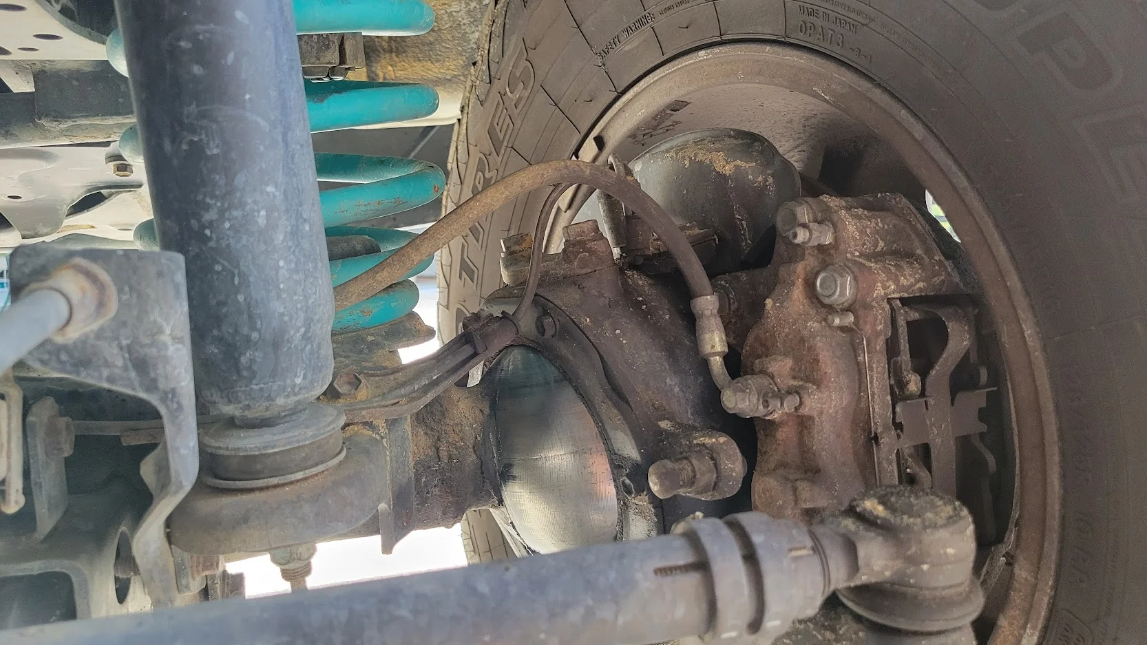

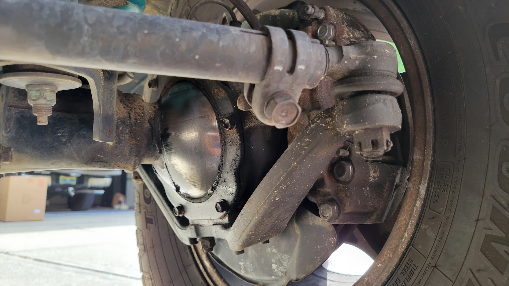

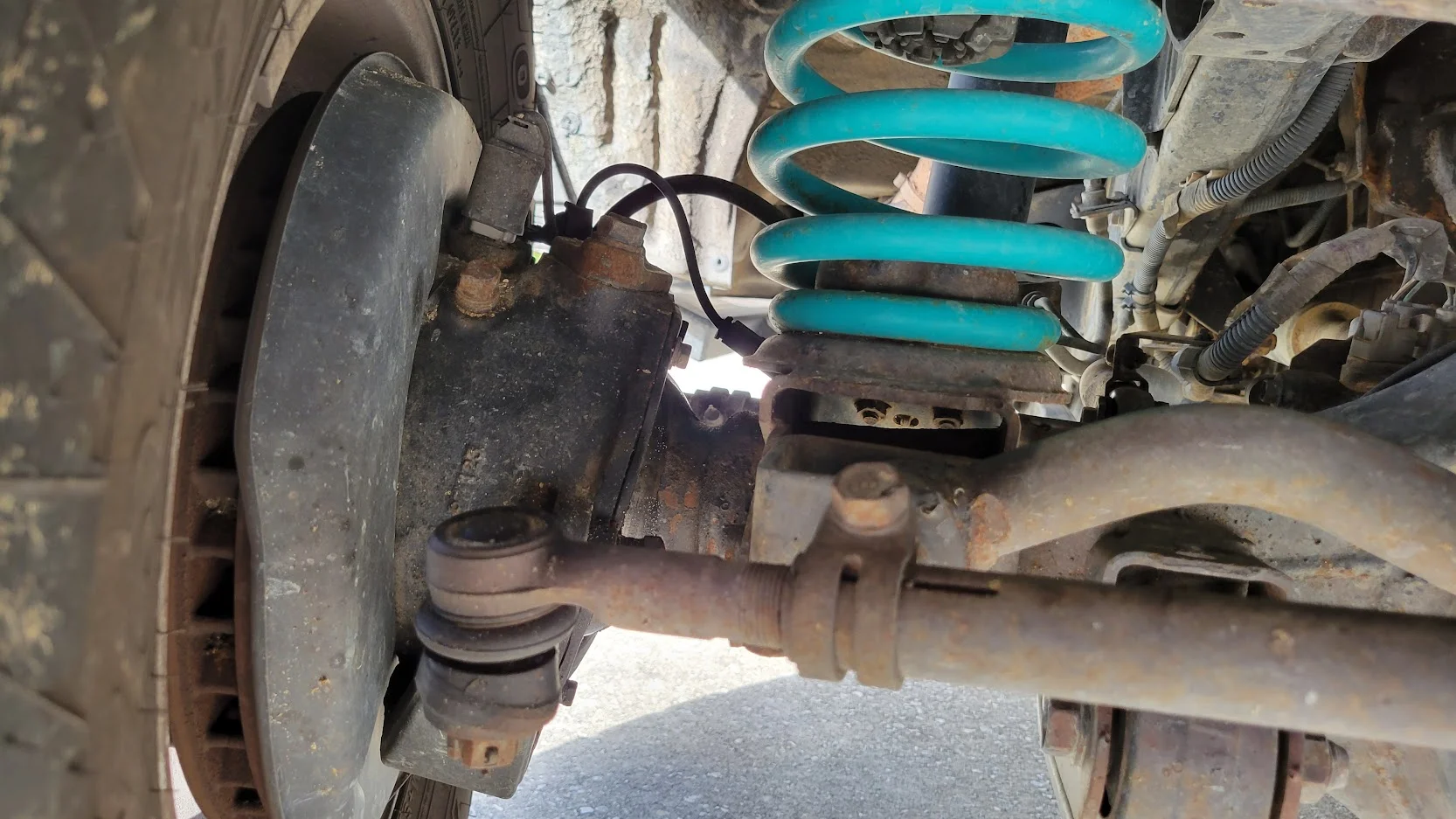

Does it occur for example when leaving a parking lot, wheels turned, accelerating in the turn to merge with traffic?? Is it worse (or do you hear/feel a rumble) first drive in the morning (cold vehicle). Any recent front end/brake/axle work? Has the complete front axle service been done, ever? Can you post up photos of the front axle, each end, where the swivel balls/steering knuckles are located.

I've only heard it 3 times now. Once was turning into a parking lot (with a slight bump) at that same angle shown in the video. The other 2 times were reversing at the angle and speed shown in the video. Have not noticed when in cold. No recent front-end work. Front axle rebuild was completed by me a couple of years ago. I can go grab a few pictures.
Angled to where noise starts

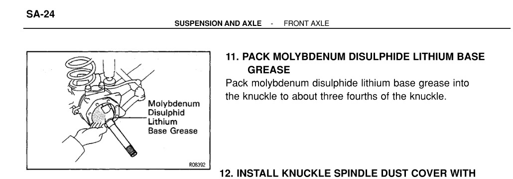

Rotational crunching noises that increase in amplification when more steering angle is applied is 99 times out of 100 an issue with the birfield(s). You need to check the grease level immediately and add a boatload if it doesn't readily ooze out when you open up the cap. When I rebuild my knuckles I dump damn near 3 tubes of molly in each side.
I've seen a tech (who is very good) at a reputable shop show me some manual that only recommended about 1 tube of grease per side. I have no idea where that came from but it's wrong.

I just pumped some more in but don't have enough, will have to run to the store soon and pump more in. When I did the knuckle rebuild, I recall putting two tubes in each side.
