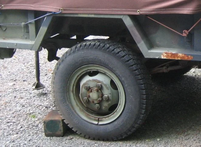

I just got a M101A1 with the 5 lug split rims. The tires are in good shape for now but a spare definitely needs to be in the plan. I had originally planned on swapping the axle out for an electric brake version with matching Toyota lug pattern. But the thing towed so nice, I really like the meaty looks the the OEM wheels, and the built in parking brakes are pretty handy, so I'm rethinking that.
Could someone help me figure out what wheel exactly went on these things so I can figure out if I can even find a spare wheel, and if I can even get tires and tubes locally. What kind of tire do I need to use, and can I get a smaller diameter one that's easier to stow?
All I can find is that the Dodge M37 had the same wheel, but I can't find if there were any civilian rigs that used them that I can cross reference.
These are 235/85-16 about 32" tall, if you have 900-16 NDT they're probably 35" tall. Wheels are power wagon and some other real oddball stuff, anybody who sells surplus or a boneyard that has trucks should have some. Don't overpay.
Edit - removed the M715 - wrong info
These are 235/85-16 about 32" tall, if you have 900-16 NDT they're probably 35" tall. Wheels are power wagon or M715 jeep and some other real oddball stuff, anybody who sells surplus or a boneyard that has trucks should have some. Don't overpay.
Any pics of that landing leg on the left side of that pic?

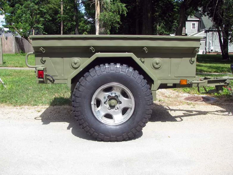

The M101 CDN (the Canadian 1/4 ton, not the US 3/4 ton) will accommodate tires up to 33" (ie the 255/85/16) without any modification to the suspension. There's no need for a spring over, for instance.

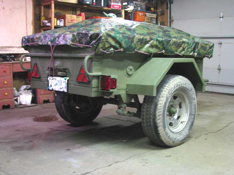

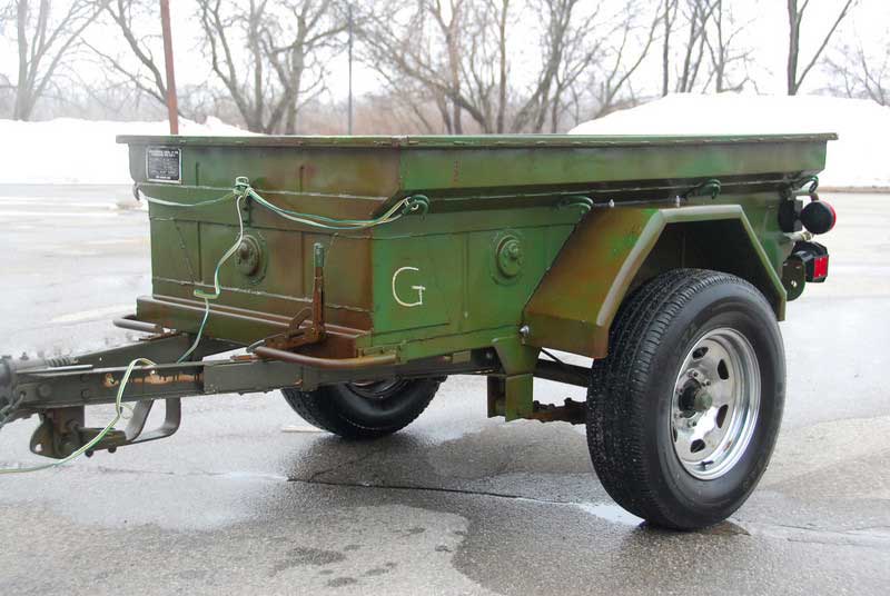

That said, the factory fenders will not cover them properly and legally in most state. It's possible that the fender lip could hit the tire tread at full compression, I don't know. I solved the problem by having custom extra wide fenders made. First pic is trailer with stock fenders, second is trailer with custom fenders and same tires, the third is with the 255/85R16 tires.. They mount exactly the same.
