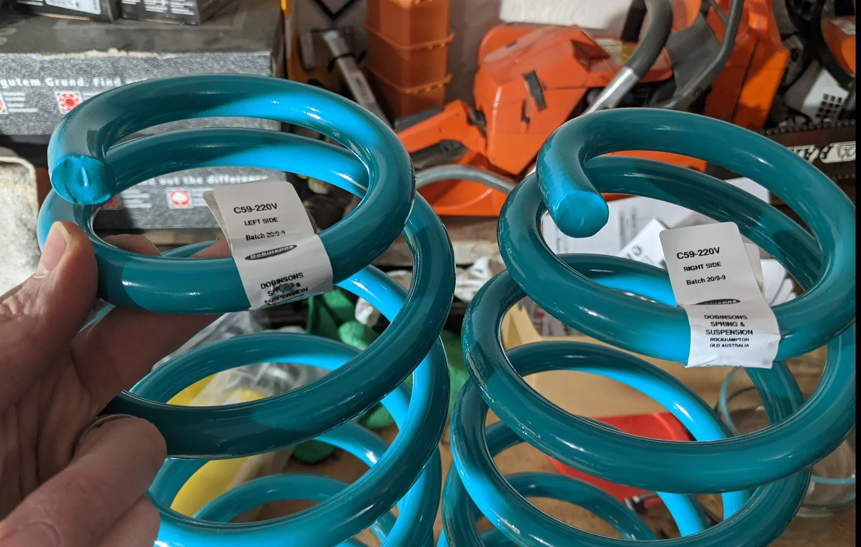

I bought the dobinson lift with the C59-223V for rear coils and C59-222V for front coils.
anyways during the uninstall of the old coils, i asked my son to unwrap the new ones. while doing so he tore the tags off.
Is there any way to identify which coil goes on divers side vs passenger? Pics maybe? does it even matter?
The taller spring goes on the Driver side to compensate for weight.
Coils are generally L/R agnostic unless you ordered a coil at a specific spring rate. If they measure the same then it doesn’t likely matter. If you have a slightly taller one then put that on driver. Generally it’s front and rear specific.
Left side (driver) is taller
