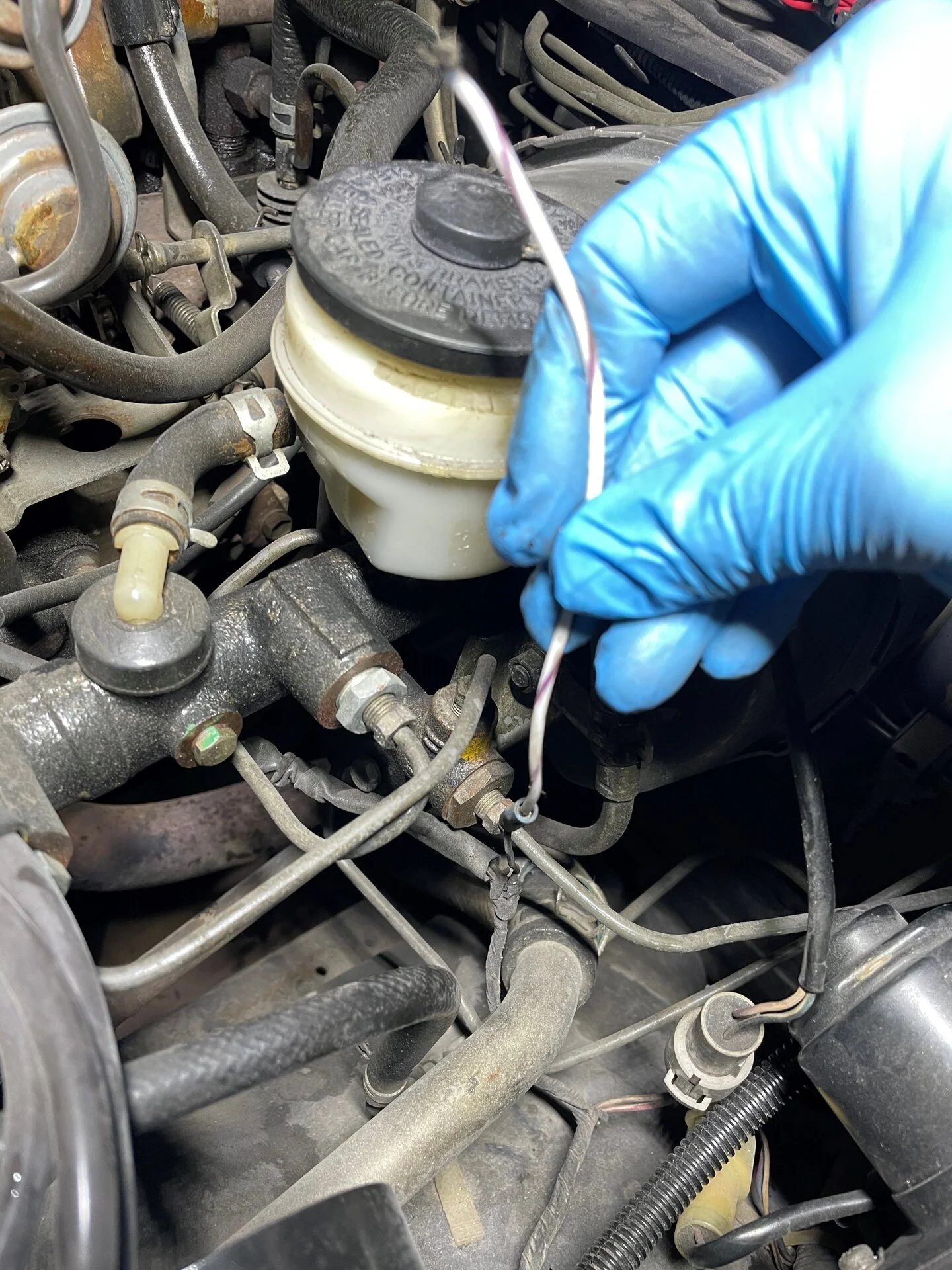

Wire #1 - White w/ Purple candy cane striping. It connects to the main harness bundle coming from the cab, but is broken clean off and was just hanging in the engine bay. Almost looks like a splice someone added at some point. First two photos are where the other wires in the bundle go and the third is the wire itself.

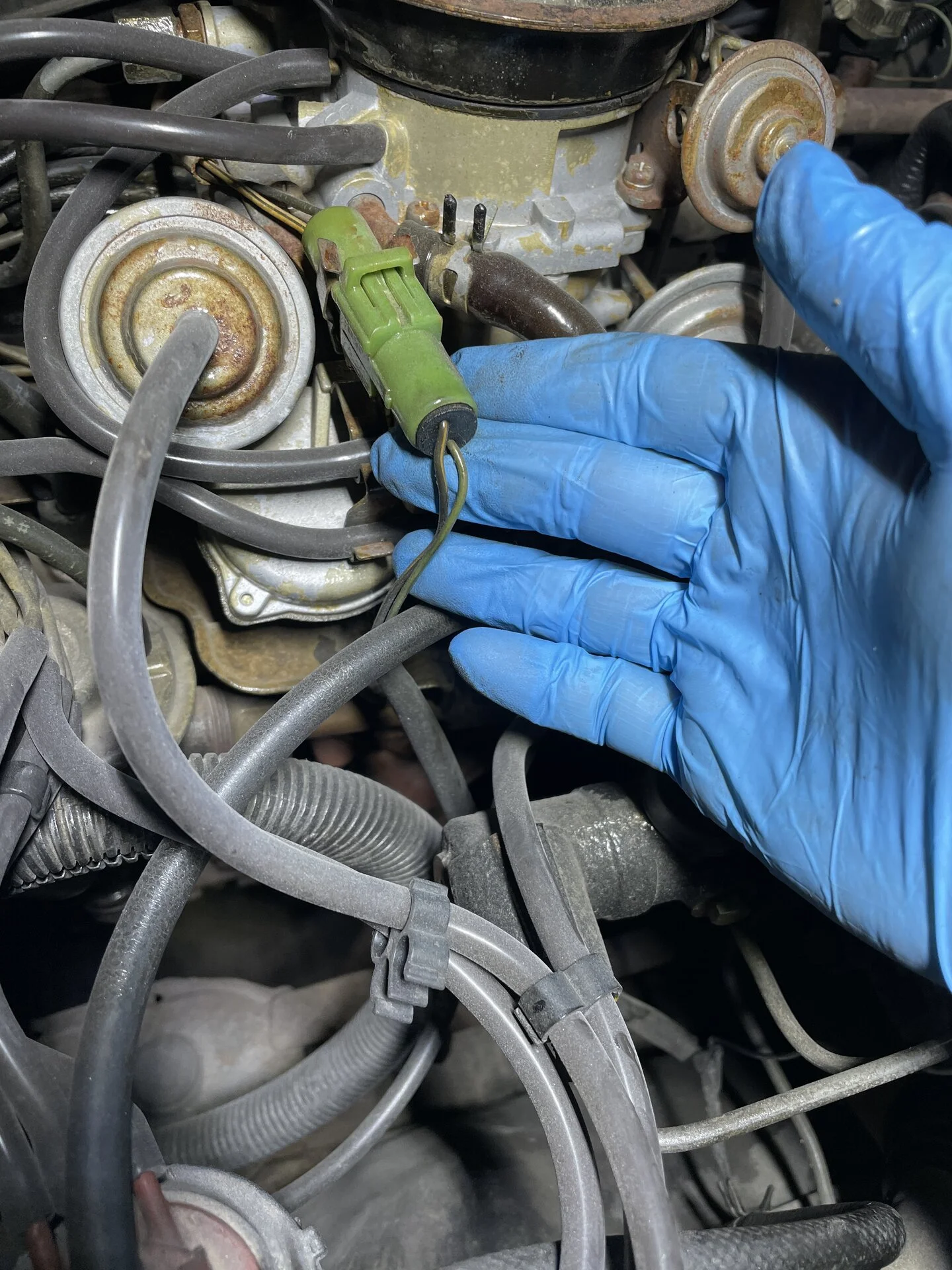

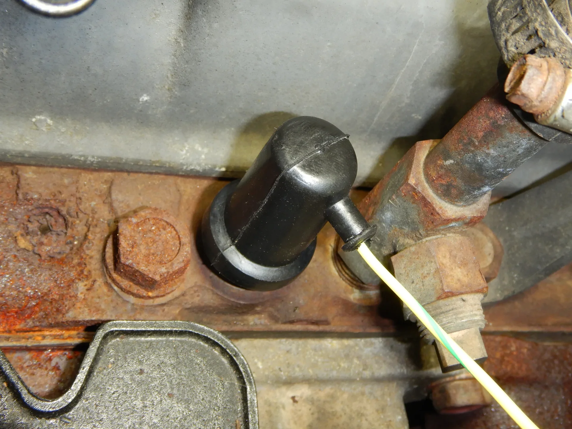

Wire #2 - Looks Green. Comes from the center of the firewall and connects to a plug in the top of engine. You can see it attaching to a plug just behind/underneath the rubber hose with the clamp on it. The insulation on the wire is gone in one spot an it looks very fragile. Wasn't sure about replacing it or just splicing in a new section.

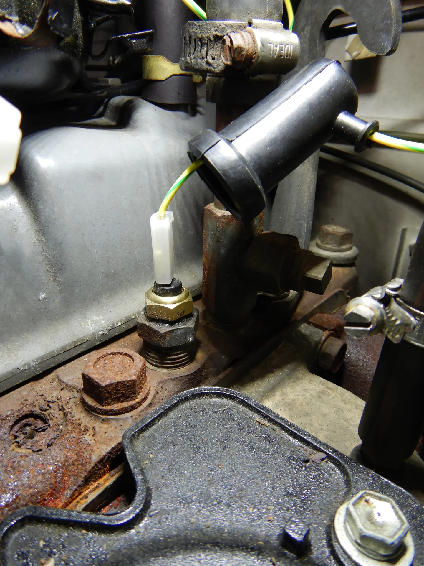

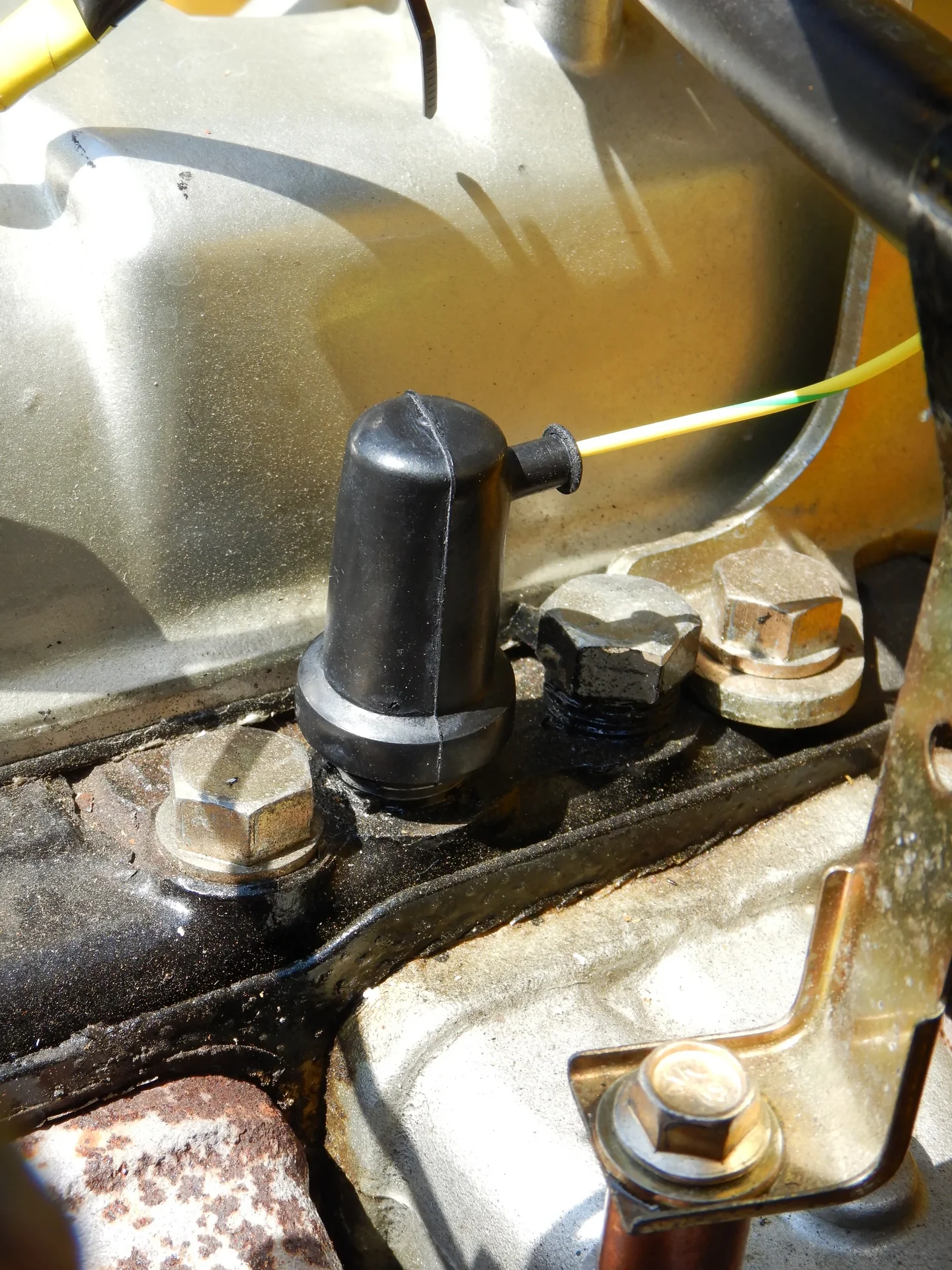

#2 is the engine coolant temperature gauge wire. it should go thru firewall with main harness driver side. @ToyotaMatt sells an awesome replacement wire kit.

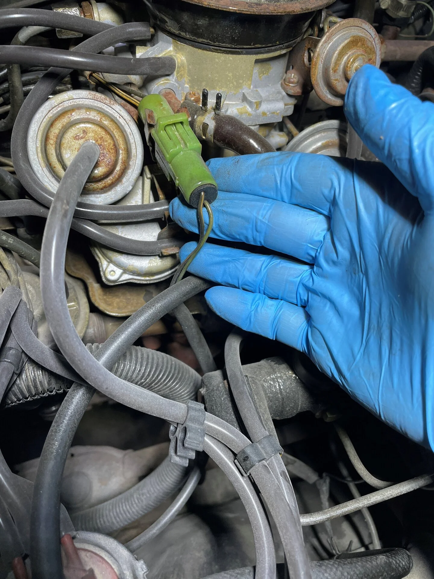

The green connector your holding is not related to either question.

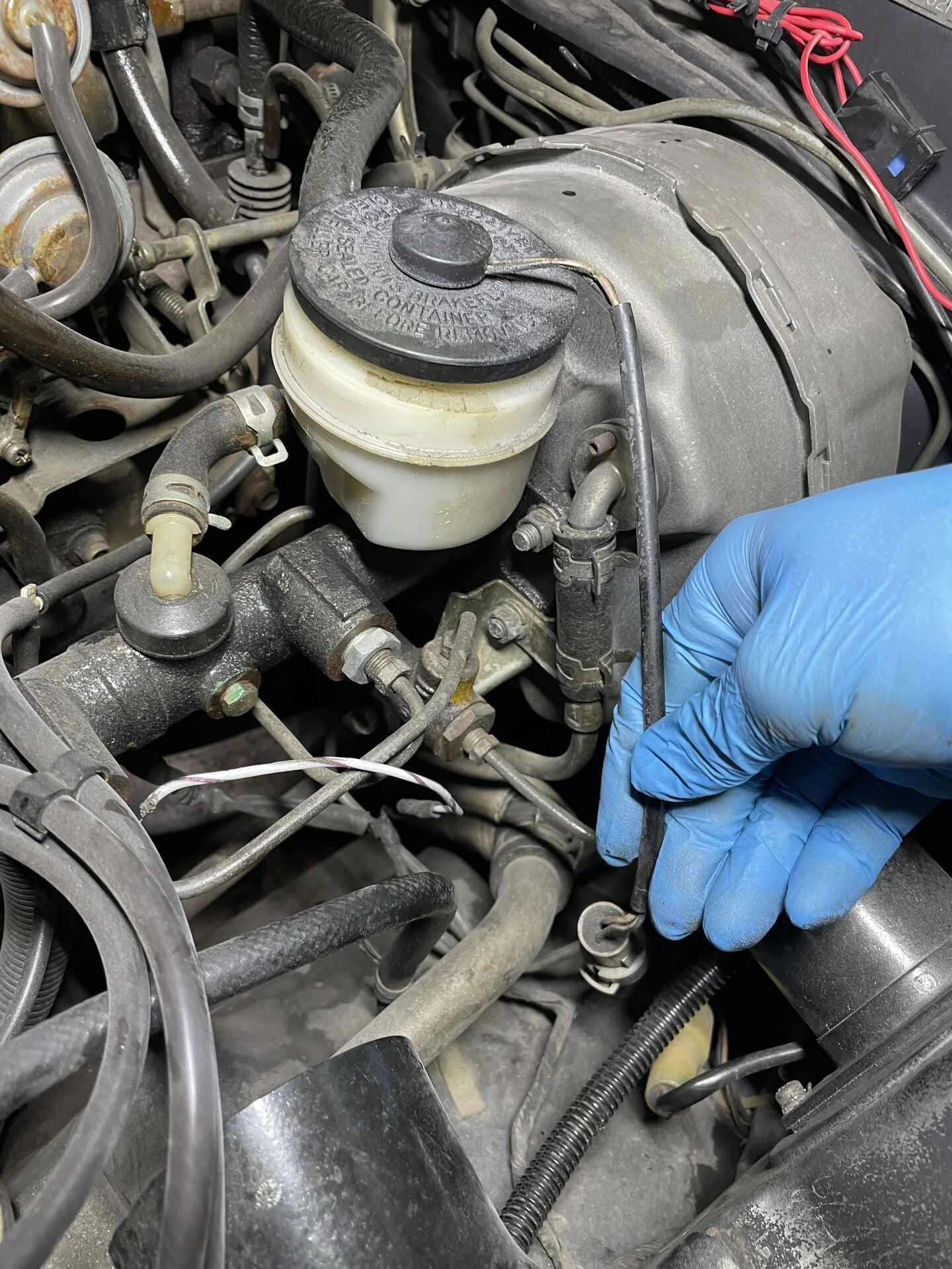

#1 is the low brake fluid light sensor.

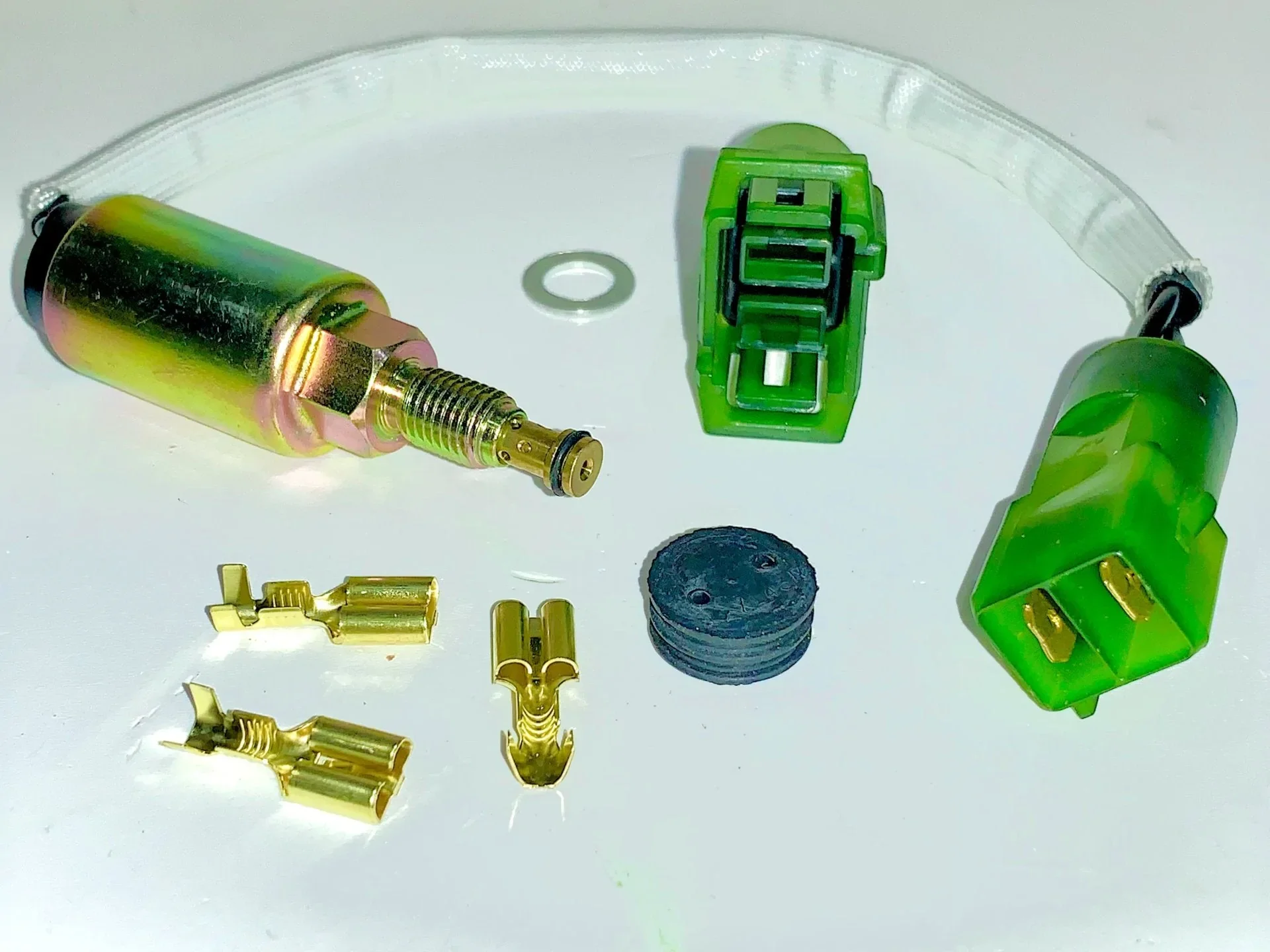

#2 is the carb idle solenoid
#3 is something aftermarket or some non Toyota repair possibly. I don’t recognize it off the top of my head.

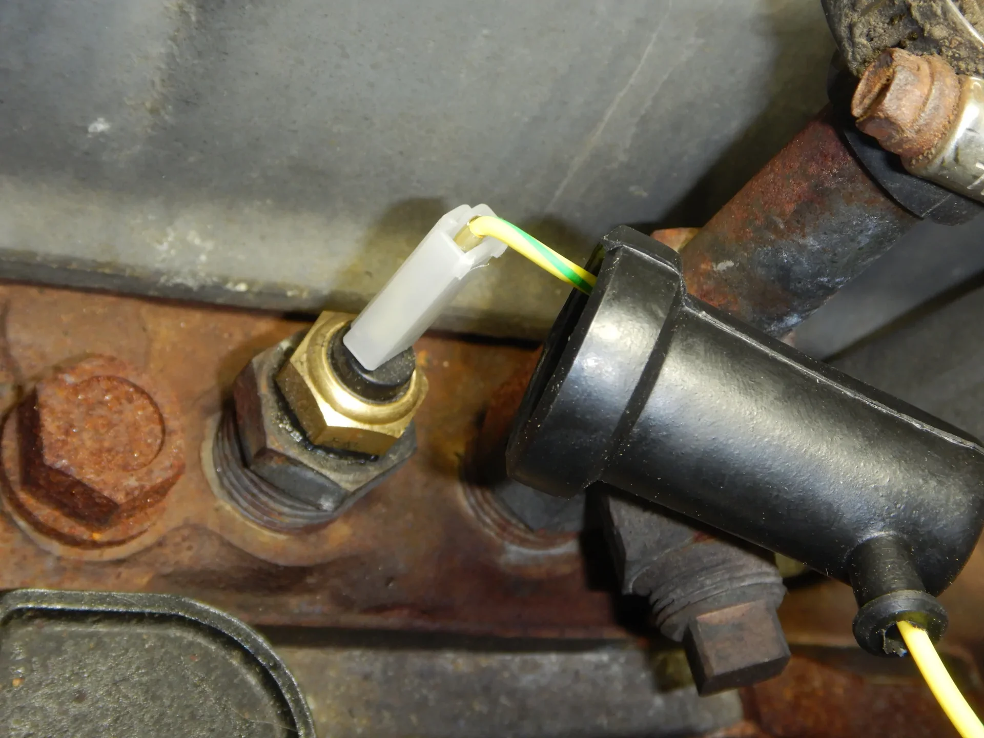

Looking at the 4th picture, that is the coolant temperature sensor going into the cylinder head.

I was not going by the pictures but buy your question. 2 questions 4 different wires. The last picture with the top of head showing a wire is 100% the temp sender wire.
wire #2 is Eazy Peazy solved :
See Below LINK and tech photo ....

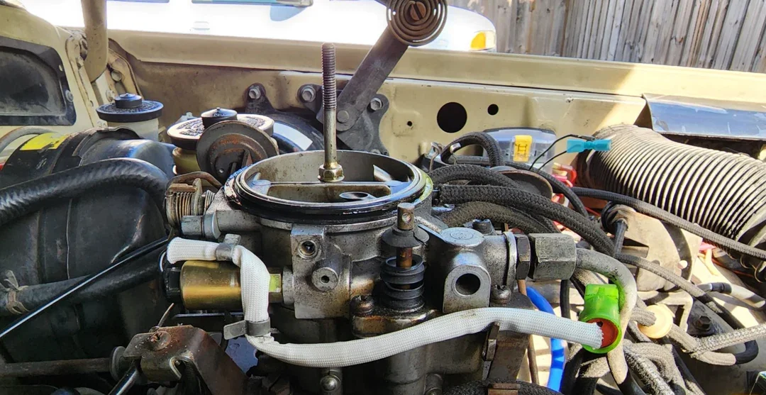

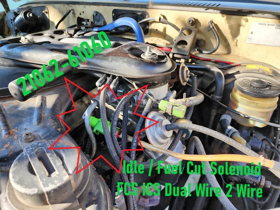

- the green 2 wire plugs connectors on AIR HORN CARB. are your FCS / ICS solonoid connection points
- see 2nd link and tech photos below please also ..........

Okay so the Wire 2 (green wire) looks like a splice off the main harness and runs to the coolant temperature sensor. It is a DIY job on that nice rubber booted connector you posted. So that is solved.

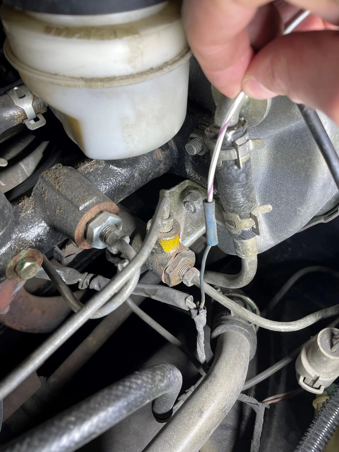

Wire 1 (white w/ purple candy cane striping) is a splice coming out of the bundle of wires running to this fuse able link up by the carb:
And to this low fluid sensor on the brake fluid reservoir:
It is spliced with a black wire or darker in color wire from that small bundle:
Someone suggested a sensor wire for the carb cooling fan, but I cannot see any place the wire would be broken off or where it should attach.

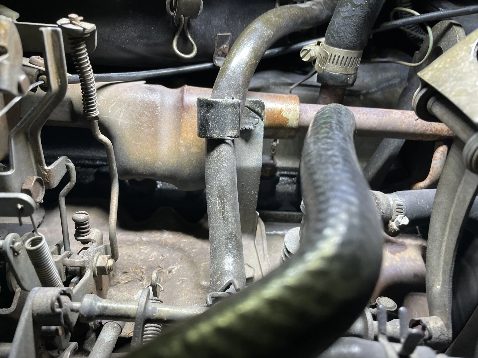

The cooling fan wire attaches to the exhaust manifold.

The manifold has (or had) a rusty thin metal bracket bolted to it that goes under the manifold to hold a little temperature sensor. The temperature sensor is (was) used by the manifold cooling fan to know when to turn off & on
On driver’s side, just rearward of center.
The cooling fan wire attaches to the egr inlet pipe and the sensor is very near the exhaust manifold. If someone has removed the EGR inlet pipe they may have removed the wire inadvertently. Also they DO burn away. They also need an insulation sleeve for protection.
Image of the EGR/PCV inlet pipe with the cooling fan wire mount attached:
