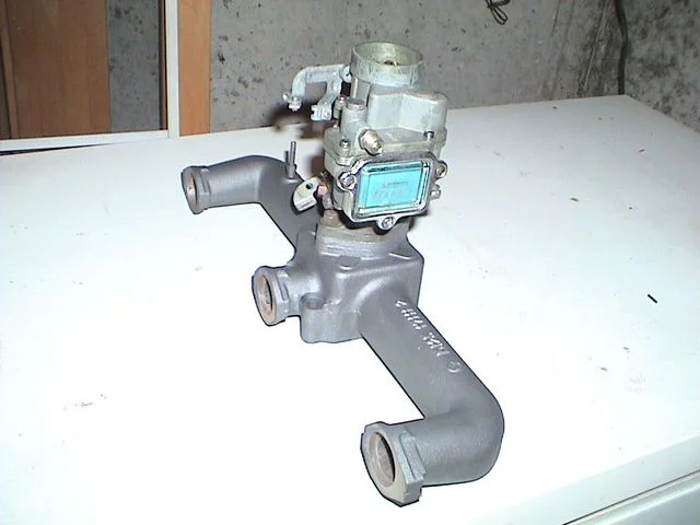

I guess I should note this is a 40 not a 45 but otherwise stock. I'll look on the carb and see if it has a build tag.
I looked at Bull's 67 LV that we know is stock and he has the round window. My 66 LV, with the square fuel door (66) has the large sight glass. LVs couldbe the bastard children though. Kipper's '66 that used to belong to Wes was stock. The F engine repair manual is printed September 1966 and shows the large sight carb. Is 66 the cross over year?
Pic of what we are talking about for clarification. Everyone likes pics. :D
This is from the Sept 66 repair manual and may confirm that 66 is missing the Aisin logo plate behind the glass. There are 3 types I have seen. Blue Aisin, Grey Aisin (not becase it was stripped off), and no plate.
The blue pics are from Foxfab's sexy 25 project.
