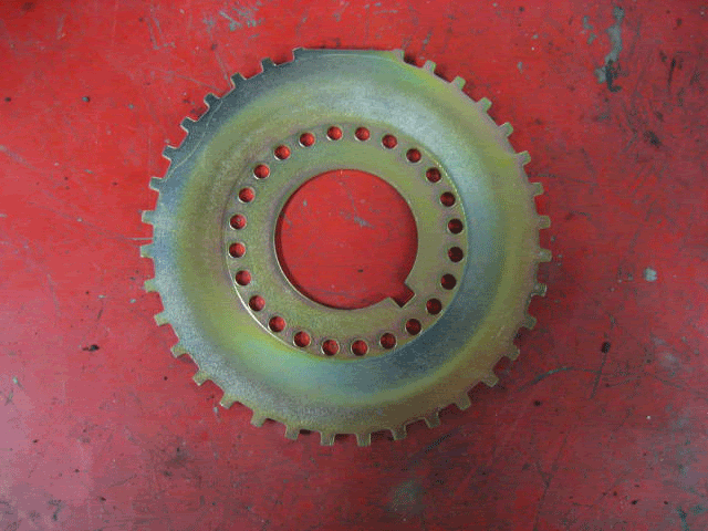

You should have them check the 36 +1 crank trigger for damage.
Looks similar to this.....
