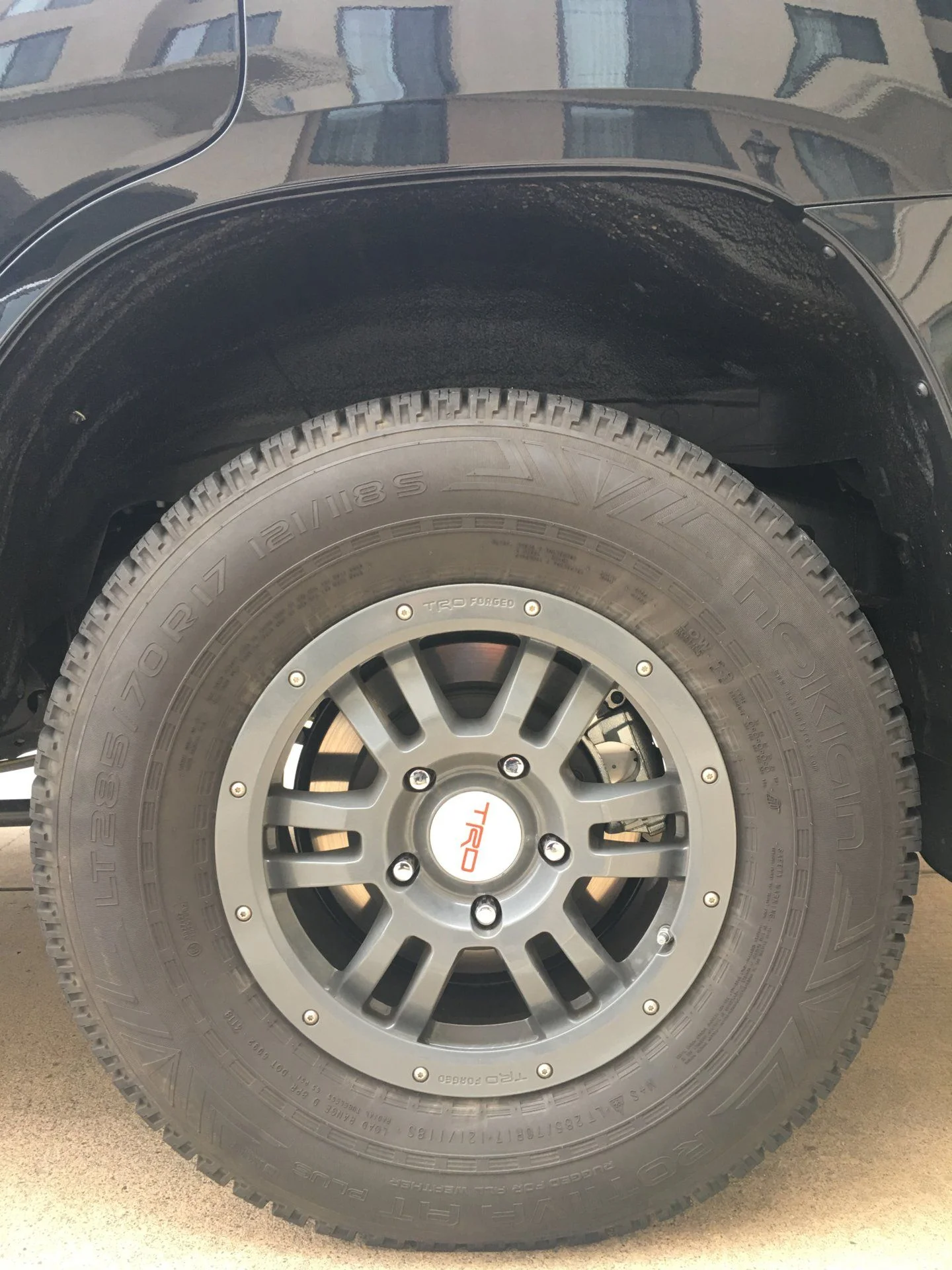

I run LT285/65-18E KO2s on a stock 2015 LC. The KO2 has the 3 mountain peak/snowflake rating; however in the winter, I run dedicated winter tires (275/65-18 Nokian Hakka R2 SUV) living in NW Colorado.
I run a slightly narrower winter tire because of increased performance in snow. If I did not have a dedicated set of winter tires, I personally would run LT285/65-18E KO2 tires year-around vs. LT275/65-18E KO2 tires year-around.

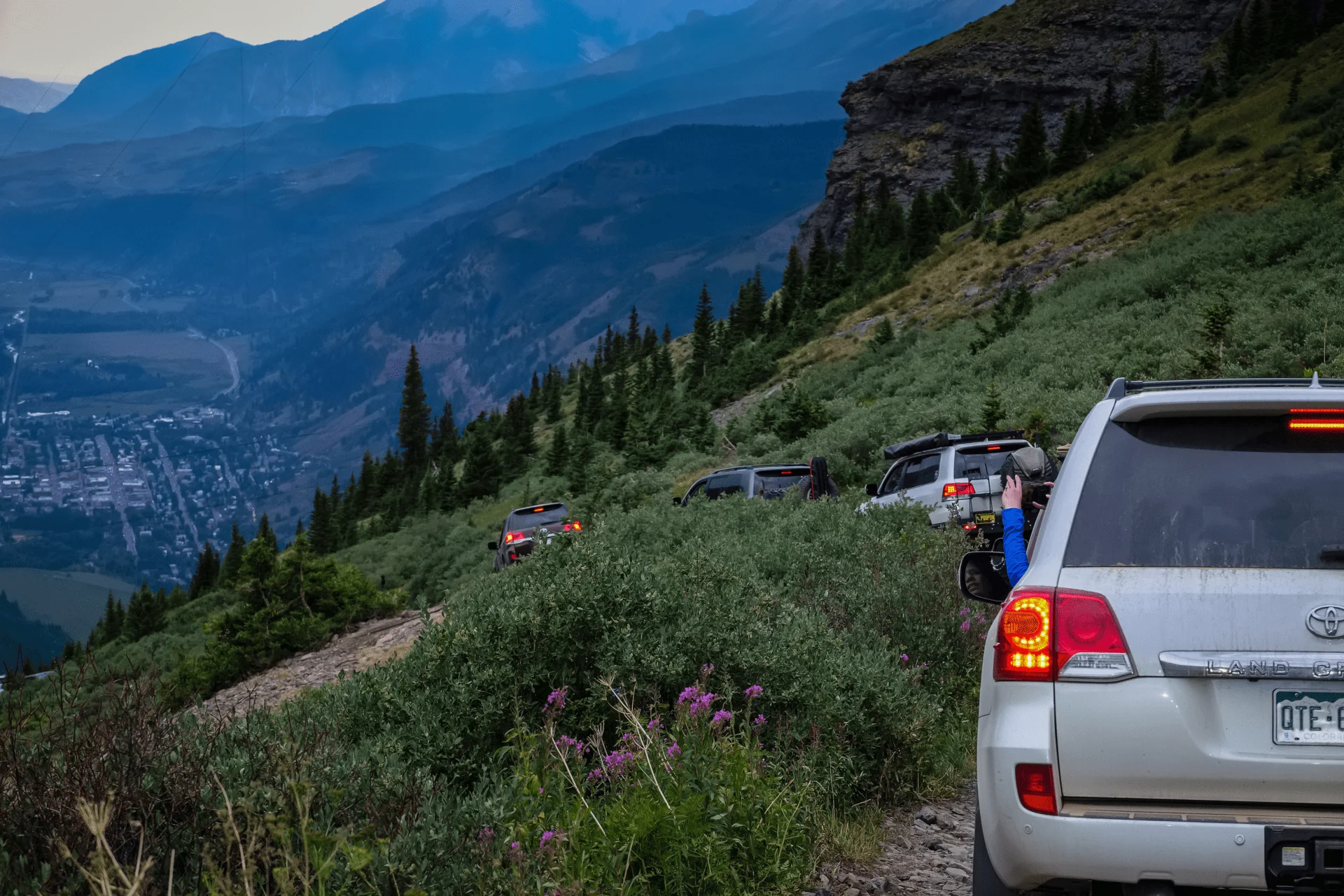

Here are a couple of photos of my 2015 LC (with LT285/65-18 KO2s) on Black Bear Pass

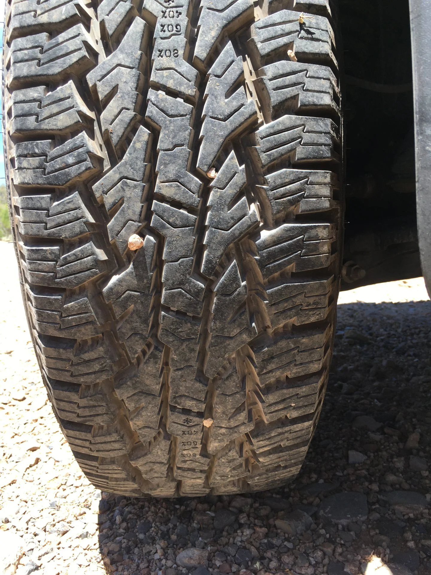

I have and love the Nokian Rotiva at plus tires. Mine are 17's on RW's but they also make them for the 18's. Link below.
nokian-rotiiva-at-plus
I looked hard at that tire...but it does not come in stock size. But yeah, that tire is pretty darn great! Strong sidewall, highway friendly.
How’s the road noise?
Please post pics!!!
Please post pics!!!

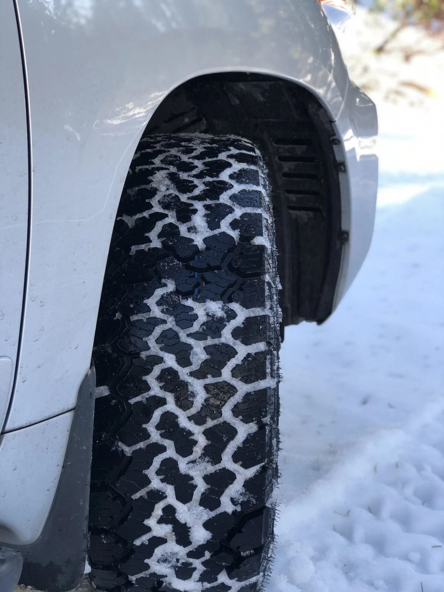

Road noise is minimal with somewhere around 10,000 miles so far. Great in the rain and snow. Also worked very well down in the desert.
On my 2013 I just switched from Michelin Defenders to the General Grabber ATX. Kept stock size and went with LT285/60/18. I Was looking for a severe snow rated all terrain and wanted to try something new, different then the KO2s. Very happy with them. Hardly any more road noise then the Michelins and they ride well on and off road. Wife’s happy with them too.
