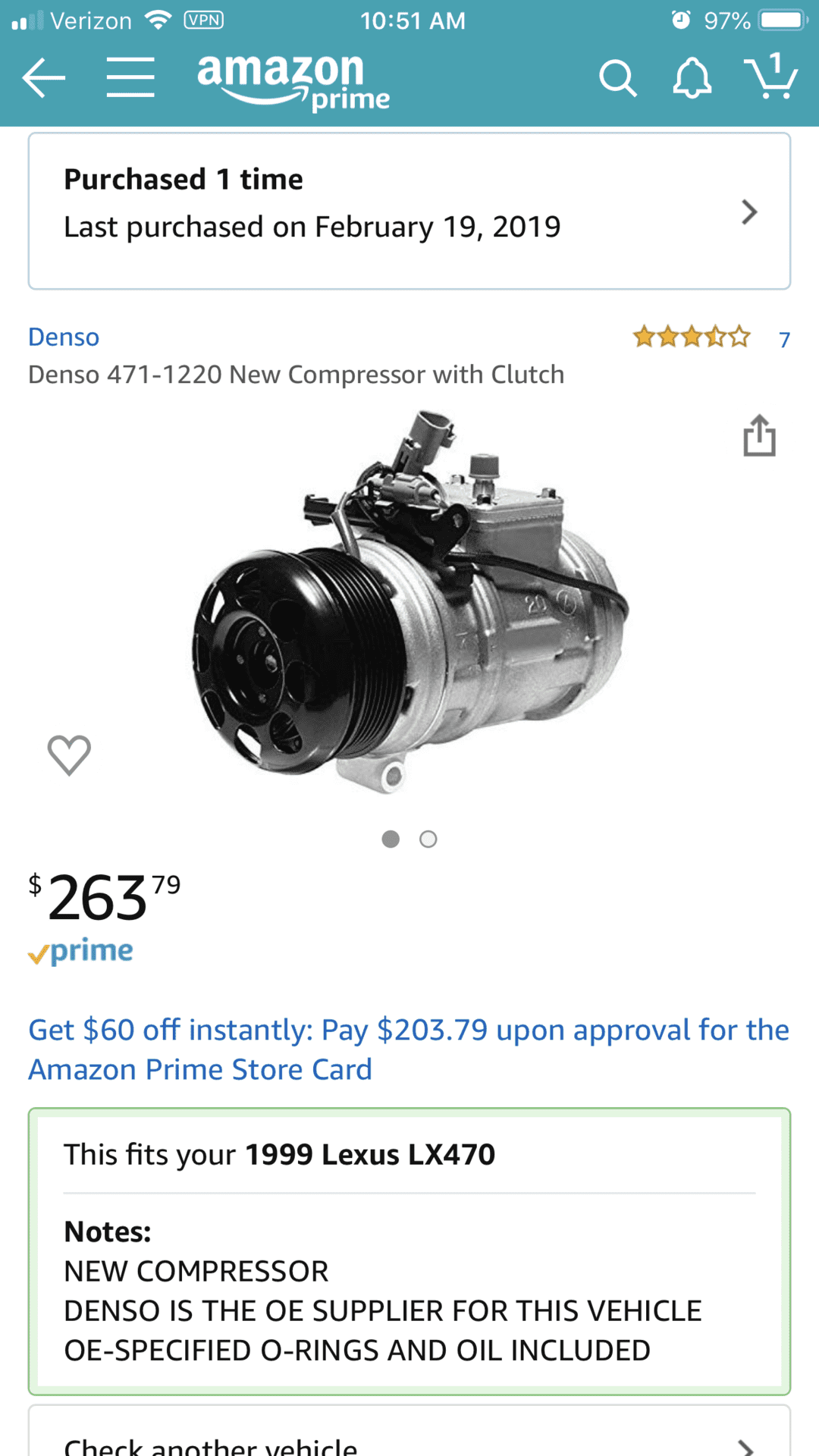

I was quoted ~$500 from a radiator shop in Waco, TX because we were on the road when it went out. They couldn’t get the part that day so they were able to get the compressor going again and I just didn’t turn off the car until we were completely done for the day. Amazon has the Denso compressor for $263. Your estimate seems way high unless you live in downtown San Francisco or something.

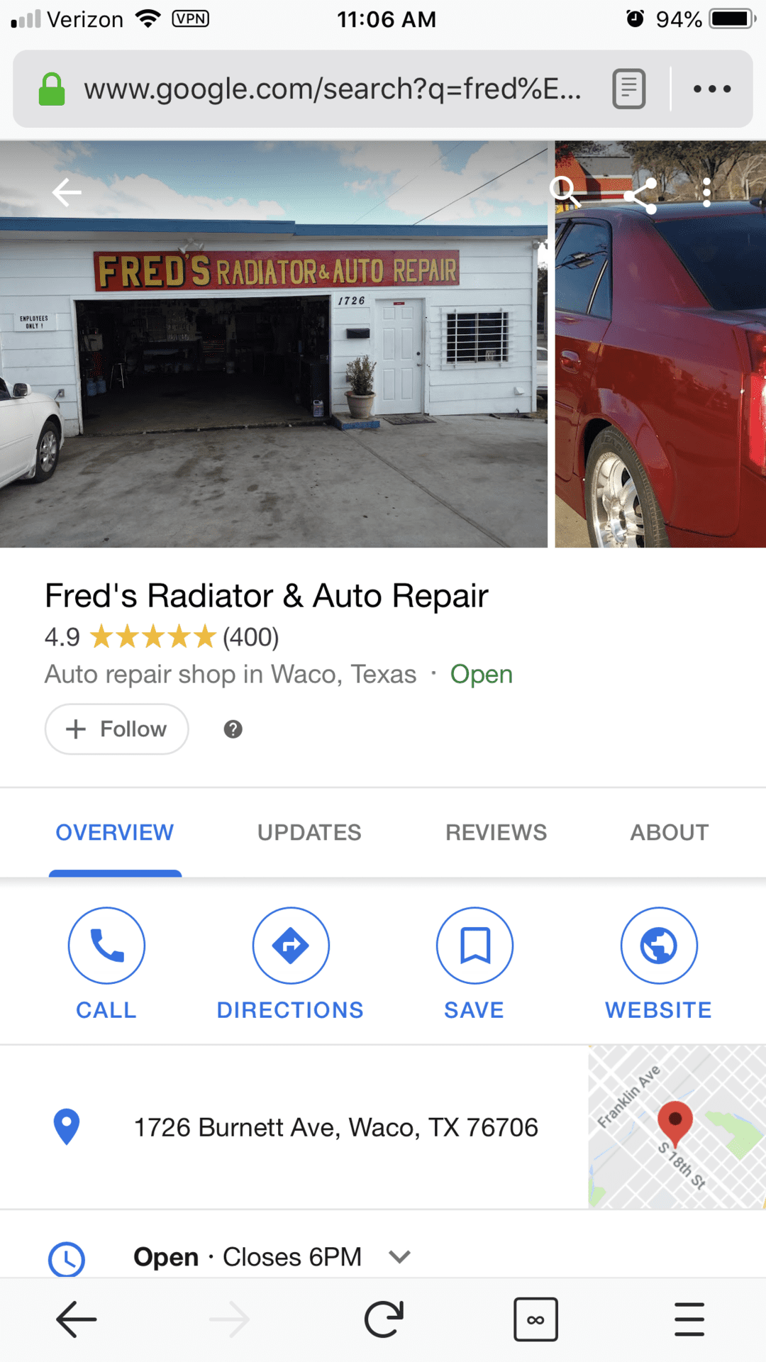

Holy sh*t I just saw your location is Waco lol. It was called Fred’s radiator shop. Go to him! Kinda a hole in the wall but he struck me as honest and reliable based on my visit.

Question was about condenser, not compressor.

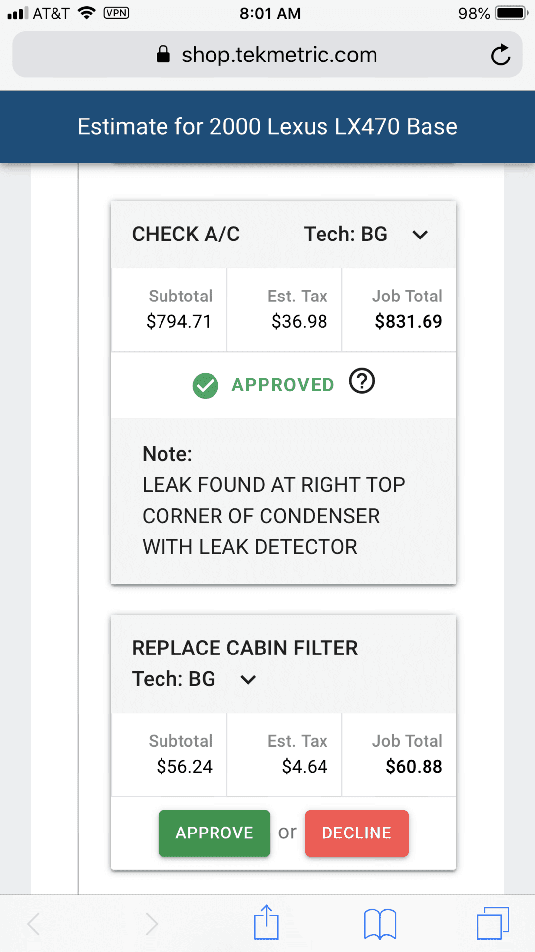

With shop markup, you are going to pay about $300 for the part, $150 for the vacuum and recharge, and $350-450 for the labor. So the price is not out of line for shop work.
