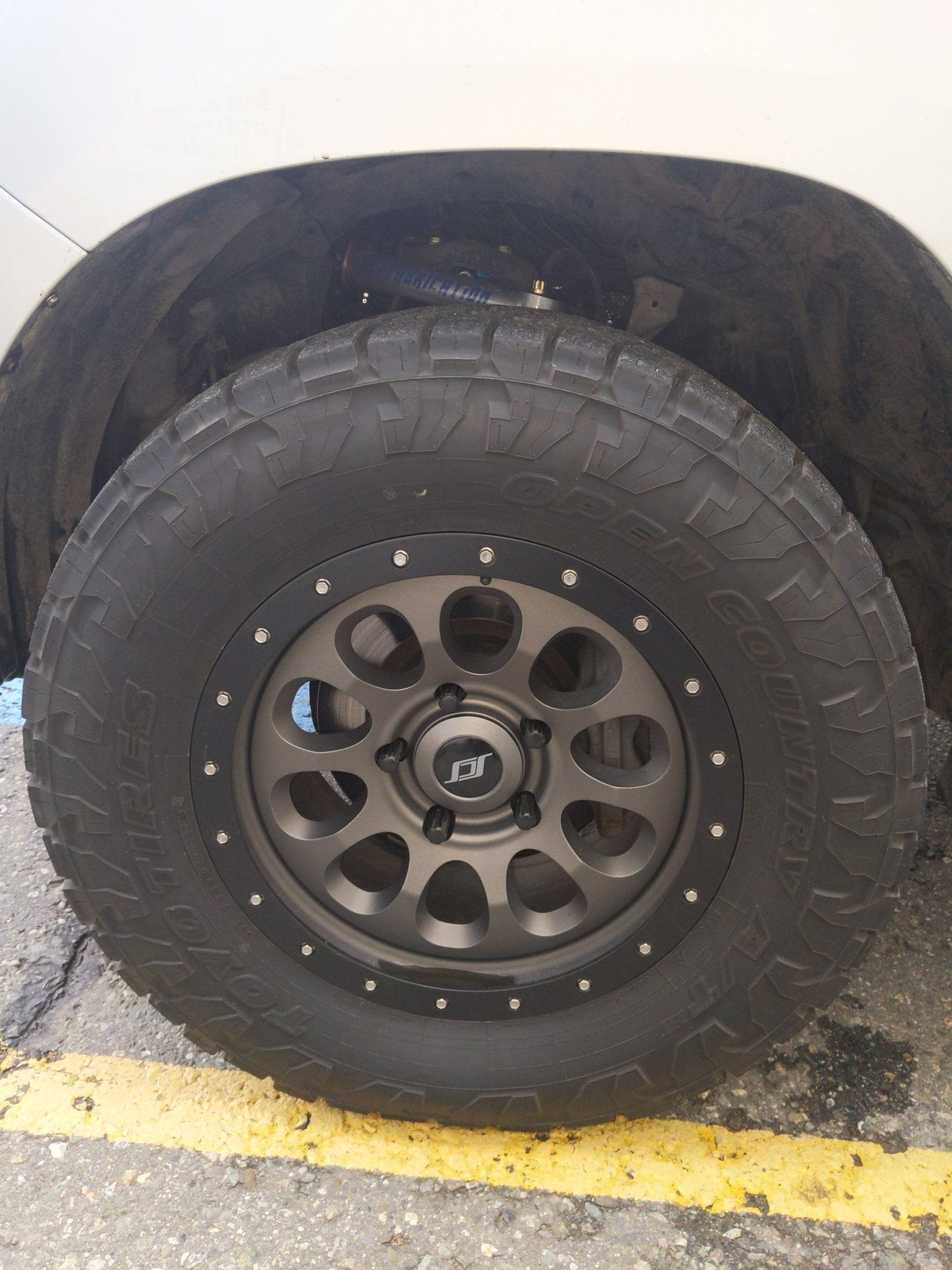

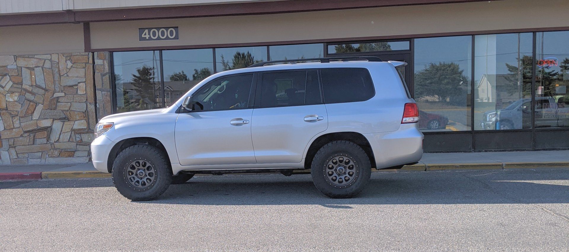

I know this is a old post but if any one looking for a AT tire, I've got the new Toyo AT3 and it rides great and looks good too, I'd recommend them. I live in a 4 seasons area and was looking for the 3 peak rating. I have falken at3 on my 4 runner now and I like them but I like the toyo at3 better.
Road noise is not bad at all and does great in rain. With Ko2 I had some hydroplaning over a certain area to our cabin and tested with toyo at3 and it did great. I had Ko2 previously and it was louder. I have 2 sets of wheels and swap them to my toyo mt for more technical trails. Toyo AT3 2nd is falken at3 for me

Any more shots of your truck with the SCS’s?

Looks great! Big fan of those wheels, looks like you have UCAs, typical questions:
- any rubbing? cutting or trimming required?
- lift?
I have king's 2.5 with total chaos uppers. fronts was 2.5" lift but it settled a little under 2". I don't want to add any more preload so I might add a Toyota coil spacer. I have the 2720 rears about .5 lift, at the time I didn't need a heavy duty spring but I just recently sold my truck and I picked up a teardrop trailer and hauling more with lc I will swap out rears here soon . But at the moment it rides great, soaks everything up.
Trimming was just around the front inner fender liner and removed the mud flaps.
@RUMble907 The Kings instructions say no spacers.
