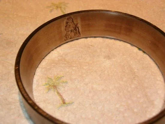

I did have a wheelbearing failure long ago with the FSM approach. Don't know if related or not.
attachment.php
Here's the thread: https://forum.ih8mud.com/80-series-tech/38087-unexpected-wheelbearing-failure-2.html
