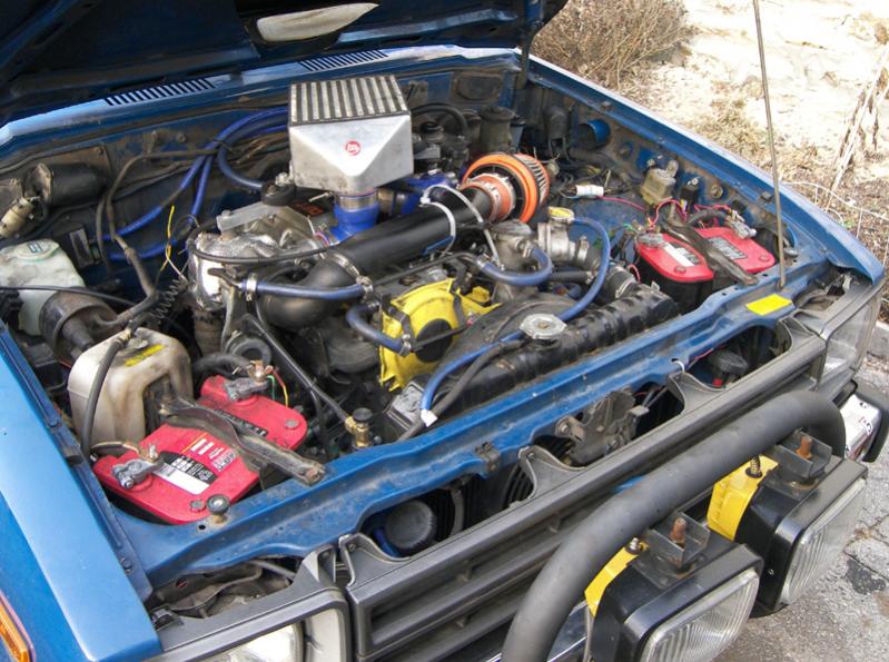

A pic or two:

Hmm, perhaps this is worth looking into. There is a small amont of oil in the IC. But I assumed this was from the valve cover vent hose that goes into the intake between the air cleaner and the turbo. I have temporarily removed this, at the suggestion of my mechanic, to see if the oil consumption gets worse or better. Perhaps I'll clean all the oil ot of the ic, etc., leave the vent hose undone, and see if I get oil all over the inside of the thing again. A bad turbo seal would be a lot easier to deal with than a re-ring... Thanks! I did rebuild the turbo myself, there was a deal a guy was offering on ebay where if you buy the rebuild kit, he would balance the shaft for free, I may have fuct it up, we'll see.
