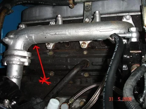

I took off my manifold to determine where the rad fluid was leaking from and this is what I found , it looks like one of the casting holes has produced a leak.
What are my options to plug it,I have limited tools where I am right now,tap and plug is the best option is there any other options,anyone know the size of the hole so I only have to buy one tap bit and plug.
Yes I will tap and plug the others just in case.

I guess your leak is between Nos 3 & 4 cylinders on the head. IE here ........(when looking at my B engine):
Here's a pic of the B/2B head gasket too. I was going to work out which part was in the vicinity of your leak but it is too difficult for me now what with the MUD site malfunctioning so much lately (preventing me from searching information easily).
Actually I took this last photo a few days ago for comparison reasons. (The genuine Toyota MLS gasket is at the top and one from Engine Australia on the bottom).
A temporary "fix" with a plug sounds reasonable to get you home or wherever.
(I would just plug the one that's leaking and ignore the others.)

If you look in those holes it appears to be a round sleeve going up and down. Maybe a sleeve for the head bolt. Sleeve could have rusted through. Do you have any coolant in your oil? If not then plugging it should work. I would keep an eye out for coolant in your oil after plugging it as it may force the coolant in another direction. I have 2 used heads from B motors if you need to replace the head and if the B head is the same.

I noticed those holes when I put the head back on my 3B. Thats not a sleeve you are seeing but the side of the head bolt. I would make a small wager that you have a leaking head gasket.
Tony
Yeh Kynot62 that is where the head bolt passes through the head which probably means the head gasket is on its way out , at this point I am going to shallow tap the hole and plug it so I can make it home , I have no water in my oil and not sure if I will have the head bolt should seal off any water on both ends of the bolt assuming the gasket is only leaking from the water journal to the head bolt hole in the gasket.
If I remember correctly the only place the bolt seals is at the head gasket, I think the threads go into a blind hole so there is nothing to seal at the bottom. If you can just limp your way home without plugging that hole.

But if you look at that picture I posted of the B/2B head gaskets, I think the 8 larger holes that are in line at the top of each gasket are where the pushrods (for the rockers) pass though.
So if you look between the first 2 pushrods on the left you'll see two smaller holes. I think the top one of those is the headbolt-hole through which that rusty water is escaping and the one directly below it (next to the bore) is the coolant passageway where the water is coming from.
So .... having worked this out, I now change my mind and recommend NOT plugging the hole.
The reason for this change of mind is .....Look how close the bolthole is to the pushrod holes! (So plugging that hole is very likely to force the coolant to burst into one of those!)

I have seen those 4 holes in the past, thought they were odd, but thought nothing more of it. After reading your post, and seeing the photo of coolant leaking out i decided to have a closer look.
Apart from the 3B in my wagon, the only other 'B' type engine i have at the moment is a 14B-T in bit's. I realise there is a bit of a production gap between the two engine's, but the 14B-T also has those 4 holes.
The head is off the engine so its easy to see what the deal is. Those 4 holes in question (drilled horizontally) line up with 4 of the headbolts (vertical of course). The 4 horizontal drillings actually go further into the head than where the headbolt passes through.
Normally with the head bolted on, looking into either of the 4 holes you would only see part of the head bolt. But without the headbolt in the way you can see the inner most end of the drilling is plugged by a small cup type freeze plug. No doubt that small plug is leaking.
