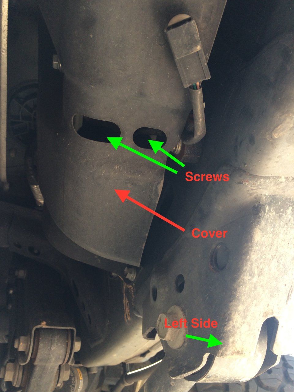

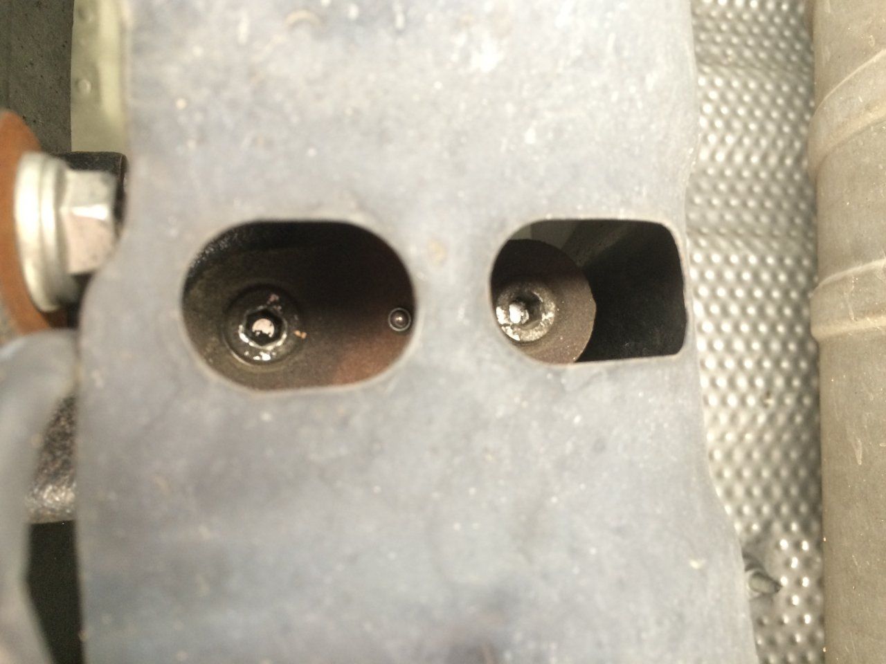

The dealer is wrong...unless you have a VERY unusual 200 series. All the 200s in the US came with KDSS.
Here's where you should see it under your truck... I took this photo for someone else a while back who was looking for the adjustment valves.
This photo is taken from under your left passenger side (I have my running boards removed in case it looks weird...)...
Close-up of the holes in the above photo...
The arrows pointing to screws & cover are pointing to the part of your KDSS system where you can make adjustments (don't turn those screws without instruction though!). If he is telling you 200 series don't have them? -You might want to find a different service department. :)

This is exactly what i thought im going to get under it in the parking lot when i pick it up. Its funny because they seamed to have knowledge of the system but totally flop when i bring it, lol.
Murkuson is exactly correct. If you want to fix that lean park on a flat surface, reach up there with a 5mm hex drive and release those nuts 2.5-3 turns (NO MORE!!!) jump on the running boards and give it a good shake. Close the valves, done.
Since you're in RI, check for rust. If you're not sure post a picture here and we'll tell you how to proceed. don't try and brake them free with force if they're rusted.

Just to be clear, at least on my 2014 it's located on the Drivers side. Did you mean you took it from the passenger side, just pointed at the drivers side?
