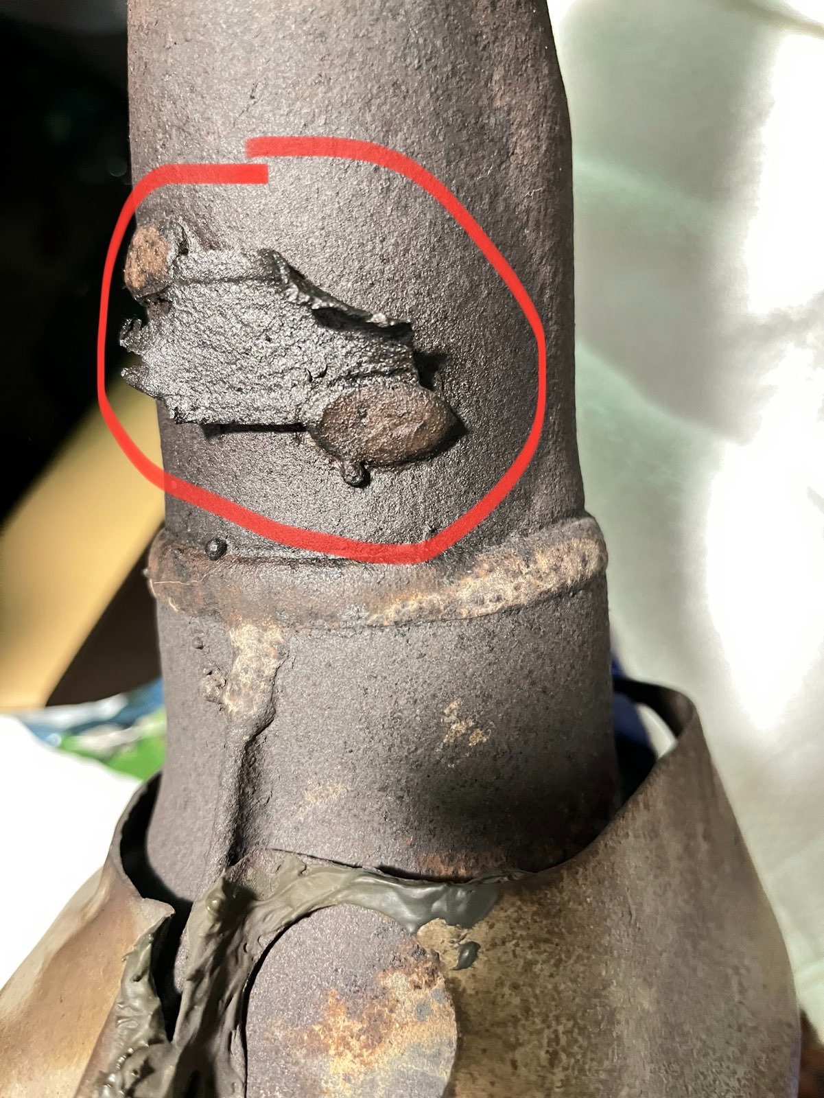

Does anyone with an OEM y-pipe/cat recognize what this is metal piece is (or was) on the pipe? It's directly opposite the O2 sensor.
I was about to use the wire wheel on this to clean up spots for welding. I don't know if I should grind this off or what. Looks like two spot welds holding something in place. I don't know what's going with the cat shield and the repair paste. I might be opening a can of worms here.

Don't recall that on any of my stock exhaust pipes. Looks like some sort of part number tag. Something else appears stuck or melted to the end fo the cat??
What/why are you welding, a new O2 bung??

Yeah, it seems like a metal tag maybe that was welded on for some reason.
Not sure of the O2 bung condition yet. I have a crack in the crotch of the y-pipe and need to figure out if that paste around the edge of the cat is really covering a very long crack. The previous owner has this stuff all around the perimeter of the heat shield. Both cats are like that for some reason.

Pretty sure that's where the original heat shield was welded to the pipe. After the tacks broke loose, my heat shield hung low like yours and rattled all the time. New aftermarket exhaust doesn't come with that shield.
Grind off the tacks and clean it up if you like.

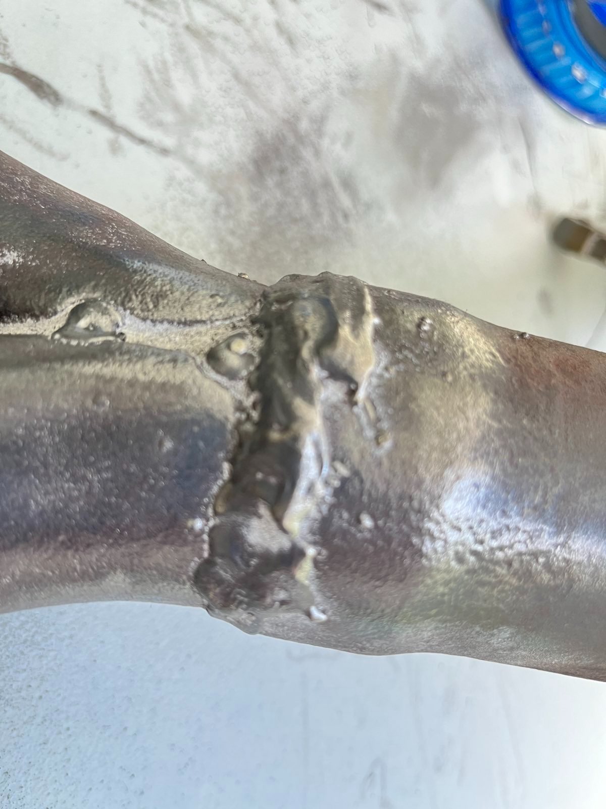

I paid a guy $20 to weld the split at the wye on mine and it held for 7 years and was still intact when I removed the down pipe and installed the Magnaflow.

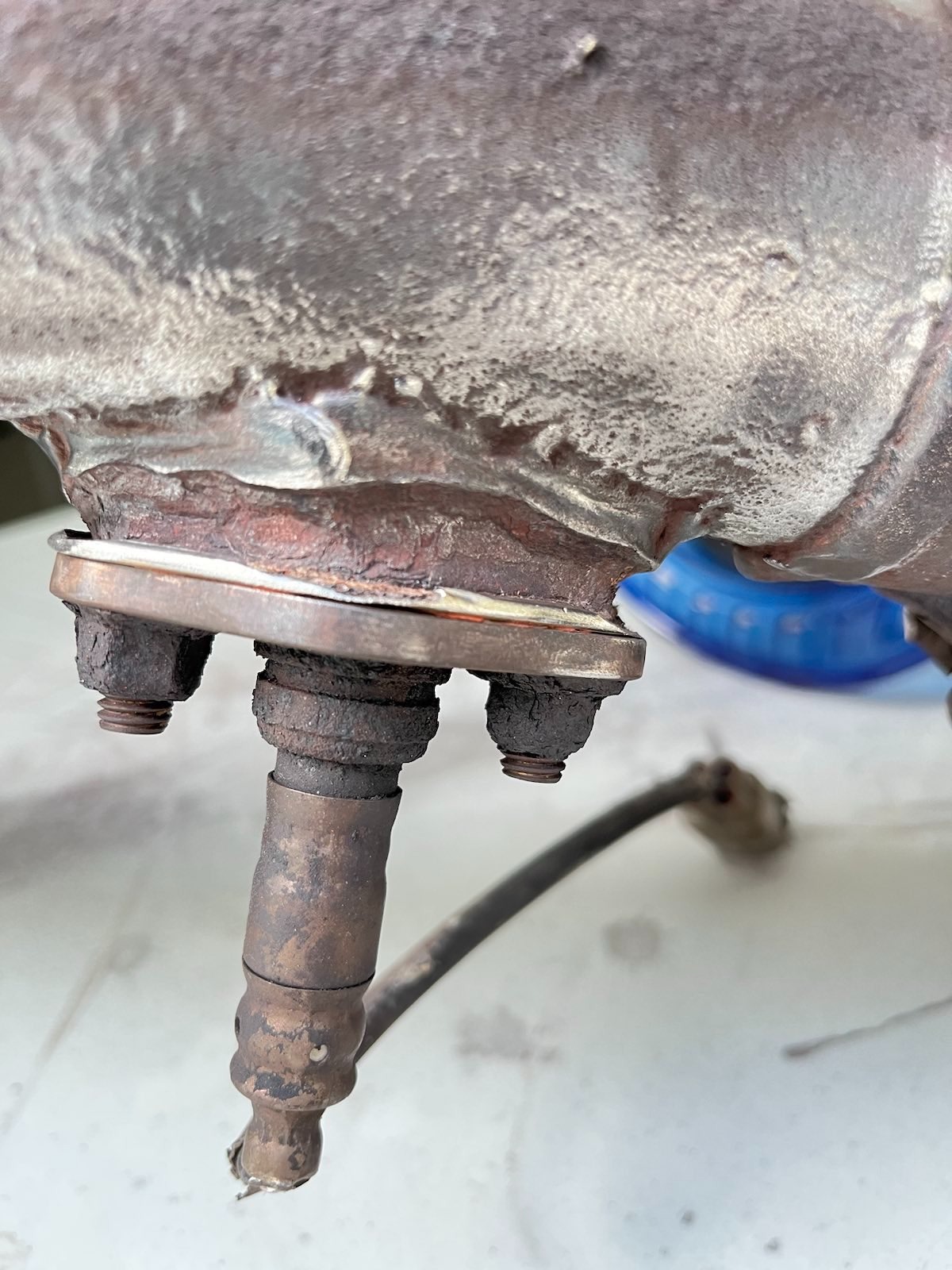

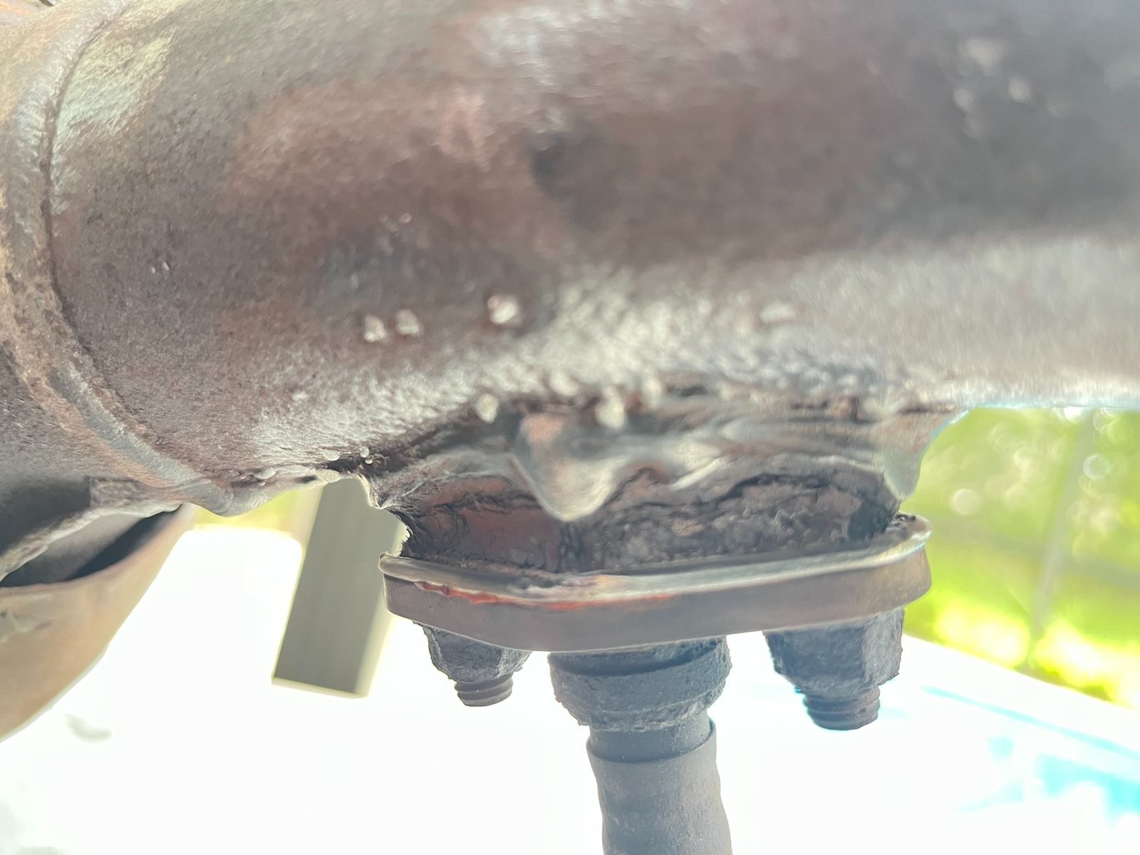

Anyone have experience having something welded after the original weld failed?
I cleaned things up and it seems worse than I thought but I really don't have experience with exhaust repair to know for sure. I see several repairs on the y-pipe.
Time to suck it up and replace?

They may not be pretty welds, but if they're not leaking or cracked then they're fine.
I deal with welding every day and I see good stuff and bad stuff and bad stuff that still works for the application.
Most exhaust shops are NOT professional welders.

Only the joint of the Y is leaking from what I can tell. Maybe a good welder can grind that part off and patch it up. The unknown is if anything else is leaking too. I used a leaf blower and soapy water to test. I could have missed something. Would be nice if it could be pressure tested somehow.
The leaf blower is good enough.
They won't grind it before they burn it in and they won't use 309 SS wire on it since stock is 409SS tube.
Just pay the $20 and get on with it. I'm normally anal about that stuff and they guy I took it to did a fine job. Or, I should say his 15 YO nephew did fine welding it. I watched them do it, kept my mouth shut (for once) and they did ok. I could not have done any better with the tools and access I have, so it was good. It still outlasted the cats.

After looking carefully, there's no reason to replace this thing. The bung is leaking too and it appears to be more weld than steel. I didn't realize Slee sold a replacement and I have that on order.
That will give me some time to figure out what over-sized stud size will be needed for for the manifold hole someone drilled out and did not thread. Might get lucky and a regular bolt will fit flush.
