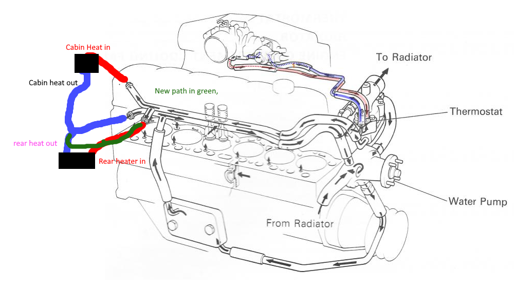

You don't have this connected right. look back at the blue circle on the right BY THE FIREWALL in my earlier pic and move it there. Really all you have to do is follow the hoses that come off the pipes that come from under the truck. It just makes sense to close the loop. I also second the motion to top off the radiator and burp the engine.

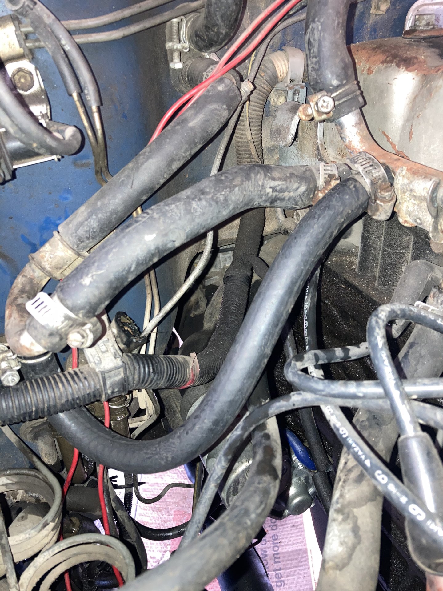

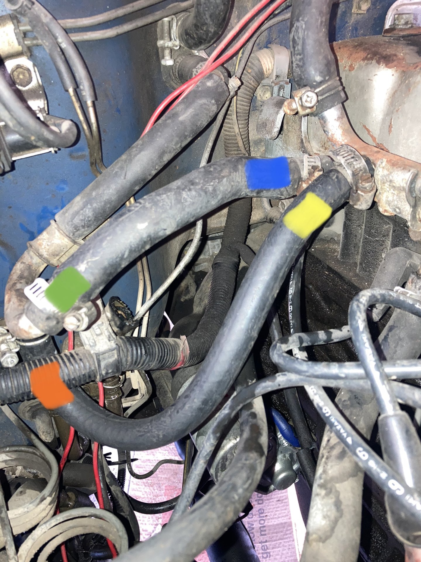

Attached below: should i switch blue and yellow? or orange and green?

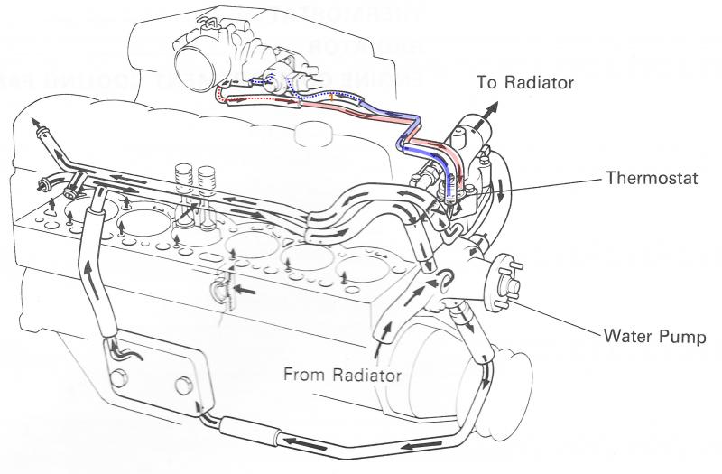

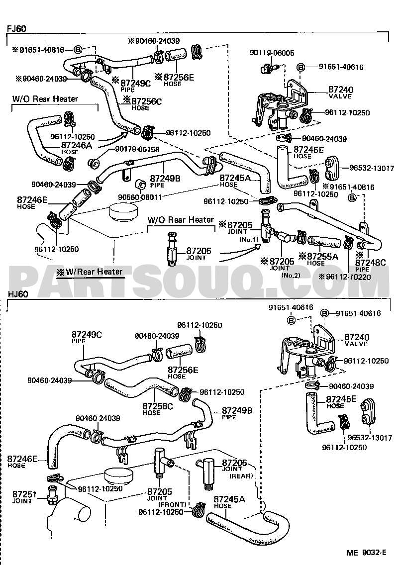

Lets try this another way. Here is a FJ60 diagram of heater hose not sure if it is different for a 62. 87248C is a hard pipe that goes along the firewall behind the motor. I think you need to connect bypass to this and the other end to the small downward inlet on 87249C right there in the U shape.
So i’m in my engine bay and i do not see 87248c behind the motor. i only see 87249c which i have the bypass plugged into the bottom inlet into the metal pipe running alongside the engine.
is the beige engine bay firewall metal rod what you’re referencing?

Hol' Up, OP has a 62 and we're using FJ60 Diagrams. FJ60 and FJ62 have different cooling passages, FJ60's loops around the back of the head and the FJ62 does not.
@fj62steve It looks to me that you have the correct loop in place for a FJ62.
Verify this by checking to see if your interior heat blows hot still, But it makes sense to me in the way its looped.
I’m starting to think i’m going crazy over here hahaha. I have the truck running on full heat but i do not feel any heat. But i also never use the heater so not sure if just doesn’t work but it should.
I cant tell by your picture really what line is where, Follow the lines and make sure you have an inlet and outlet, Feel the heater lines, make sure they're hot. Its possible your heater core is just really dirty.
What you have looks like this I think.
Im now 89% sure this is what you want.
Here's my super high quality bypass guide.

View attachment 2917032View attachment 2917045
Great diagram!! I’m pretttty sure that’s how I have it connected. Unless there’s something you can see that I don’t. Green line is from bottom of the U shaped hard line right?
Thats right,
Its strange because the route has two inlets and one outlet, But that's how it was plumbed before but with the rear heater valve to block the coolant circuit when it was not in use. I think the best way would be to get brass plugs and seal off the rear heater's inlet and outlet so you get more flow control for your cabin heater core, How it is now should suffice though.
I was wondering about this. That's why I mentioned this earlier..."not sure if it is different for a 62". thanks for catching this.
