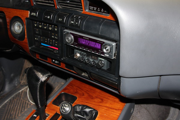

I have the Uniden 510XL and it has worked great and fits in the ashtray slot on an 80.

510XL or 520XL both fit in the ashtray location (with a little trimming). I have the 520XL and it has worked well for short range comms.
for completeness, they only fit in '95+ 80's ashtray (which i read you have)... i guess smoking was more popular starting in 95 cuz the tray is WAY bigger. i have a '93, i put my 520 in the second DIN slot and just leave the mic cord off not in use. i had to pigtail the antenna conn even for that. and for a cb have been happy with it. IME swr tune and good antenna connection means more than cb model.
