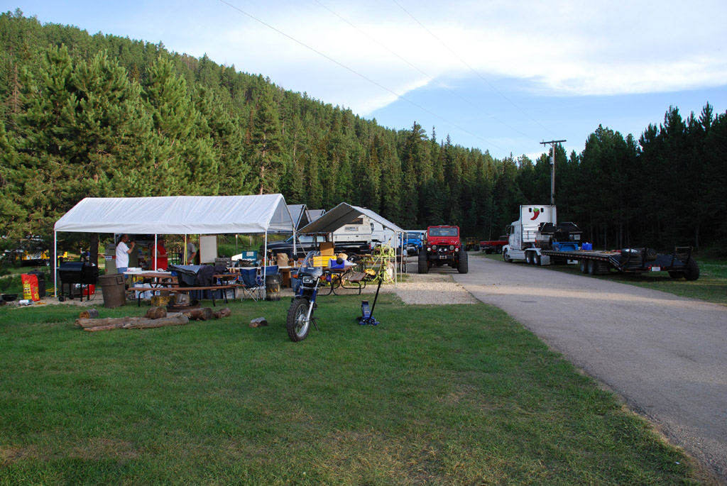

It is not used as a tow rig, but rather, a support truck. It is just another means of transporting tools, spare parts and anything else we will need with us. It also worked well this year as a workbench.... ;) after picking up a 5.5" Wilton vise and some other goodies from Mike at Shoener Machine & Tool Supply in Rapid City, and making a mouting plate for it to slide into the receiver.
The tow rig is off to the right in this picture:
There are a lot more pictures of the trip and BHCC event that will be at Mindcrater.com in a few days.
