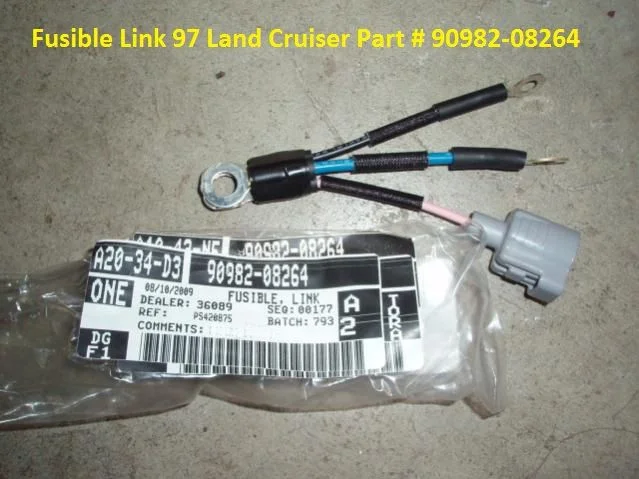

Please keep in mind that fusible links are not regular wire. They are inline fuses with a silicone jacket to protect the downstream subsystems.
There should be 3 fusible links off the positive battery terminal. 2 run to a junction box and 1 runs to a circular grey connector. Each one protects a different subsystem.
Are fusable links something you can buy after market ? Or would I need to go to Toyota?
Fusible links PN is 90982-08264 and should be $10-15 from dealer or online.
For the dash lights, did you check all your fuses? Probably just a fuse, or another fusible link.
Replace the whole link.
