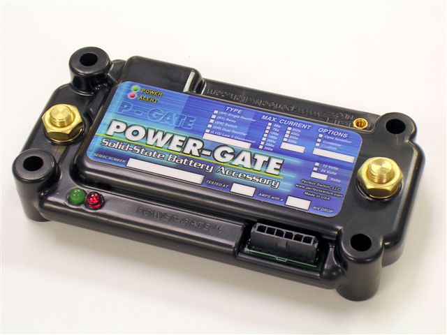

I only want the best .... period. So I am a bit of a nut when it comes to researching things. After speaking with a guy from Perfect Switch (Power-Gate) ... who was very generous with his time, I am 100% sold on their product.
Having somewhat of an engineering background myself, albeit mostly audio, video, and electronics related ... I kind of get what these guys are doing. I do not want any voltage drop in my system nor do I want to install anything that will generate excessive heat. I do not believe that any of the other battery isolator systems can make that claim. Also, I believe systems like the Hellroaring and National Luna take a different approach to handling dual batteries which is not best suited for my application.
Their approach reduces voltage drop and heat buildup to a point where it is no longer an issue. These are by far the best systems I have found so far. Due to their design approach and quality engineering, their systems are popular with mission critical industrial, commercial, and aerospace clients.
I want a totally isolated battery for my electronics gear and refrigerator. I went with their new Dual Isolator design for 100% isolated operation and will install a Momentary Switch for jumping the batteries if ever needed. This is a clean, simple, and reliable system that is perfectly suited to my needs.

Wow....where do I begin.
Firstly, you confuse criticism with actual performance specifications.....I simply call it like it is.
Secondly, we've NEVER offered a 90 day warranty period, it's ALWAYS been a year, and you'll not find anyone on the planet who will tell you their warranty expired and the guys at POWER-GATE were jerks about it. Why would you purposely try to mislead your fellow Land Cruiser enthusiasts???
Thirdly, we don't build a "clone". A "cloned," HR device would have heat sinks and a massive continuous current rating of 80 amps.....we play in a different arena. When we weren't manufacturing battery isolators, and had no intention of manufacturing battery isolators, we too had heard good things about HR, and it's not out of the realm of possibility that if someone asked our opinion about battery isolator options, we said, "hey, take a look at HR....we've heard good things about it." No doubt, the HR is a neat product and there are happy customers like Beo whom vigerously cheerlead on HR's behalf. However, when we created an isolator for a customer a few years ago, we did so on a fluke, and the performance shocked us.....it was nothing shy of brilliant. But before you start a new business venture, you do a little homework and make sure you're not re-inventing the wheel....make sure someone else isn't doing EXACTLY the same thing. We looked at lots of different devices and walked away very confident that what we'd prototyped in two weeks was novel, unique, and allowed for handling levels current unachievable by other products....including HR ( and Cole Hersee, Sure Power, Vanner, etc...).
Part smart, part lucky, we moved forward with refining the concept, persuing national and international patent protection, and here we are today with both single and dual rectifier battery isolation devices that are just simply more efficient than anything else out there.....and I don't say that out of arrogance or contrite sales jargon, like our tennis ball is just better than their tennis ball. There are no heat sinks and no airflow requirments for POWER-GATE. HR is built on a platform of aluminum extrusion...not because it looks tough....because it gets hot.....you do the math. That's not a criticism, that's a fact....the specs bear that out so why sugar coat it?
Your suggestion that POWER-GATE is an HR clone is offensive to us and soooo far from the truth, it's absolutely laughable. Hey Beo, what if we take one of the 300 amp devices we're currently making for NASA and de-rate it down to 80 amps, strap a pound of aluminum heat sink to it, and cut the price to a hundo-and-half? Would you love us then? Probably not. People ask us direct questions and we provide direct answers. We don't lie. We don't fudge. We don't mislead. What you see is what you get. You want a 200a device, we're going to send you a device that can handle 200 amps all day, every day, with no heat sinks, no air flow, no fuzzy math, no de-rating clauses, no spin....just a sweet little semiconductor package.
For those who are in the market for a battery isolator, do your homework, consider your options, consider your budget, then choose the device that will meet your application requiments. POWER-GATE is not for everybody....just as the HR device isn't for everybody.
