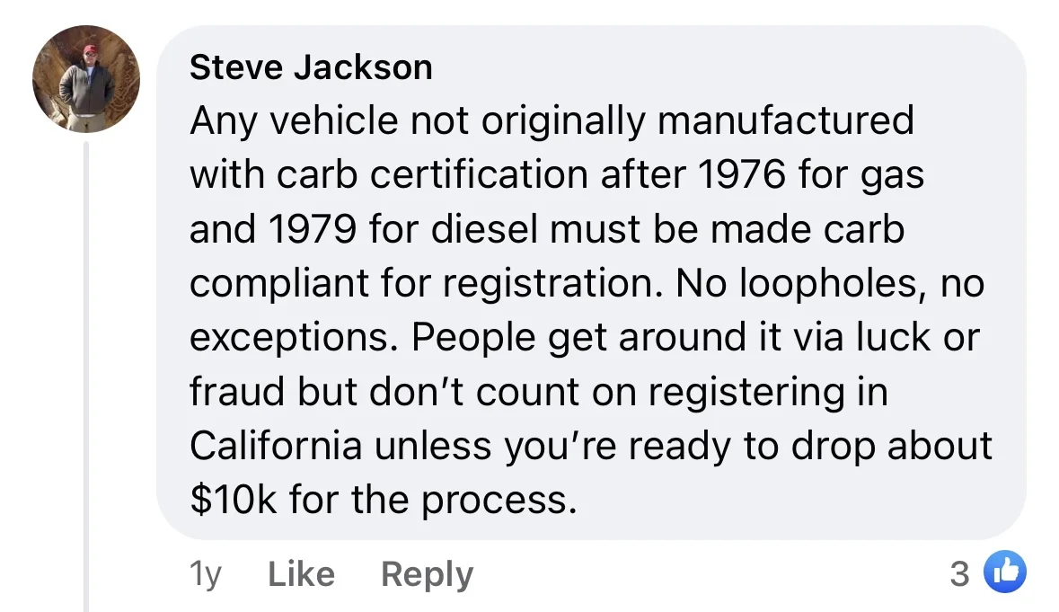

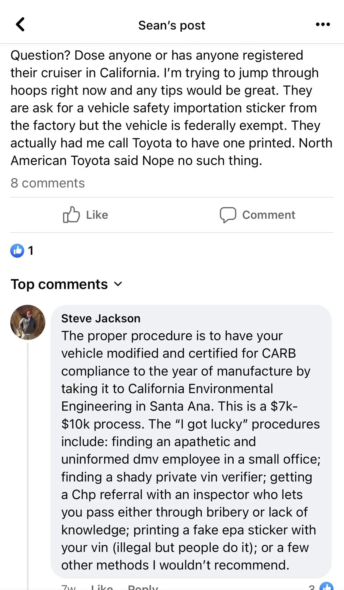

Thanks for all of the great info as far as cali goes smog ref-ing into something some other platform is a difficult process the fact its a diesel and that in 1992 diesels were smog exempt are the only real positives but they still may not let it fly.
how difficult is it to acquire one of those other. motors? i don't have my heart set or the rig for what its worth i can easily back out of this if the thing cannot be registered here it means much less i'm suprised nobody has chimed in about the cali registration issue ¯\_(ツ)_/¯ thanks for the link i willl have to take a look
For California registration I mentioned a bit above that it won’t be cheap easy or quick.
I tried to link from FB but it didn’t work. There are some good FB threads that give some more detail in the 70 Series Land Cruisers - North America group. If you join that group and search California registration there is more info but here are some screenshots below with some good info from there. There is also more info if you search the VM in there.

There is next to zero chance you are getting that registered in california if it hasn’t been registered before.
