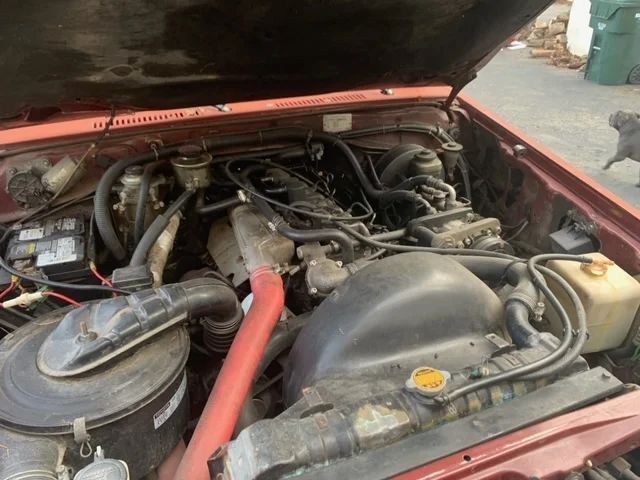

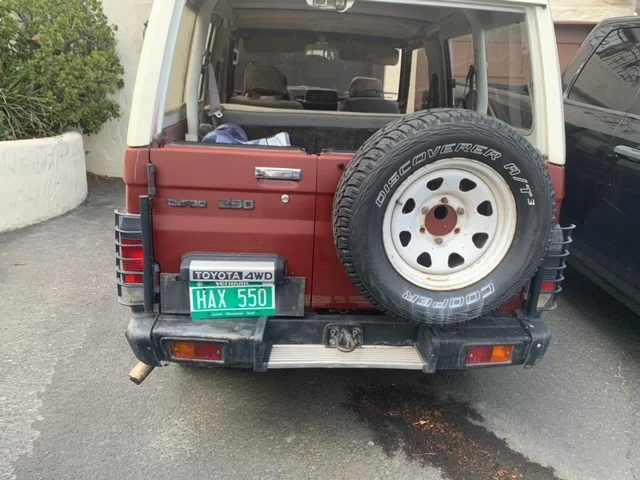

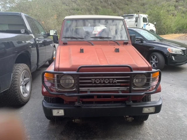

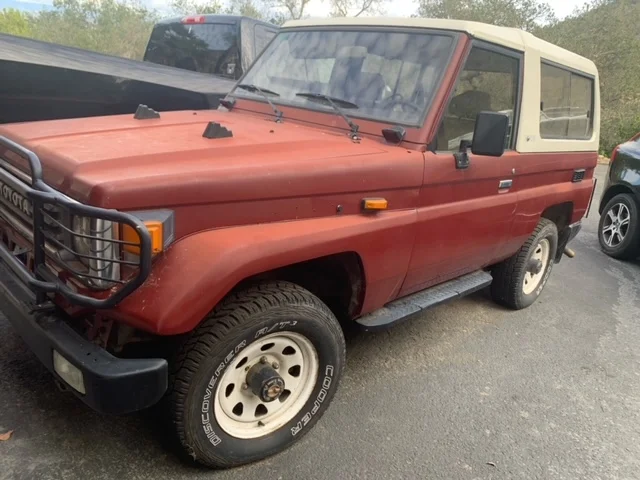

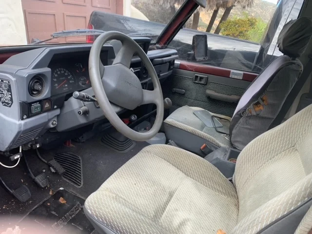

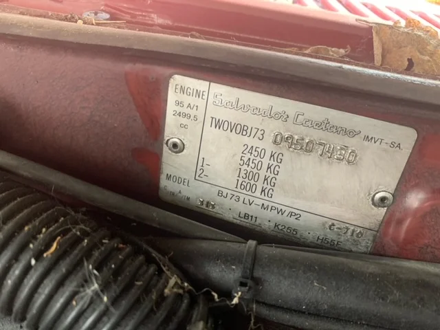

Here are some pics of the rig i did get it started and drove it 15 feet
more pictures i have not verified the cracked head / gasket situation is this thing registerable in cali?

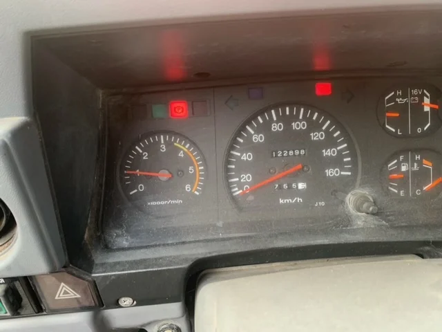

according to the speed-0 the thing has 65k ish miles i would be inclined to make it live vs. pulling its heart out.

are the light guards and bumper guards factory ?? what about those wagon wheels?
the tag does say bj73 the motor is a 4 banger turbo is it safe to say that is not the original motor?
the P.O. did say it was imported from spain
Unfortunately that is the VM Motori engine, likely the HR 588. They have a reputation for being very unreliable due in part to their individual cylinder heads causing head gasket problems. Most, if not all, of the VM powered Cruisers that get to the States will get swapped eventually.
That said, there are some really good things about that rig. It looks fairly clean from a rust standpoint, has AC, and has the removable door tops and folding windshield, which is pretty rare. Being LHD is also a plus in the US.
The last builds of the BJ73 were done under license from Toyota in Portugal, using the VM engine. The rigs were sold pretty much only in Portugal and Spain, on the Canary islands and some in France. So yes, it is an original build.
There were some accessories available from factory, but the bumper and light guards are most likely aftermarket, I guess.
Wheels (rims) are factory.

The truck appears to be complete and has some rare parts on it.
It has rollcage and rear seats. That's also rare. Most trucks were setup as vans w/o rear seats.
Doorcards and even the carpet look good and I don't see much rust. (Please share some pictures of the frame and undercarriage, axles, knuckles, tank, brakelines, underside of doors, wheel arches.)
Check for the AC compressor: R12 still or already converted to R134a?

Yep, vm engine with a pretty bad reliability record.
Has 5 cylinder heads, they tend to leak/blow and are genuinely unreliable. Need a special jig to allign them properly. Its not worth the time and money to fix only to have to fix again. According to some sources: 98hp at 4000rpm 162tq 2600rpm
There is a reason everyone swaps these. Basically they are junk and unreliable.
