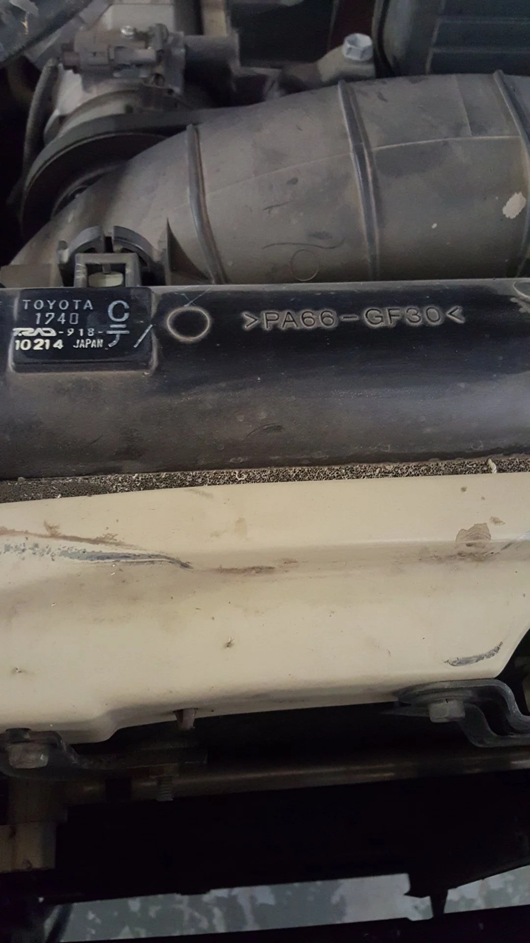

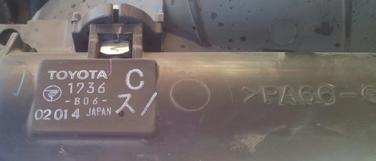

Here a pic of the top tank numbers.View attachment 1031294

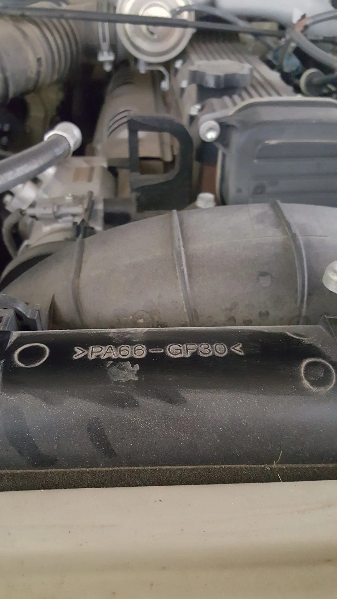

Could you check the rest of the numbers please ?
This is mine 06/ 99 HZJ75 (now HDJ)Troopy.
I compared it with 2 x 2011 and a 2013 HZJ78 and they are the same
The part number ends in 1740 and according to Toyodiy that radiator get the same longer bottom radiator hose ?
Does this mean I got the longer radiator from the start ?

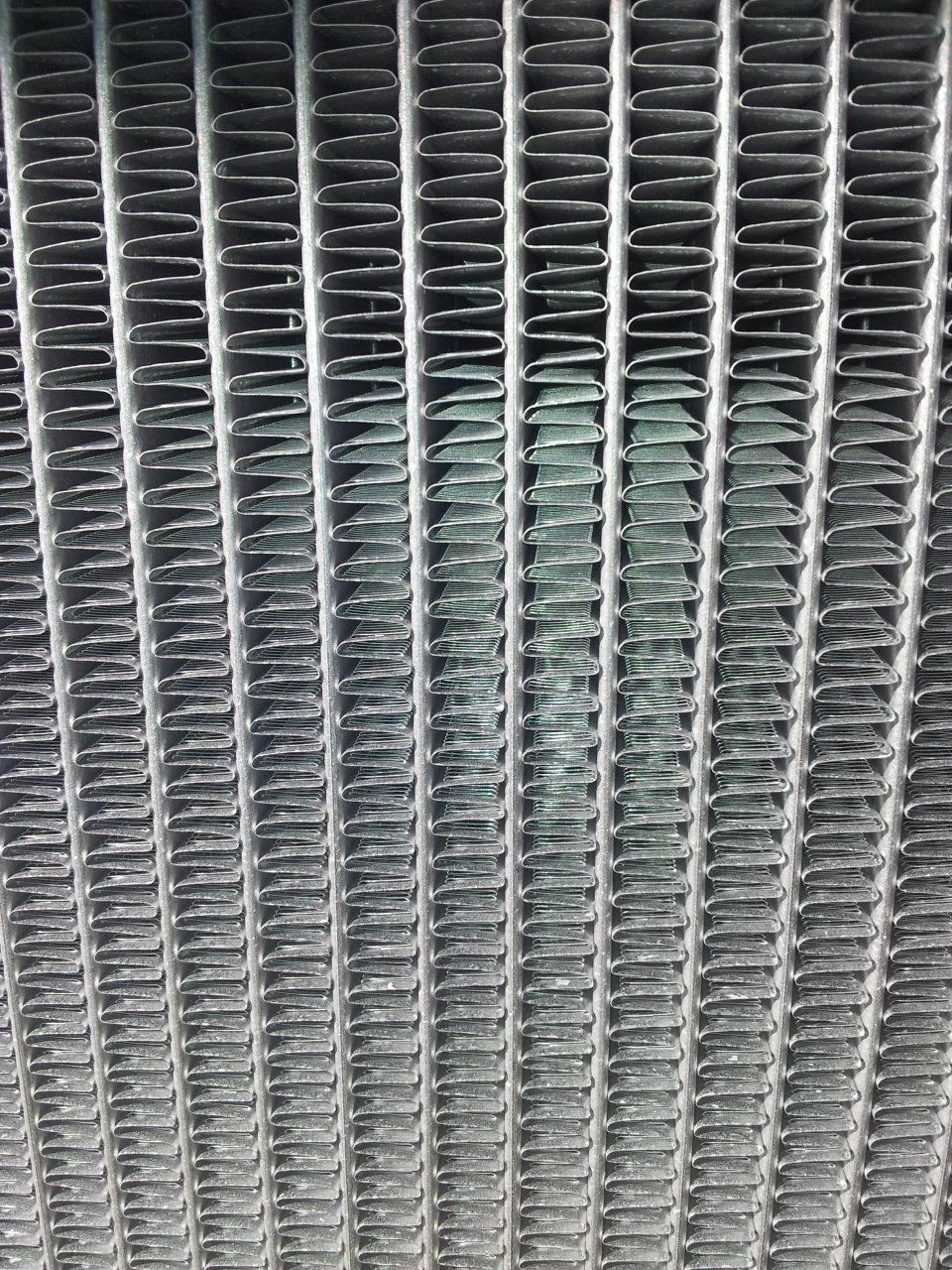

Old radiator: has 43 vertical bars/rows or how you call them
New radiator: has 59 vertical bars&rows and they are thinner than on the old one

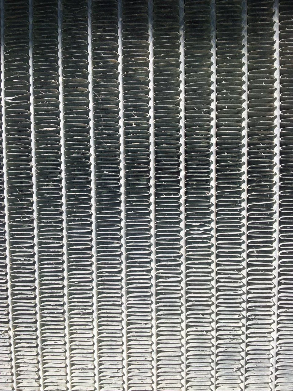

Old radiator: ribs are regular
New radiator: ribs are super fine, looks like they would have much more surface than the brass radiator ribs!

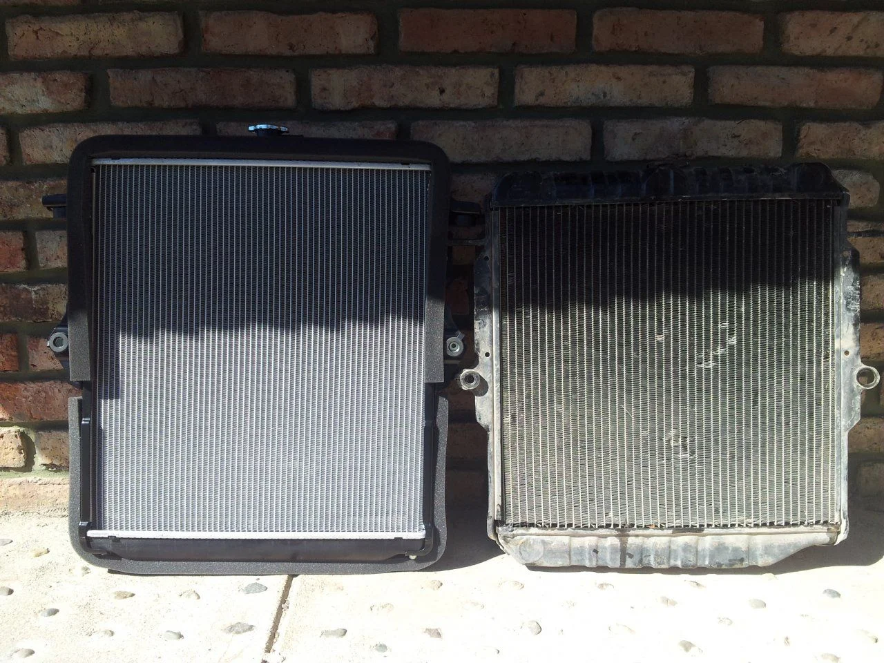

My old HZJ75 4 row brass radiator vs. the new one. Tanks are less tall on new one but the whole radiator is about 6cm taller.

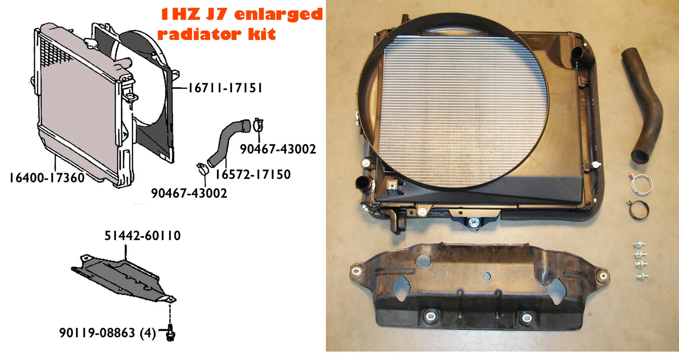

This picture they sent me. It's the standart HZJ78 vs. their taller radiator:
That's how the old ribs looked like on my brass radiator:
And this are the new ones. Very fine!

This should be the fan shroud PN that matches the larger radiator: 1671117151 it's available from Partsouq:
You will also need a different lower radiator hose for the larger radiator, also available from PS:
